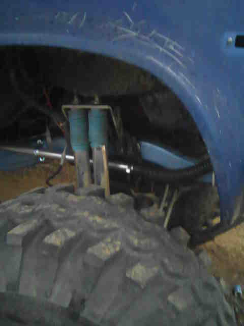

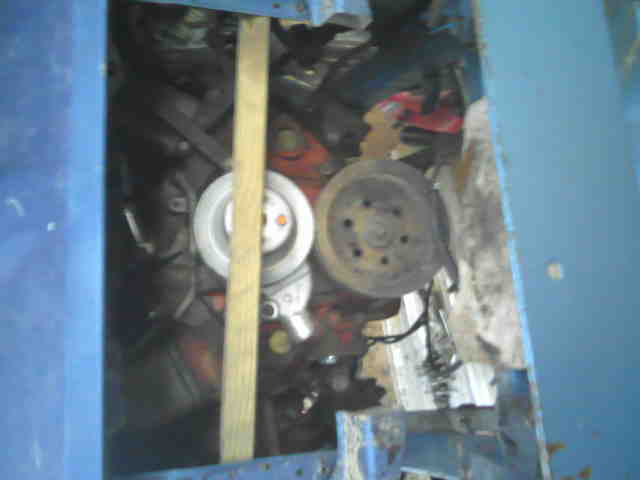

well i got the engine in and all but there is literally no room for the radiator so she goes in the back. what do some of yall think about routing? was thinking sch40 pvc then rubbers?

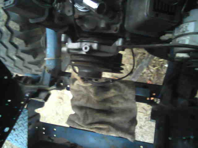

well i put the radiator in the back of the bed used exhaust tubing. but since the bed lifts up i needed to run a "flex line" rated at 200* got it to 210 on sunday(with the fans off) ran it for 2 hours no problems!!!! for some of u doing research for your rig dont use PVC, trust me!! next is new bearings/brakes front axle,and new exhaust!!!

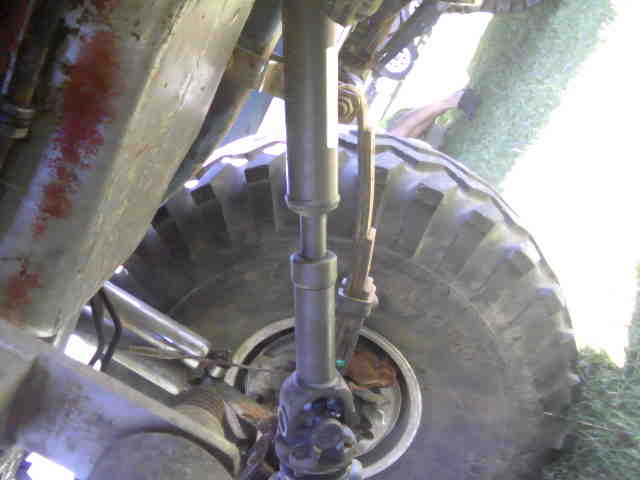

hello all been running the truck pretty good! but every time i get good nice traction i will snap a the u joint caps (twice so far) so if i bought a flange to go to the 205 that will bolt to my old yota shaft would it hold up better? the 205 clips holding the u joint in just seems so weak????

we got the front shaft in, the new rear 205 yoke, and we need fire ext to run. we ran last night gave it hell until the 4 day old front drive shaft gave out???
