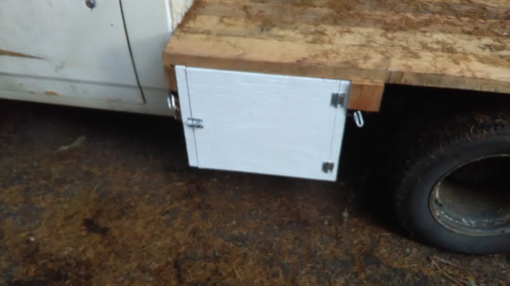

Well over the long weekend I did some more work on the truck. I pulled the fuel cut solenoid and the o-ring on the end was half-gone. I went ahead and removed it (the o-ring) for the time being. I don't hear any click when the key is turned so my next step will be to dig into the wiring (probably ground/ ign + to eliminate any issues). I also found a vac leak at the carb base so I'm putting in a new gasket there next. I'm having trouble with the desmogging trying to figure out what to remove and what stays. Makes it harder that my truck has A/C which adds a few other things for idle up. I'm thinking at this point it may be best to keep the smog until I can go with a weber.
Old Sep 11, 2016 | 08:36 PM
rowdy235's Avatar
Joined: Sep 2007
Posts: 1,803
From: Sweet Home, OR
Made some good progress over the weekend. I replaced the carb base gasket and got that leak solved. I went ahead and replaced all the vacuum hoses (well at least the ones I was keeping). Actually found another sizable leak on the brake booster hose (dryrot mainly). I removed all of the smog except the EGR (hooked up according to vac diagram for federal emissions) and the Charcoal Canister. Added a new PCV valve with a new grommet and hose to boot. Then I went around and plugged all the unused vacuum ports. If nothing else it looks much, much nicer and easier to work under the hood. I then started up and went to tuning. I got it idling fairly well around 800-900 rpm. However, it still is a little choppy. I'm going to try running the fresh fuel with seafoam in it through and see if that makes any difference once I have a tank ran through. For now its running plenty good enough to drive.
One issue I do have is dieseling. It diesels very badly after being driven for even a short amount of time. I'm going to replace the o-ring (currently removed) on the fuel cut solenoid and make sure its working properly (will rewire if I need to) in hopes that that will solve my problem. Another minor issue is popping in the exhaust when decelerating in gear. My 82 always did this and I never worried about it, but this truck just starting doing it recently. Any ideas?
Just so I can say I did something noticeable, we put the flatbed on this weekend too. Came out pretty nice I think

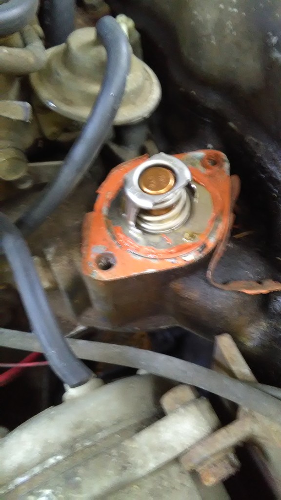

Well not too much to report over the last few weeks. Truck has been running better and better, but of course a couple quirks have come up. I've noticed especially when the weather is cold once in a while the truck will sometimes cool down after warming up. (The temp gauge only gets up to the mark above the C to begin with, but I think thats a gauge issue). I decided to replace the t-stat in hopes that was the issue. I think what I found should speak for itself:
Yeah.. needless to say new t-stat installed (the right way) with a new gasket. Now warms up and stays warmed up. I also now have better heat, the only trouble is the cable is seized so the only way to adjust is to reach under the dash with needle nose. Of course here in the PNW we need the heat (or at least defrost) 9 months out of the year, and if it gets too hot I can just crack a window. So not really high on my priority list.

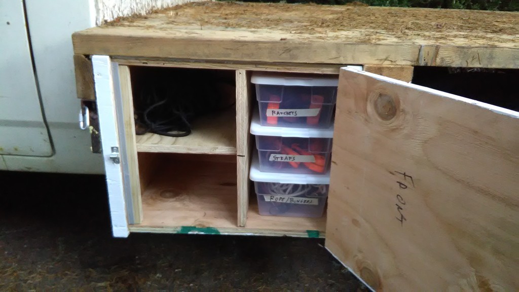

In case anybody didn't catch it in my buildup thread I made a couple plywood boxes to sit under the front of the flatbed add some storage. I think they turned out very nice
