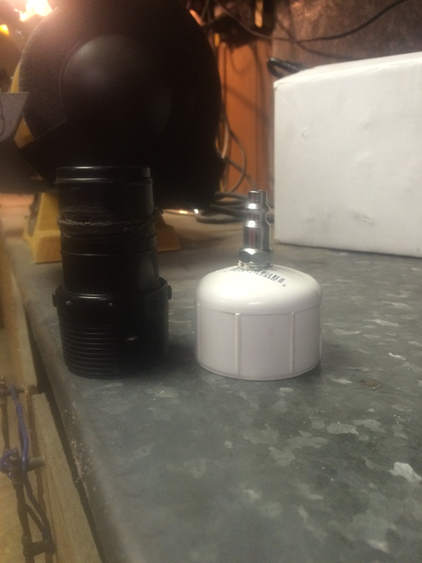

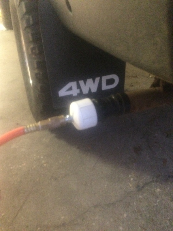

What I did was find a female threaded 1.5" pvc cap and a male threaded unidentified adapter (I think it was part of a pool hose that adapts a rubber hose to threaded pvc). I used a 7/16 drill bit to make a hole in the top of the cap, filed it out just a little more and then threaded in a 1/4" male air tool fitting that would hook up to my shop air. I pushed the black fitting into the tail pipe and found it just a hair too small to seal off well so I added a little electrical tape to it and it fit real tight. I wrapped the outside of the joint with a little more tape just to hold it all together and then threaded on my cap with air fitting.

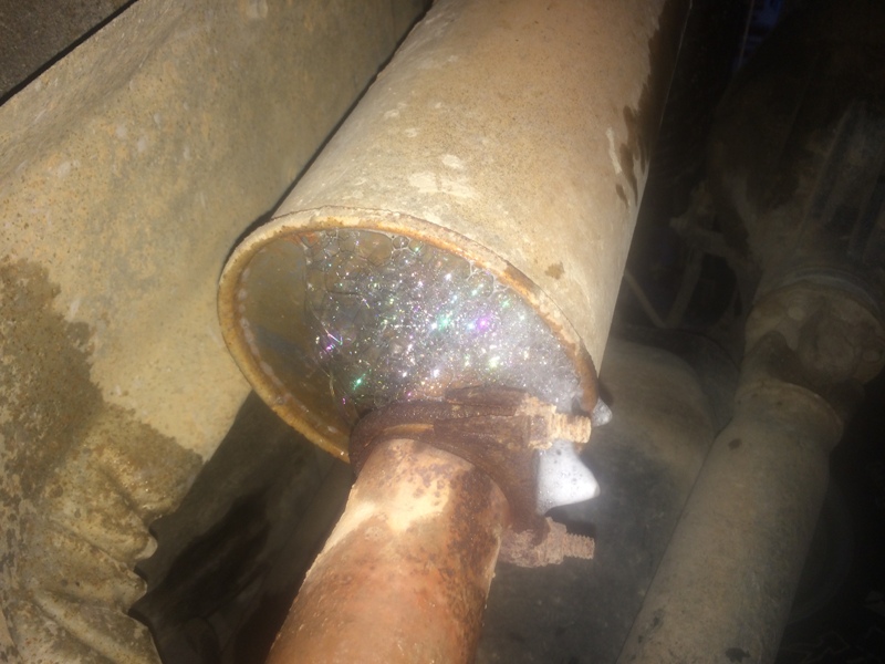

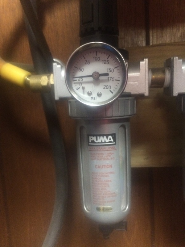

I turned down my air regulator to about 25 psi. (I didn't want to put 100 + pounds into the system and potentially cause another leak.) Next I got my flashlight and a spray bottle of my kid's bubble liquid (can use any type of liquid that will make bubbles at an air leak but the bubbles work awesome). When I hooked the air line to my test fitting I could hear the air fill the system for about one second and then could hear the hiss of an air leak. Crawled under the truck and started to spray the exhaust and when I got to the inlet of the muffler I didn't even need the bubble solution to identify my leak. Sprayed it down and there bubbles everywhere. It was a really bad leak but I had never been able to track it down before without the back pressure.
I sprayed down the rest of the system and didn't find any other leaks. I'm thinking about upping the pressure a little and testing it again but I'm not sure what the maximum pressure threshold should be on a test like this. If anyone has an opinion on this I'd like to hear it.
