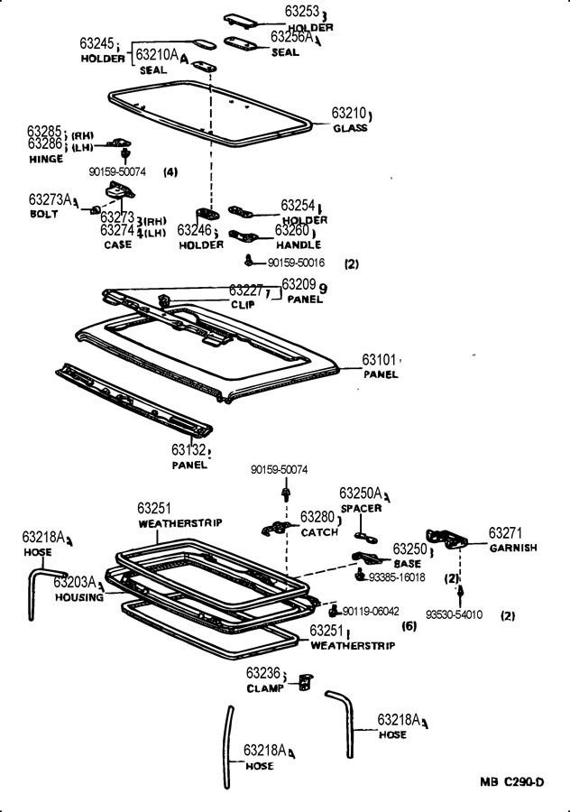

Give this a try & have a look at the diagram. Maybe you can find what you need here.

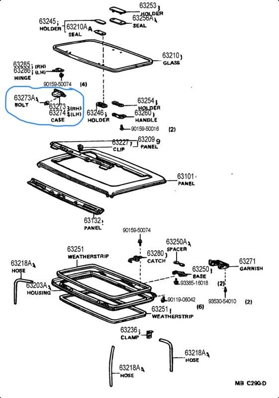

I think I am looking for Part Number 63273-17040 and 63274-17040. But if anyone can take a picture of that area of the roof, just to confirm this is the part I need, that will be great. I tried searching the part number in a google search and couldn't find a real photo, only the drawing.
I think this is the stopper but not 100% sure. Hopefully someone can send me a photo of this area of the roof.

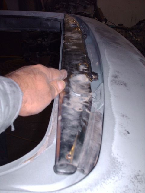

your wanting the deflector clips ? .. I had to make mine .. the plastic part comes on the deflector

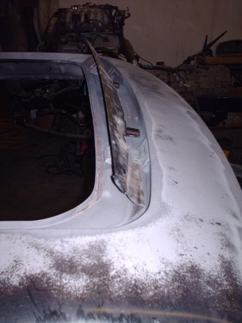

Here is my brother truck and the area where it does not have that hinge.
This is what holds the glass down and not move back as much.
Where is this piece located in the image below?

#63209 in that diagram " clip" #63227 is what the deflector hooks to so it folds out of place when the glass is removed or up

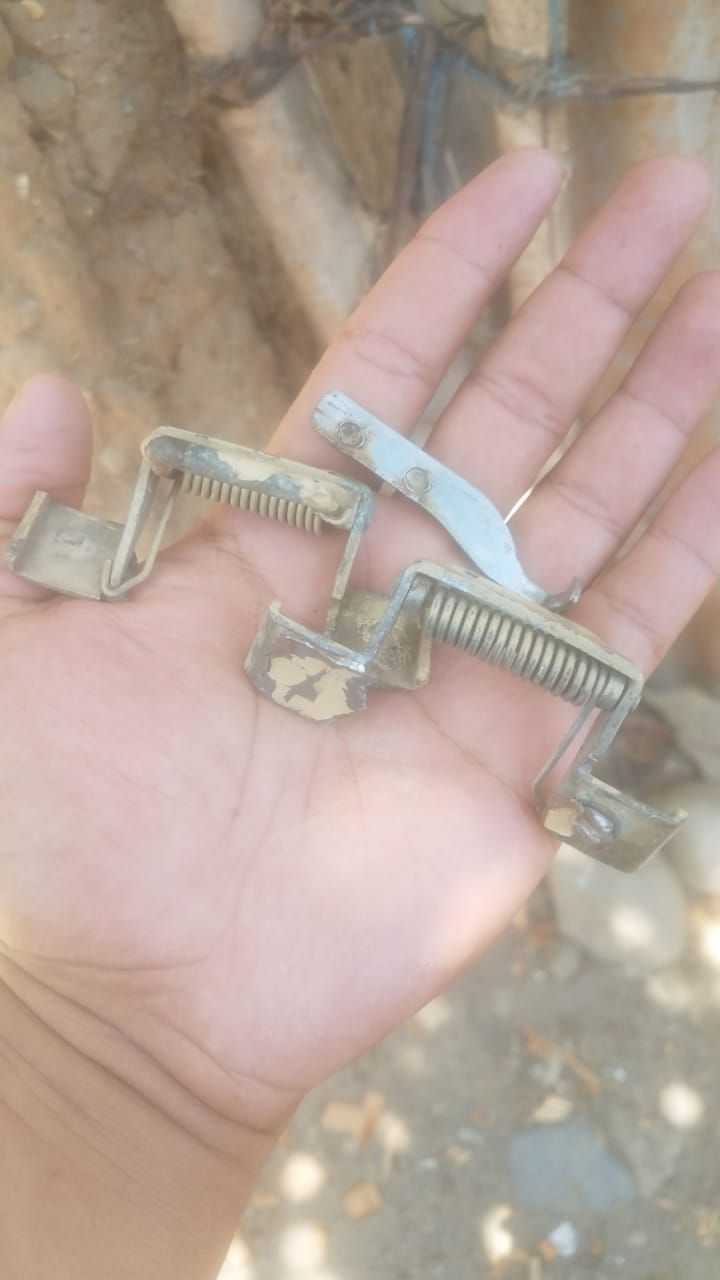

Thanks Slacker, for your help. I was able to find the 2 clips in the garage. The person who sold the roof assembly accidentally ripped off those clips when he removed it from the salvage truck. Luckily we were able to find them with your photos.

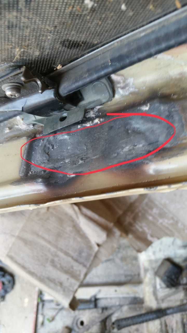

We also found this other piece that is part of the roof assembly, but neither the seller and I know where it goes. The seller says it is part of the roof, but doesn't remember where it goes. Does your truck roof have a pick-like piece on it?
I circled it in the picture.
Found the clips
This pick-like piece is what we are now stuck on.
Here is the roof assembly as of right now. The clips and pick-like piece seems to be welded or riveted to the roof. That is why there are new sheet metal welded to the roof.
