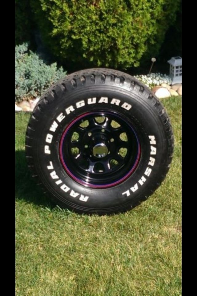

Thanks for the info ! I ended up getting 31/9.5/15. Daytona rims on marshal radial power guard. $300 for a set of 4

Old Mar 3, 2015 | 05:41 PM
cjskeen14's Avatar
Joined: Feb 2015
Posts: 30
Old Mar 4, 2015 | 05:34 AM
83's Avatar
83
Joined: May 2008
Posts: 4,591
Likes: 126
From: Montana
Nice.
I had the same rims on my 83.
Old Mar 4, 2015 | 08:40 AM
muddpigg's Avatar
Joined: Mar 2007
Posts: 4,374
Likes: 37
From: Enterprise, AL
Looks good!!!
Old Mar 11, 2015 | 11:35 AM
ConSeann3ry's Avatar
Joined: Nov 2010
Posts: 105
From: Portland, OR
I had those too. I wanted them all in black so I took some sort of solvent (cement cleaner?) and put it on a rag and they rubbed right off.

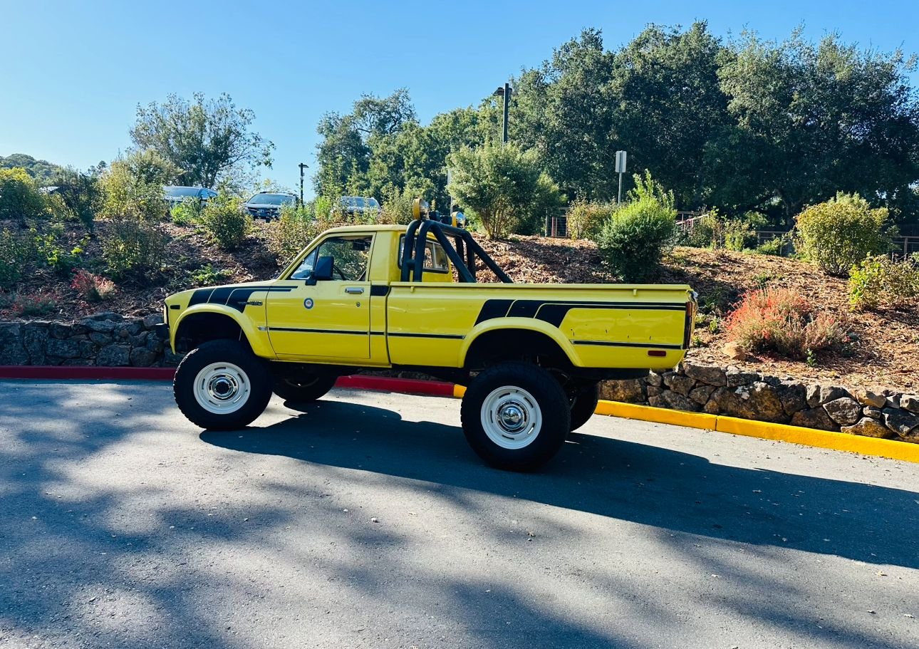

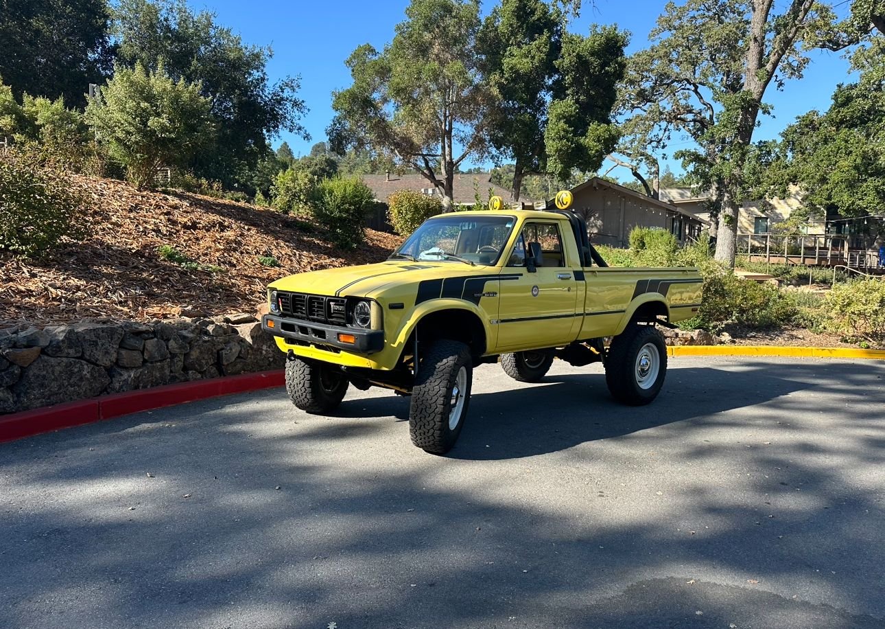

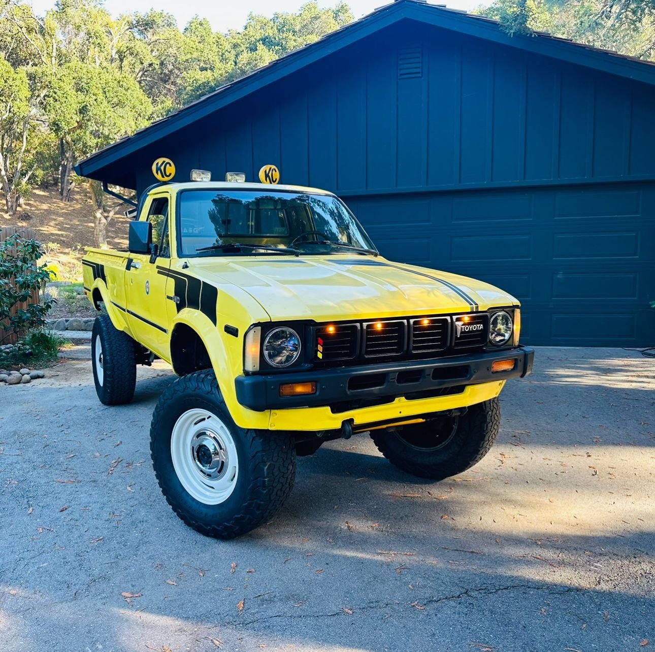

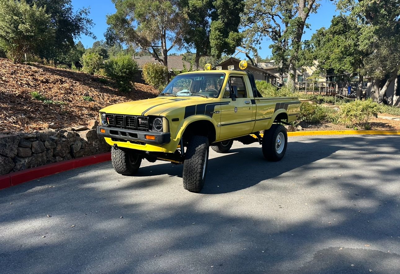

Running BFG All Terrain 33’s with a 3 inch lift
Originally Posted by cjskeen14
Hey what's the biggest tires I can run on a stock 1982 toyota pickup, single cab? Flat deck. I have 31s in it right now but when would I start needing a lift?
Old Oct 30, 2023 | 08:42 AM
22R Tonka's Avatar
Joined: Oct 2023
Posts: 3
[QUOTE=22R Tonka;52490178]
17-inch wheels, BFG All Terrains, 3-inch lift. No issues at highway speeds. Would like to run BFG KM3 37’s but would need to regear
