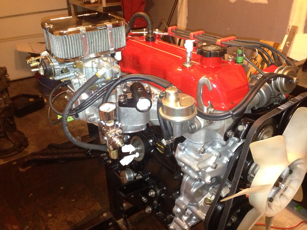

Fuel pump relay? Most 20R engines would typically have a mechanical fuel pump unless somebody switched it over to a electric fuel pump at some point. If it indeed has a mechanical fuel pump and your mechanic "replaced the fuel pump relay" then you may have been duped. But it is possible to have a stock or aftermarket electric fuel pump - just letting you know just in case your mechanic is shady. If you have a mechanical fuel pump it would look like this - located to the left of the engine hook in the picture below:

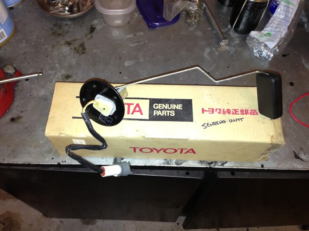

As for your fuel gauge issue, your fuel sending unit is probably seized up a little and won't drop or gets stuck when it nears a 1/2 tank. Mine wouldn't read anything at all on the cluster because it was corroded enough that the float wouldn't move in the tank. I pulled the sending unit, wire brushed the corrosion off, re-installed and it worked perfectly. I later ended up buying a replacement New-Old Stock sending unit that I found after about 2 years of search regularly (I was reeeeeally lucky and paid dearly for it so don't expect to find a new one like I did without a lot of patience).

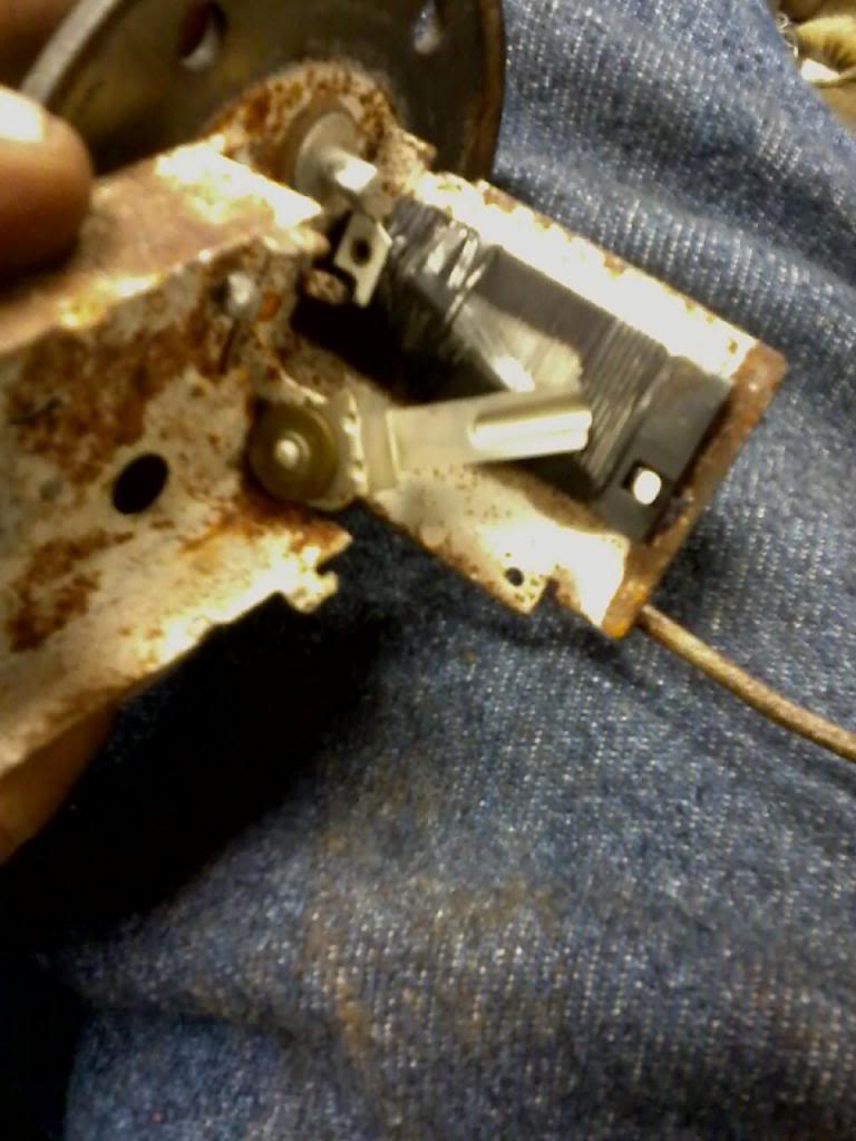

The light sockets get really corroded inside the bulb holders. A good cleaning on the terminals and the socket that the bulb sits in sometimes will fix that.
The fuel float assembly can get rust build up on the pivot point and not let it operate like it should. A brass brush and some PB Blaster can get it operating like it should. Inside the box of the float, there is a potentiometer like mechanism that is made of fine wire, not much bigger then a hair. Once the wiper inside wears thru the wire, about the only option is to replace the float assembly.
