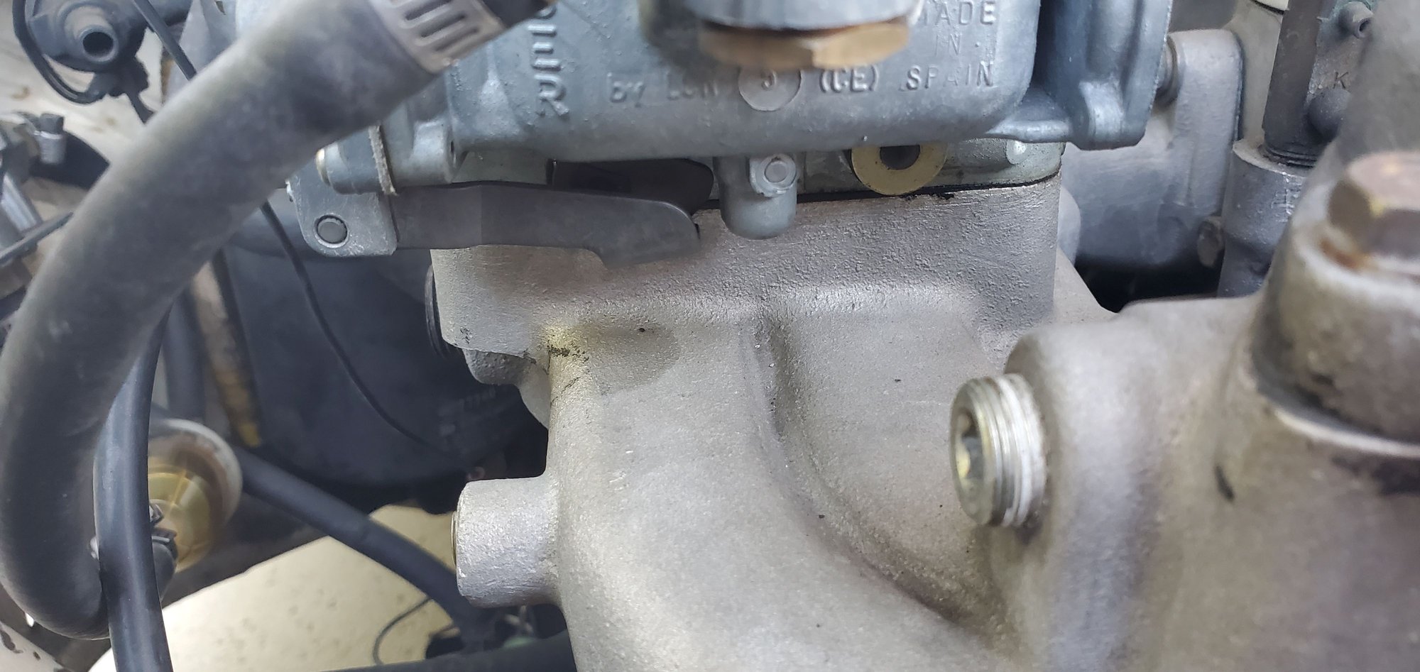

Those are two good points about flooding. I do have to floor the gas peddle to start it. The longer I wait between running and re-starting the better it starts, maybe also cause the truck cools down. I have the kit and Im going to tear into it this weekend. As far as spacer go I do have one but the instructions do not mention anything about that for this truck. Im running an electric fuel pump, I also have a fuel pressure regulator installed, running 3bar, Which is the recommended pressure for this carb. Once I open the carb this weekend im going to take tons of pics, I don't know what Im going to find the carb is 6 years old, some gaskets are leaking there is a stain on the intake manifold form the gas leak. As you can see in these pics.

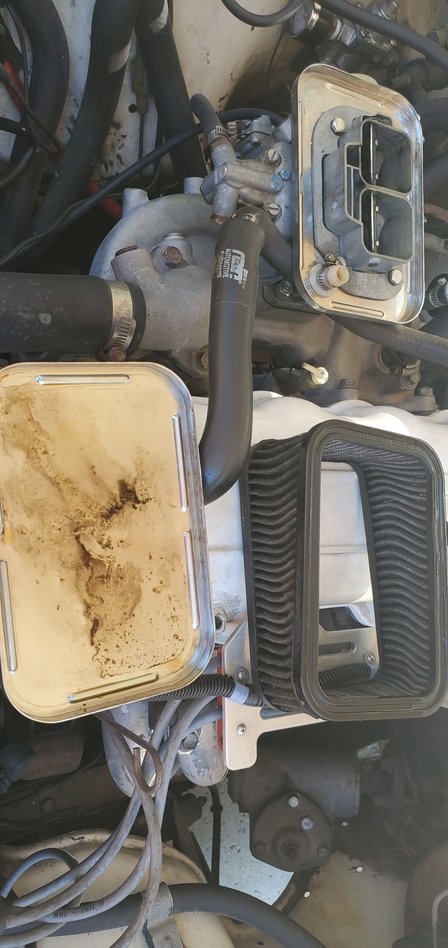

So I was some what successful today. Tore into the carburetor today. Did not see anything that was out of the ordinary. The float had a lot of play the needle and seat position. Other then that the carb looked in good order not a lot carbon build up. The only thing that raised questions was the back splash on the top of the carburetor cover.
Oil and gas mixture sprayed on the top. This is odd to me.

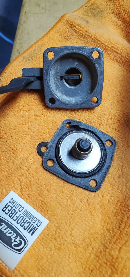

I was able to change the gasket on the accelerator pump diaphragm, this was leaking. I did notice some dirt and corrosion on the inside. Clean it up before re-installing.

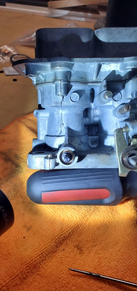

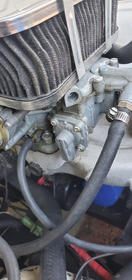

I was not able to change the other piece that was leaking. On the secondary shaft there is a shaft retaining bushing. That was not part of the rebuild kit, actually the kit is quite light on parts and the paper gaskets do not match the well on the carb, very disappointing. I just tightened the fixing nut really tight. Here is a picture of the actual secondary shaft retaining bushing. This was leaking really bad, I dont think tightening the fixing nut would fix the problem. I will keep on eye on it for the next few days see what happens.
This is how far I got so far. Still dont know why it starts hard when hot, and why it wants stall when applying the breaks.
