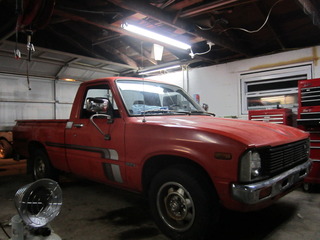

Just thought I would post a pic of the truck.

Welcome! Great looking truck. Seems as if you're off to a good start.

looks really good! and yeah, a 2rz swap, like dropzone said, seems to be a great way to add some power easily. and if you do it right, you can do it for fairly cheap.
