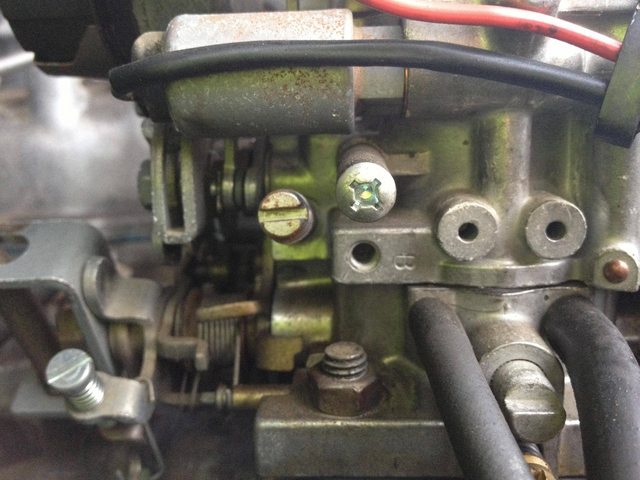

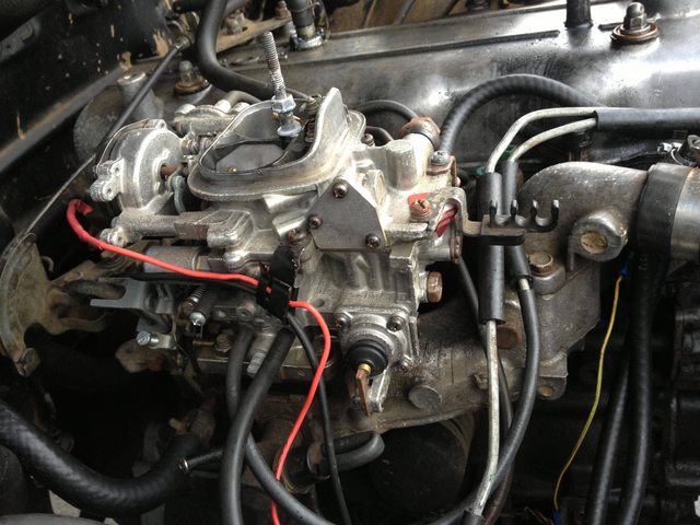

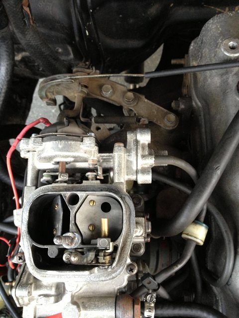

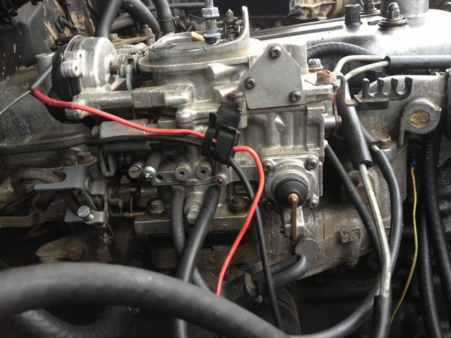

What kind of carb?? Pictures help in case you have something missing or hooked up wrong. When a vehicle has lived for 30 years with several different owners, you never know what kinds of stupid things they did to it.
Ok, I am fairly certain it is an aisan carb, I had the previous owners receipt but cannot find it at the moment. I tinkered with it a little today, I found one adjusting screw on the passengers side close to the throttle I assume is the idle mixture, I brought my idle up a bit from 600 to 800 after letting it run for 15 minutes or so.

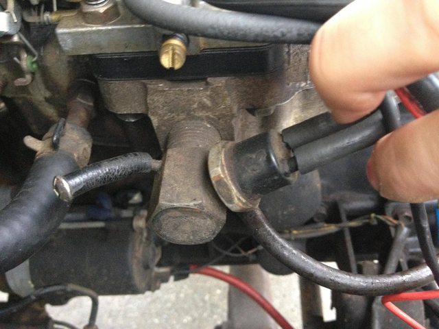

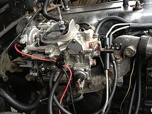

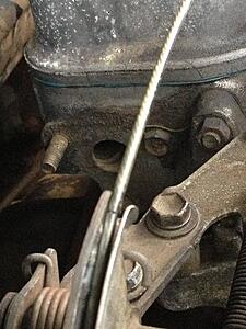

Ok just went out and took some pictures,
I also found this link http://www.bluebassdesign.com/boonin/carb_faq/#angles which actually has a lot of good info so far. As far as i can tell there should be a plate over where the egr was, correct? and the assembly at the bottom of the carb with just a vacuum hose connecting the two ports is part of the accelerator circuit.

What a mess! There definitely needs to be a plate over that massive hole you have in your head where the EGR used to go.
Are you going the desmogged route or do you need to pass emissions in your state? This appears to be a poor attempt at desmogging that you inheritted.

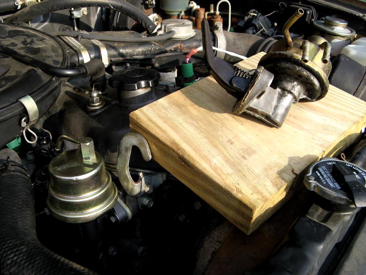

I wonder if it is a simple fuel delivery issue...I mean, you mention going up the hill, and it craps out when you are pushing it. Fuel pump? Float bowl adjustment. Could be that simple. Cheaper if it gets it going until you have dough for upgrades. Fuel pump is actually cheap (like under $30). Float bowl adjustment is free if it just needs adjustment on the float. Fuel filter is back by the tank under the wheel well. There is a chance it is that thing too.
Mechanical pump on the engine right?
PO put in a new fuel tank, re lined the whole truck and put in 2 aftermarket "extra" filters up near the firewall just because he was paranoid about running bad fuel through his new carb I guess.
Both of those filters are fairly new and seem clean, I will take them off tomorrow and blow through them make sure they are not restricted.
Right in front of the carburetor
I had a bad pump, and thought it was an electrical problem for a month or more!
