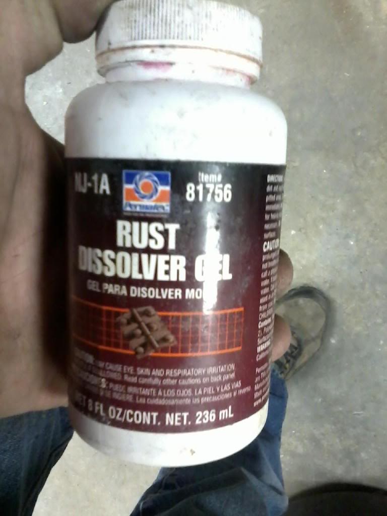

Here is how I cleaned/fixed mine. Just need to get the pivot point area cleaned up.
The other day I was working on getting my fuel level sending unit freed up. I use a rust dissolver on it and a wire tooth brush. It moves freely now.
This stuff works great.
