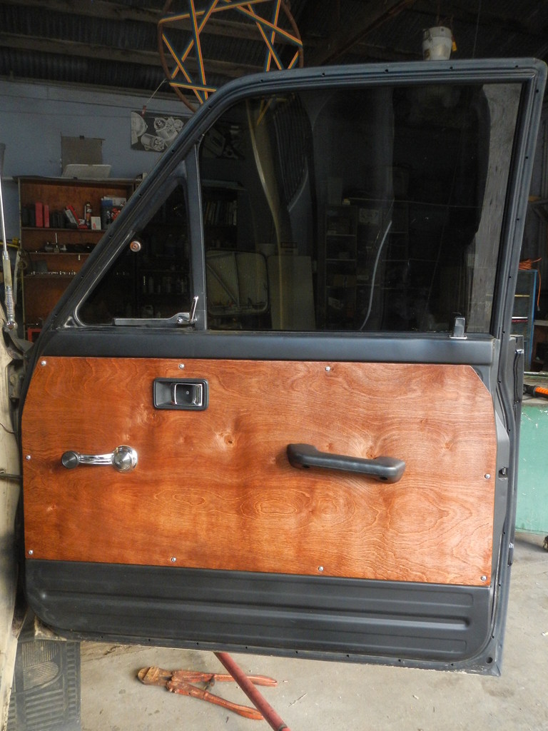

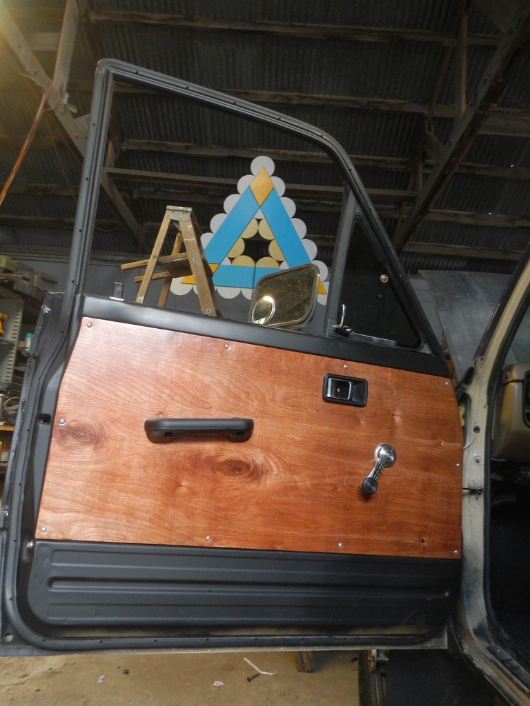

Check out my High-lux doorpanels!
I'm halfway through my black interior conversion. There's a lot of beige remaining, but the doors are done (for Stage 1, anyway). With all the burly diamondplate and blank plastic door cards I've seen on YT, I know this won't be everyone's cup of tea, but maybe someone'll like it. I like it, anyway.
I had my windows tinted, for which I removed the door glass and then reinstalled it with a bunch of silicone in all the gaps. I also replaced the inner horizontal weatherstripping along the windows, and bent the sheetmetal such that the rubber presses more against the glass. There's a lot less whistling on the highway now.

Awesome to see something different for a change, and looks like a very clean custom install.

Looks very nice, I like them.

That's classy, looks good. Warms up the cold steel. Certainly more creative and prettier than vinyl.

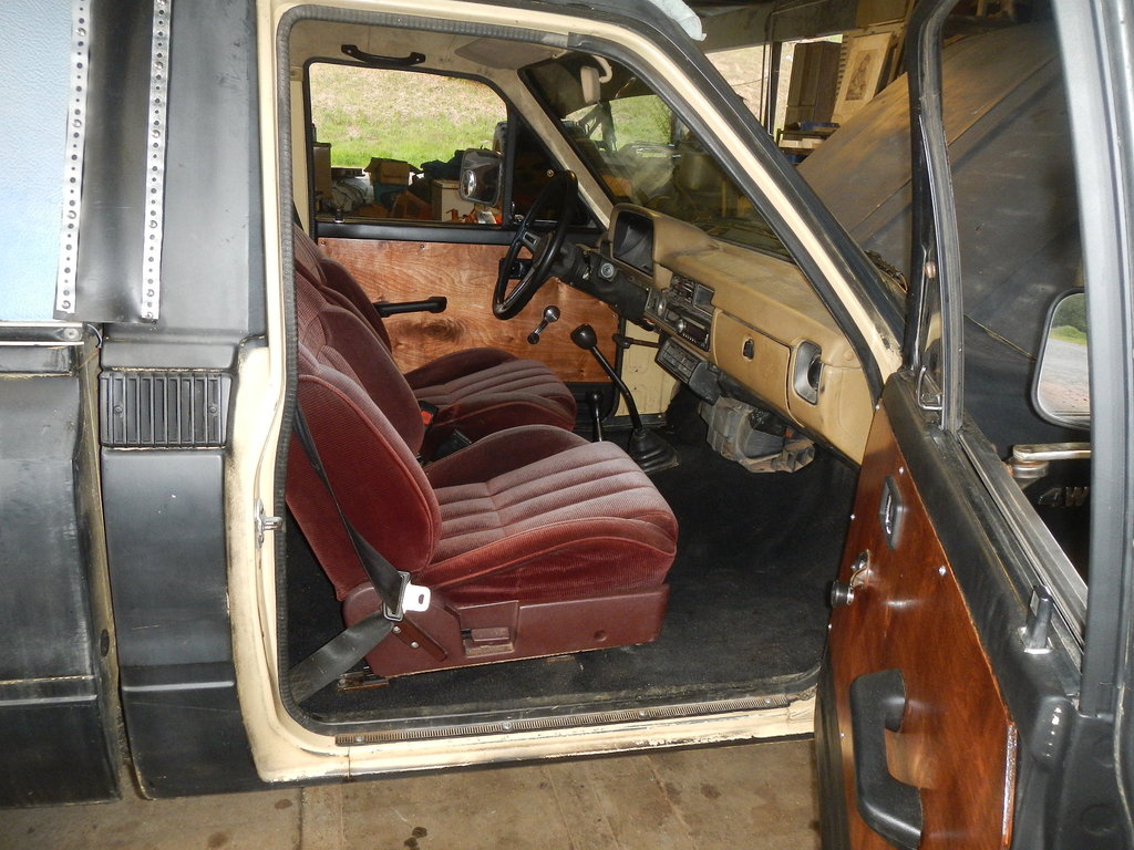

Edit, what are those seats out of? Were they a pretty easy install? Sometimes seat changes can be a real PITA. Been looking for something to retrofit into mine for nicer long drives.

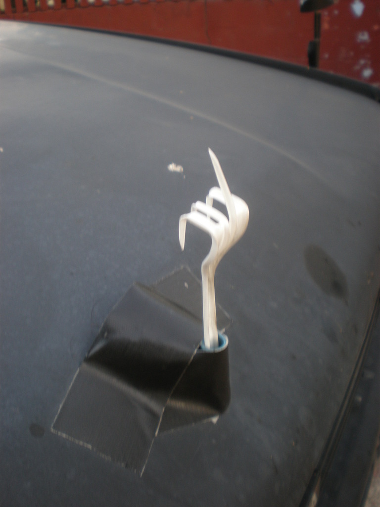

Also witness the chrome door handles (out of a 70's Corolla, but some Camrys had them too) and window cranks (out of an 80's GM sedan). As for wheels, I'm rocking factory original steelies, except painted flat black. On a previous ride, my hood ornament used to be a plastic fork with tines 1, 3, and 4 bent down (you figure it out).
I wanted something pretty but relatively durable. These are easy to clean and take a beating - three coats of satin polyurethane, 3/16" plywood. I'm also coming to enjoy the five-different-shades-of-rattlecan-black on the outside, posh-on-the-inside esthetic. Some say project cars are like pets in that they eventually resemble the owner. There's certainly analogies there.
The seats are out of a second-to-last-gen Cressida. They were not plug-n-play at all; I had to remove their rails, make a plywood adapter plate for SR5 bucket rails, and for the driver's seat to be centered I had to slot out the holes in the bucket rails and shift it inwards about 1cm. I just completed a 1100-mile drive lasting three days, and for me they are tied for first place in seat comfort, along with seats from an 89-95 BMW 5-series like you see below (88-94 7'ers too). Not much adjustment room, however; if I were any taller I'd want something else. For comfort on long drives, the rest of the truck leaves much to be desired; these make it bearable. Headrests are out of an early 90's Celica (I've tried about 7 different headrests out of 80's and 90's Toyotas, and they all have compatible posts).

Thanks for the info. I found a Ford Windstar seat, second-gen era, is almost a drop-in replacement. The stock seats are so crappy almost anything is an upgrade. I don't know how the same era 3-series seats compare with the 5, but those are quite nice as well. The search continues...
PS, you should actually make a fork hood ornament as you state. If I saw that I'd probably wreck I'd be laughing so hard. I'm only jealous because it wasn't my idea!

I've only briefly sat in any 3 series, and I'd say the seats on the non-sport models are at least 90% as comfortable as the 5-series. That goes for the E30 (85-92ish) and E36 (92ish-99), though the latter had inferior materials quality.
Hood ornament? Been there, done that:
