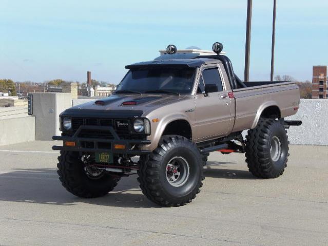

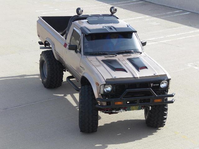

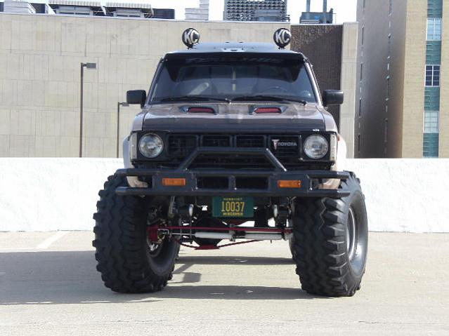

Pics of my 83 with a 79 front end
This is my 3 yr build. Replaced all seals and gaskets, tar and foamed the frame, added 40 inch Monster Mudders to a 4 in Skyjacker lift and 2 in Body lift, with Flowmaster 50 series attatched to a custom exhaust. Custom fabricated ladder bars and a Triple front stabilzer. Rebuildt 350 sm block chevy, bored .040 over, extreme cam, 650 edelbrock 4 brl carb, HEI ignition, custom interior, Kenwood stereo cd system.

those tires//.... either not too much of a daily driver, or do you have the
constant bee hive humm in your ears yet?

Hmmmmmmmmmmmmmmmmm!!!I love that sound!!!!

having that 350 would be sweet, but with your wheel offset it looks like your tires rub at full lock to lock on the springs....how's your turning radius?
overall a sweet truck
and go with high steer and an IFS box to get rid of that push pull steering...it will be a lot better

HOLY FENDERS!!!! how did you fit 40's with only six inches??????????

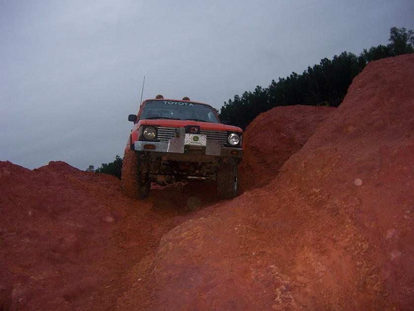

man theres a lot of awesome yotas on here but heres a few pics of my 79.

Bolt um on and not be afraid to run big tires

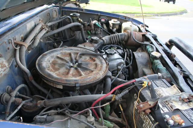

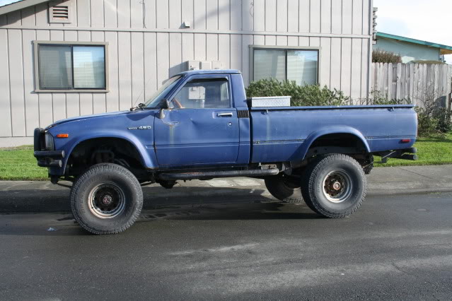

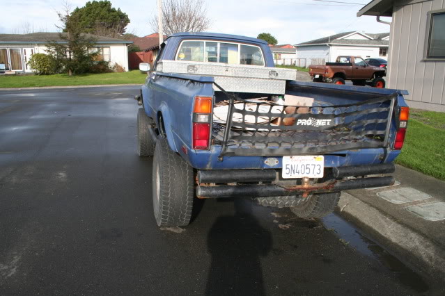

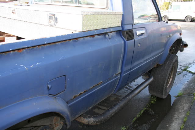

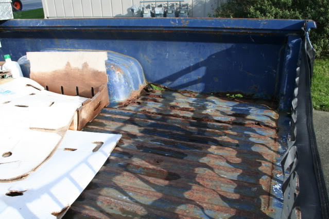

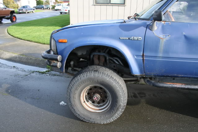

I figure I can get more advice if I post this rig here..
I am thinking about buying this rig but it needs a ton of work.. timing chain and timing chain cover. The timing chain wore a hole in the cover and leaked coolant into the system, waterpump, clutch, radiator, tons of bodywork. Front axle needs a rebuild (seals, bearings etc.) and a few other minor things. I put an LC header in it and did a full tune up recently.
This is a good friend of mines rig and I want the deal to be fair. He is thinking $1000.00 for it and I thought I would post up some pics and see what TY thinks.
thanks!

Well since you're not back east or in the midwest I think you can find better in California. The Bay area (if it isn't too far) or especially So-cal can yeild better quality trucks.Especially since this truck doesn't seem to have many redeeming qualities..Doesn't run well?, interior/exterior is in bad condition..For me I'll spend a little more for well running rust free, all body panels attached pickup, yes they're still out there..good luck

wait for a better truck; that one is going to rust on you fast, unless you go buy about 10 cans of rustoleum, and go to town.
