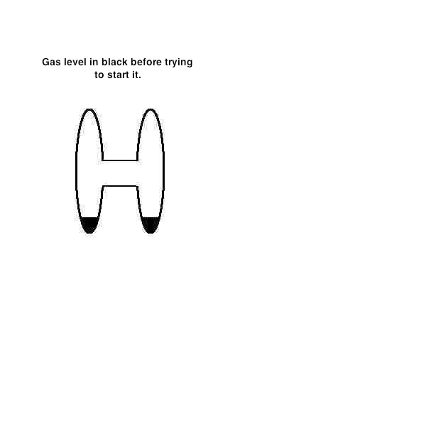

Here is the latest...
Before trying to start it I looked at the sight glass and could see gas at the bottom of it. After trying to start it with starting fluid sprayed into the carb side only and pumping it 3 to 4 times quickly and then hitting the ignition the gas was up high in the sight glass but it still won't start. See the funky images below.
I don't have anyone around to turn the ignition while I check for spark but I'm sure its getting spark because it started right up a week ago after spraying starter fluid. The gas tank was low when I bought this last week and had been sitting a for while so I'm thinking in the short time I spent driving it to my home and trying to start it after that that some crap at the bottom of the gas tank went into the carb. (I added 2 gallons of new gas but that was after many attempts of trying to start it.)
I'm thinking its a carburator issue. What do you think about rebuilding the carburator? I can buy a kit on eBay for only $20.

Glad you're still here and not electrocuted...
Rebuilding a carb is almost never a bad idea on a vehicle this old. I'd go to Napa. There should be a metal tag, somewhere on your carb, with a number/model. You need that. There were a lot of variations throughout the years and what I've always heard (could be wrong!) is that if someone is selling a "22R carb rebuild kit", one size fits all, RUN.
There are a lot of variations. So...see if you can find that tag. I remember threads a while back on where to find it (probably back when I was having carb issues), but I don't remember now, because mine didn't have a tag, so it didn't stick in my memory. Hopefully yours does have a tag.
Alternatively, you can try to find a used carb in better shape, or have someone local rebuild it. I sent mine in to a place...I can find out who if you care. It was under $200, from what I remember, and you don't need to mess around too much with trying to tune it.
Don't let it discourage you, but carbs have a lot of little pieces to keep track of, and take a lot of fine-tuning to get right. But if you do it, you'll have a skill not too many of us have, even those who tinker with their trucks quite a bit. Something about the carb is just really frustrating...

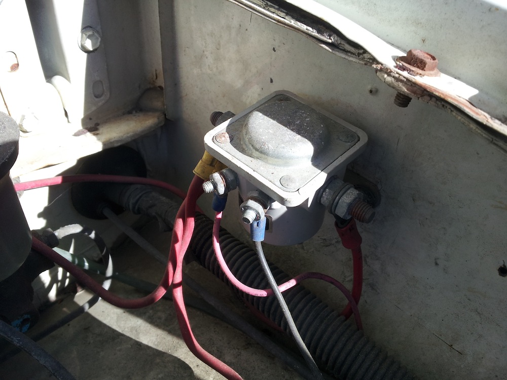

[quote=magentawave;52025192]. At one point he installed a solenoid (see attached photo) that is located inside of the drivers side fender.
Whats the deal with that solenoid? I wounder if that is the issue. Sounds like the thing runs fine when it runs. Starting has gotten worse. How is that solenoid wired? Look at all the grounds, clean? Sounds like your getting fuel.
You could have sucked up some crap out of the tank, check your fuel filter. Is the new one have any color in it.
My 81 would flood time to time, starting fluid did nothing, I was getting fuel and spark. Had to let it sit for a while then it would start. Then I got mad and kept flooring the gas and cranking this blew it out and started. I ended up replacing the carb with a weber.
You need to check for spark, check that solenoid. let us know!

I missed the solenoid thing...I have no idea about that.

Yes it ran great last week once it started with lots of power and zero stalling or hesitation. Here is the other thing... I only had to keep my foot on the accelerator for maybe the first 30 seconds after starting cold and then it idled smoothly...and that was in cold weather and after not being started for several weeks prior to that.
Yes there is a tag on the front of the carburator with numbers.
I don't know about the solenoid except that it was replaced about three years ago and rarely started after that. I'll check to see if there is junk in the fuel filter and poke at those solenoid connections tomorrow...and I'm going to hustle up a human to turn the key while I check spark.
I spoke to someone today that rebuilds carbs ($500 to rebuilt it - aaargh!) and he said to pull off the air filter housing and tap on some 1/2" round protruding thing above the sight glass with a hammer. He said if it starts after that then that means I need a new "needle and seat." He explained why but all I remember is that the needle might be getting stuck.
Two questions please...
1) What are the symptoms of a bad solenoid?
2) Dumb question but before I detach lots of stuff I don't need to, how do I remove the air filter housing (the bottom part)? There are the two bolts attaching it to the valve cover but what else is holding it in place?
