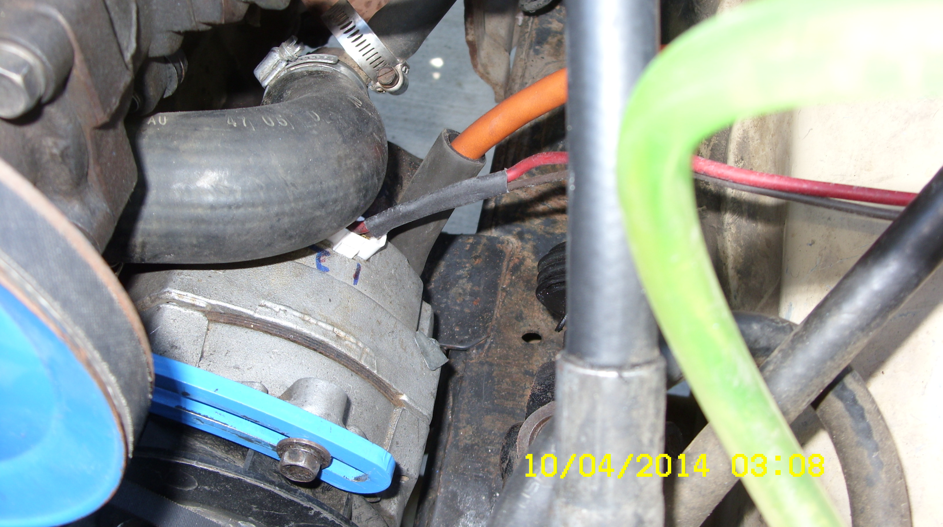

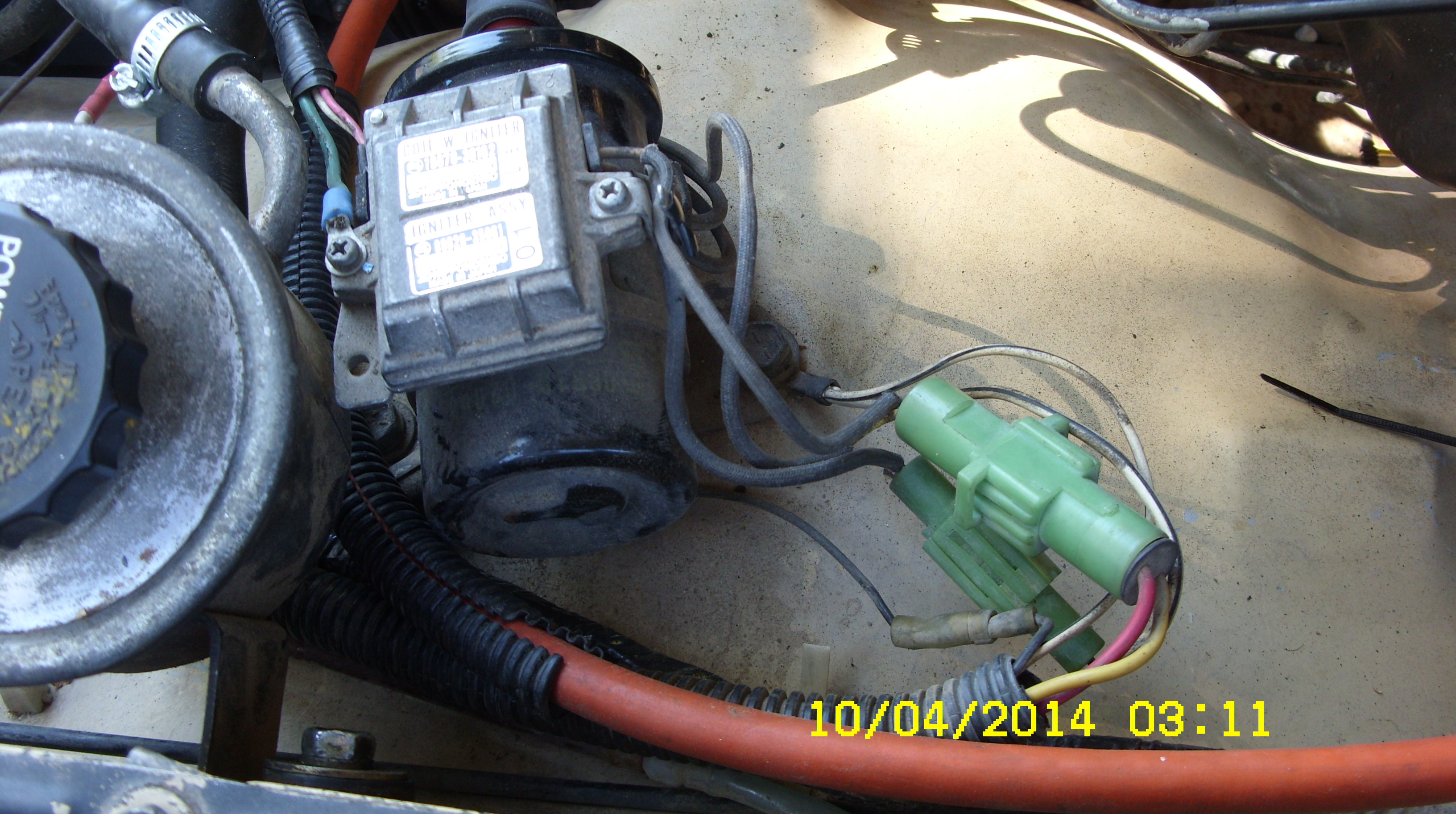

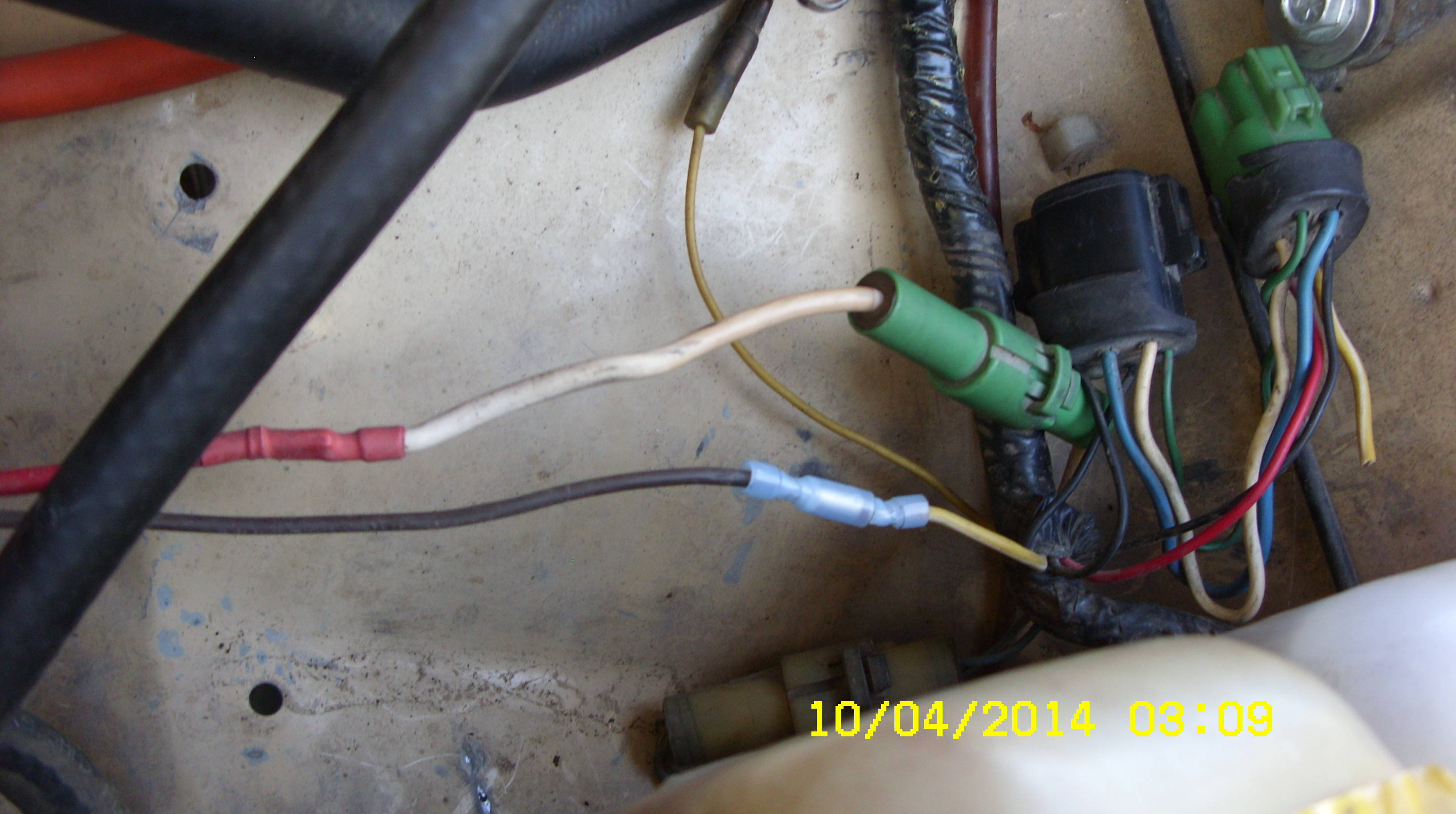

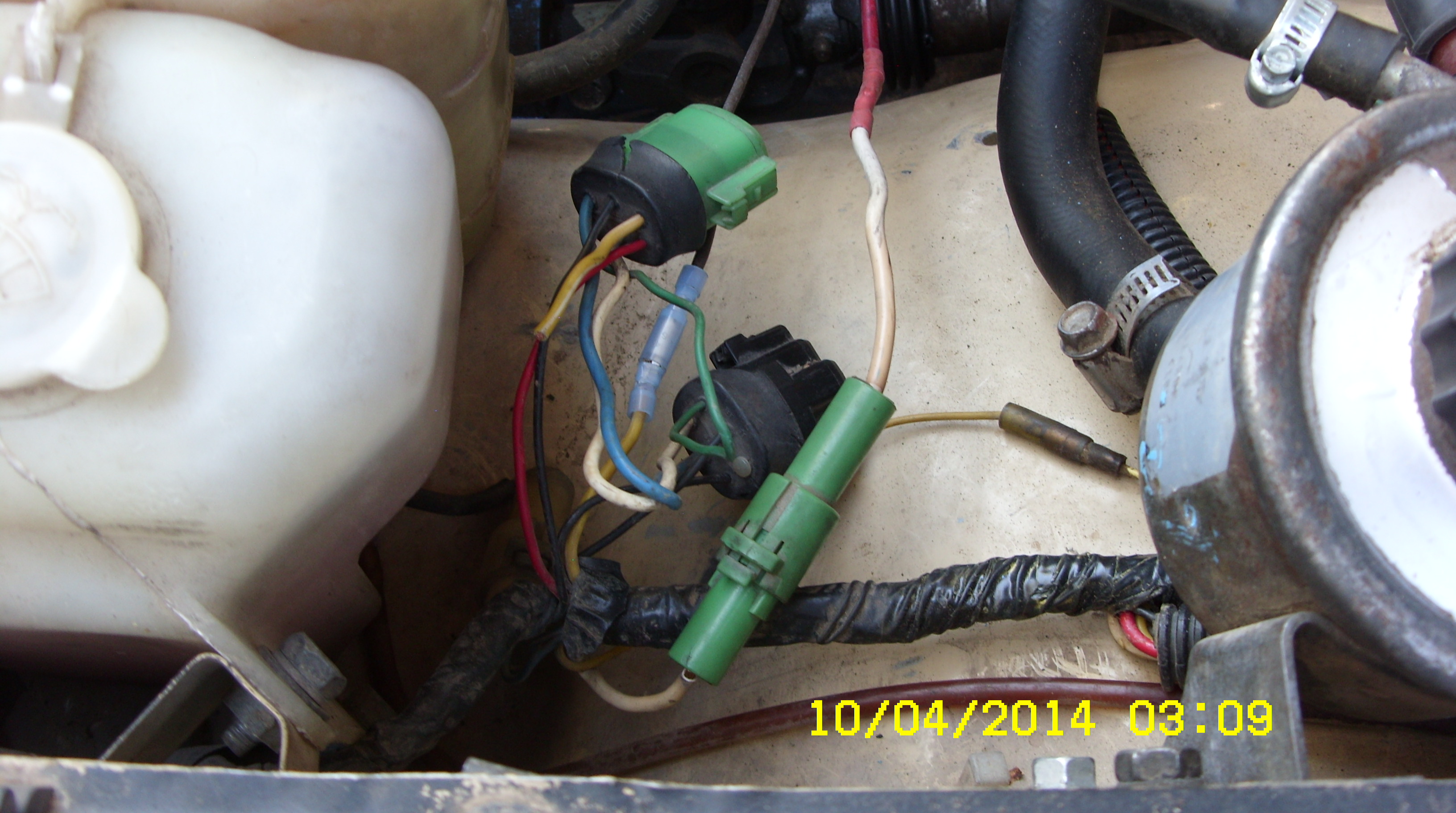

What I've done so far
Got one more to upload.
I won't insulated the wiring until I know it's all good.
!- the alternator in.
2- The #2 is on the stock large white thru the stock connector
3- You can see the red wire on the regulator plug that's powered with the key on
Attached Thumbnails GM alternator instal and now no spark-sn850393.jpg   GM alternator instal and now no spark-sn850394.jpg   GM alternator instal and now no spark-sn850395.jpg

The large white wire in the truck harness should be connected to "Bat" on the alt. The red wire that tied to the old voltage regulator will connect to the "excite" terminal of the alt. Do you have any diagrams that show what #1 and 2 mean on the alt? One should be the excite and the other is the charge light I would assume.

I connected the Bat. directly to the battery, the #2 to the Toy. large white and the #1 to the gen. light

1 is the excite wire that causes the alternator to start doing it's thing. This must be tied to the ignition switch wire and nothin else. On my 83 it was a red wire. 2 needs to hook up somewhere that is just power. This is where the alternator will read the system voltage and determine how to regulate itself to maintain ~14VDC. Bat needs to be wired to the battery using the large Toyota white wire. This is the charge wire to the battery.
The way you have 2 might be ok. How did you connect the bat? Run a new wire? I considered that your 1 is still wrong though.
