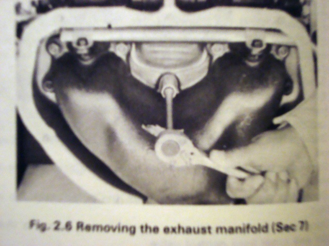

Two or three times I've replaced the fiberglass looking seal for the exhaust manifold heat shield tin. Its mostly gone again and making noise ratteling. Is there something better to use that will take the heat. I've been thinking to just leave it out and put short springs or something where the bolts are. Its a nuisance, but then wonder if a goody two shoes smog guy might nail me on that missing....

My question is about 2 piece Heat shield, think theres about 6-8 small bolts holding its cover on. It surrounds the largest mass of exhaust manifold. Maybe it wasn't on all models, I don't know?
Pic shows inner shield with about 3/4" wide flat gasket, cover is removed.

actually , its operation is that of a "stove pipe" . Toyota use to use these on the older corollas and corona models . it is for the colder climates and conditions and effectively draws warm air from the air pocket surrounding the exhaust manifold into the carburetor in cold weather on initial start and warm up .
unless your keeping your truck in "factory" condition , then I would just remove it . even if you are keeping it in factory condition , I would just remove it , but keep it , so if you ever sell it you have it .

Thats true, but I think maybe its dual purpose maybe not by design but chance? Not Cold in So. Cailf. I know the manifold is just a big open chamber on mine where I've seen the toyota cars of that era with seperate cast tubes more like a header, more efficent i'm sure. on mine the common cavity like in the pic, all 4 cylinders feed into becomes a heater, hotter gases into cat, less emissions, unless i'm missing something. I know they wont pass smog if the short hose from the tin to air cleaner snout is missing, at least the smog station required me to replace mine when it was screwed up?

IIRC you can pass CA emissions without the heat shield, but you cannot pass without the EGR hooked up.

Might depend on who you go to. I started going to the same test only, now its been 10 years so the guy knows me and I get a pass on small things sometimes like fuel seal or check engine light on another car. I'd ask him before removing the tin but its easier just keeping things right after finding the big problem that failed me and buying a cat two times in a row. Holes in the distributor vacuum advance diaphrams. I thought those lasted pretty much forever,

I've run remflex with header, has been best seal yet since '10 but truck sat in storage for 3 yrs.
As for manifold??? IDK. I'd would only be concerned about heat shield if emission inspectable.
this is correct , as far as I know ...
I have done doug thourly headers on some cali trucks .. no heat shield on the headers only EGR . and YES , the trucks DID have cats
