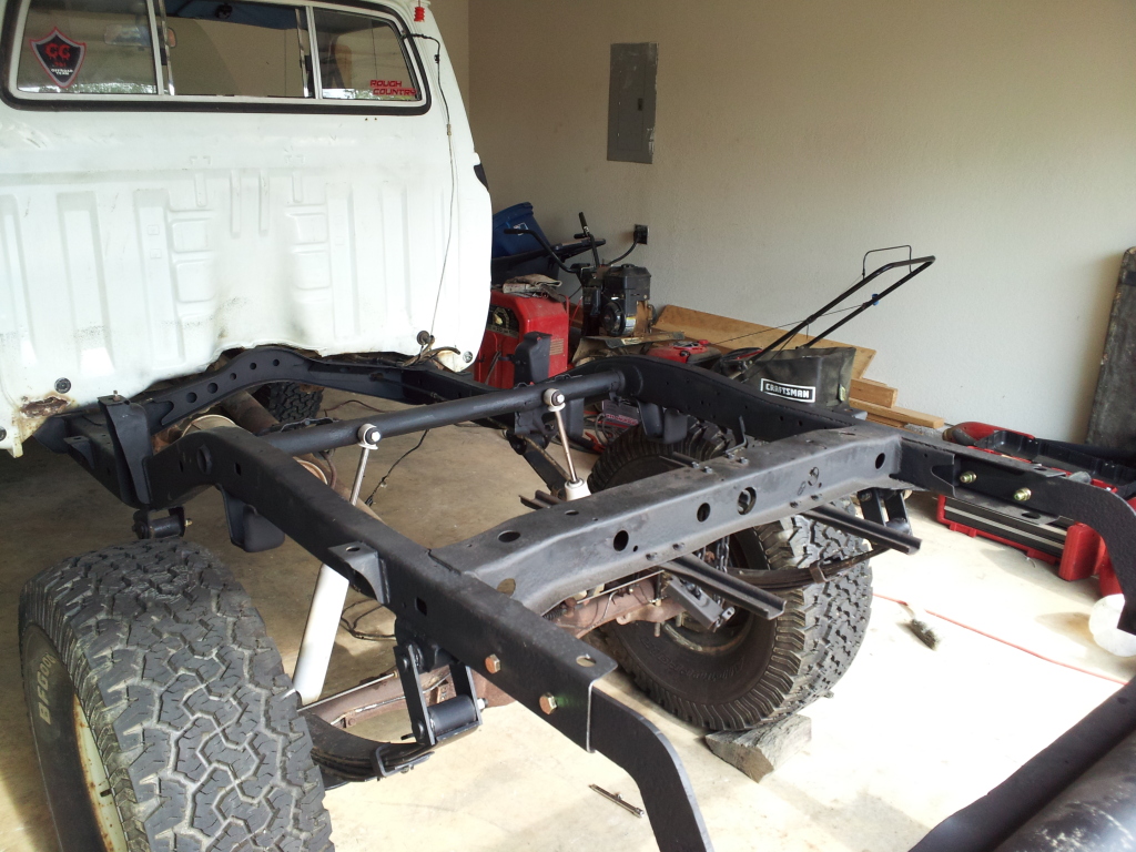

I cleaned my frame (just the back right now) with a flap disc and put a coat of rustoleum rust reformer on it and plant to put a topcoat of eastwood chassis black on top of the rustoleum. Should last a while. But POR-15 is a better option.
