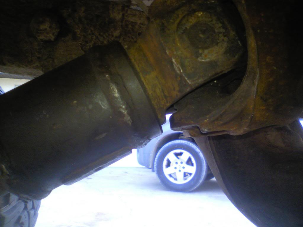

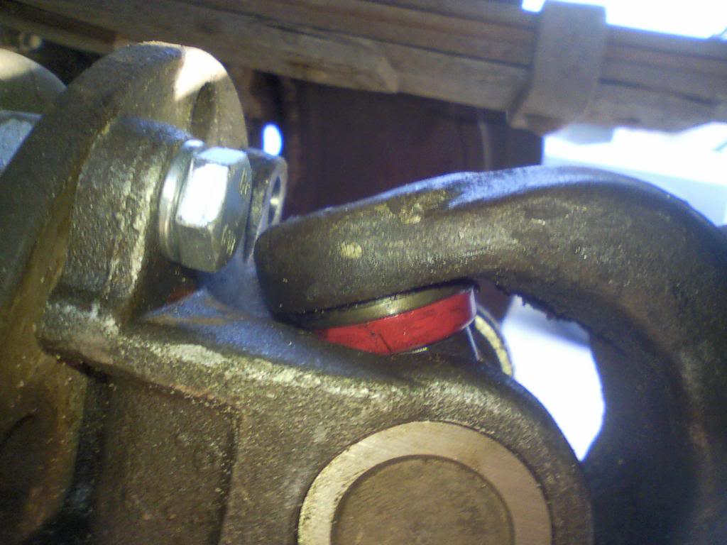

ok so here is the new flange next to the old one
Here it is in the truck!
ALOT more clearance
only problem now is the other side
I'll do the whole take it apart thing and clearance it, then hopefully I will have enough flex in everything to be good.
Also taking out a leaf in the front will lower me 1/4", that should help some.
I'll get a manual brake bias adjuster to help my brake diving situation also.
