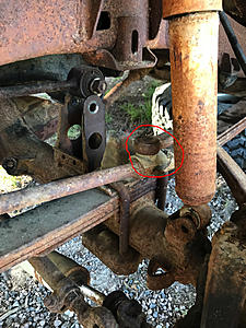

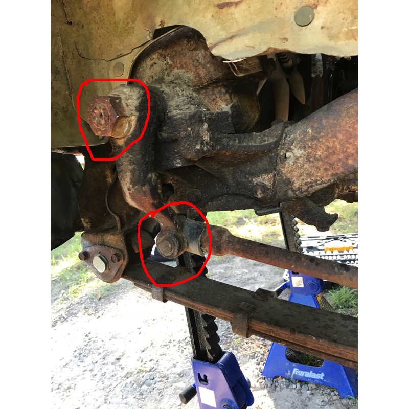

In the first photo it looks like the arm disconnects but I do not see a way to unscrew it. In the second photo is looks like two different places to disconnect the arm, but in the walkthroughs I see the arm is not connected to the axle.

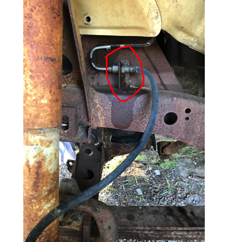

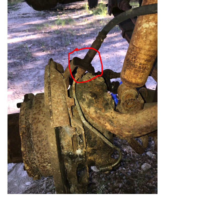

For the brake lines I am not sure which bracket to take the lines off of. The truck has sat for about 15 years so I am not sure if the lines are not supposed to come off the brackets or it is jsut difficult to take off because of how long it has sat. I have taken the caliper off but still have the brackets on the dust shield and on the frame.

For a quickie. On the drag link, there are cotter keys on both ends. Remove them and unscrew the caps, and a plug will come out. Remove drag link.
For the brake lines, remove the hard line to the fitting on the bracket. Pull the clip out and the fitting and line will come out of the bracket.
