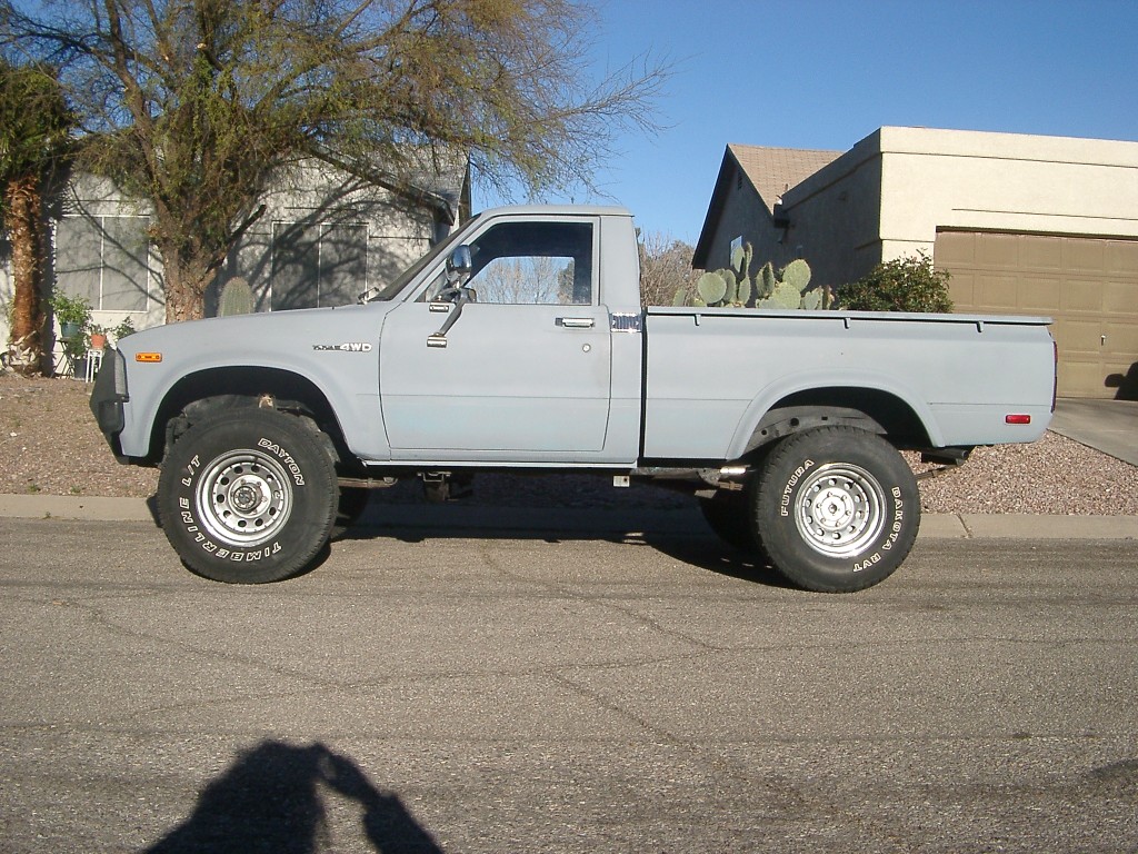

So a few of you have mentioned a lift kit. Do you think a lift kit was installed at one time and then removed, with remnants left behind? It doesn't look lifted to me now, but I could be wrong. Also, it sits about the same height in back as it does in the front (doesn't seem to be sagging anywhere). Here is a side view of the truck (it has 31 x 10.5 x 15 tires):
So probably those pieces of square tubing are all that's keeping it from sagging in the front?
