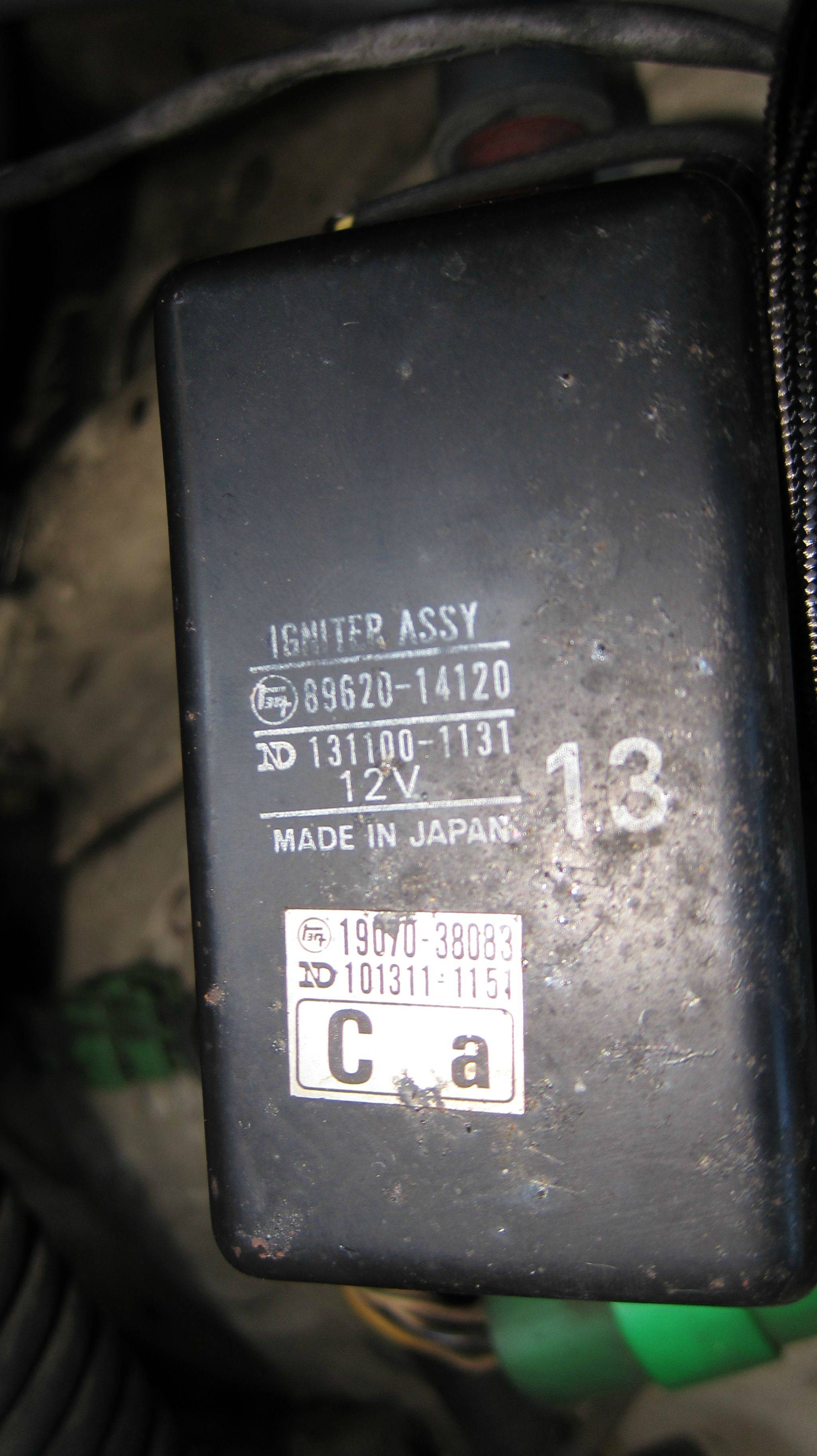

So assuming it is the assembly/control module; the question is, how can I get one?
Is this part stock with other Toyota 20R models around the same year? aka: 4runner, celica, corolla.
A new refurb is $360-400, so I'm trying to look into my options as far as going to a Pick n Pull nearby. My Toyota Corona is a somewhat rare model, and I can't find any matches for it in the area.
Your advice is EXTREMELY helpful, and any leads I could get will be so amazing. Thank you all!
Here are a couple photos of the parts.
Suggestion from the parts store guy:
http://www.ebay.com/ctg/Airtex-6H129...dule-/75804228
1978 Toyota Corona (my part, the culprit):
Replacement (?):

Your car may be rare, but 20R and 22R motors are not. Chances are you can cross reference that igniter assembly with one off a pickup or 4runner. See what the part number is for other vehicles and if they are the same then search for parts based on that model and year.

Also, I just did a simple google search of the part number 89620-14120 and it was replaced by part number 89620-35H92. Source:
http://www.toyotapartszone.com/oem/t...620-14120.html
Then searched that part number and found this:
http://www.villagetoyotaparts.com/pr...962035H92.html
That same ignitor can be found in a 78-80 Celica, 74-80 Corona and 79-80 Pickup
I know nothing about Coronas other than it's the name of a crappy mexican Beer that also happens to be a toyota car, but It's that easy - google is your friend. I don't want to sound mean or anything but if you are going to work on old vehicles you need to know how to cross reference. It will save you time and money.

BTW, eBay seller is ripping you off...The dealer has it for $155. You owe me a few coronas

Kawaz, thank you for going to all the trouble of referencing the part numbers through google. I had done it previously, but I'm still learning how to interpret all the data, and what to actually believe and what is just a trick to get me to buy parts from certain websites. I'll admit that I'm pretty ignorant, and I definitely don't think you're being mean with your advice on being more thorough with cross-referencing.
