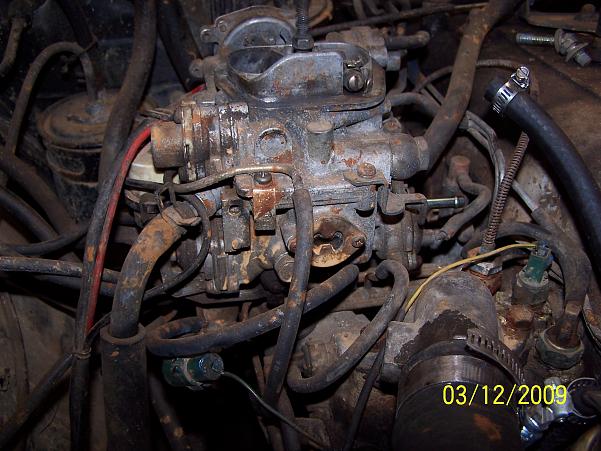

Just rebuilt the carb on my 83, was not as hard as I expected, had a friend that knew what he was doing to help me, we had it apart, cleaned, parts replaced and back together in a little over 3 hours, I'm gonna put it back on tomorrow and see if it fixed my problems, it should have fixed them because there were dirt dobber nests and rusty sludge down in it.
Would not be scared to tare into another one if I had to. Good learning experience.

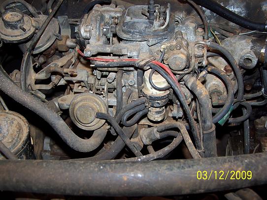

I marked a couple things on the first pic. Think these could have anything to do with the situation?

One of the cirlced items is you egr vacuum modulator. Egr issues could cause the truck not to start, or run really bad, but have nothing to do with gas. Do you have an FSM, or vacuum diagram?
