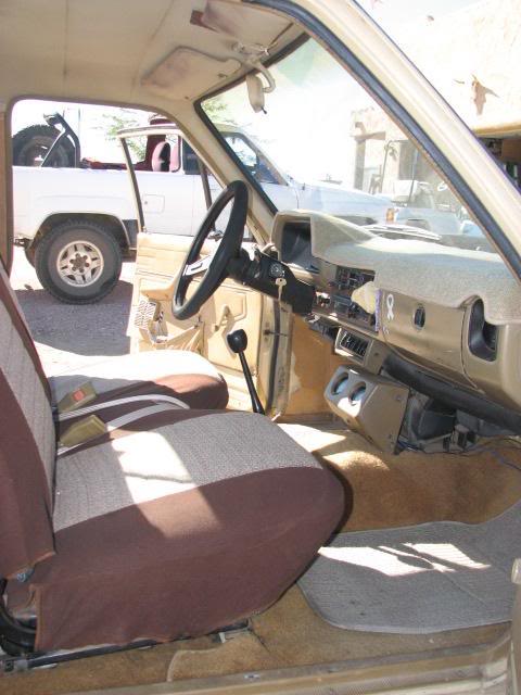

well your gonna need a longer tube for the gas tank, so dont lift the bed til you get it,
and i hate having the 2 inch body lift and that short stick, the shifter extender just makes it so the stick is the height it should be.

look how short the shifter was:
