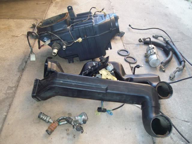

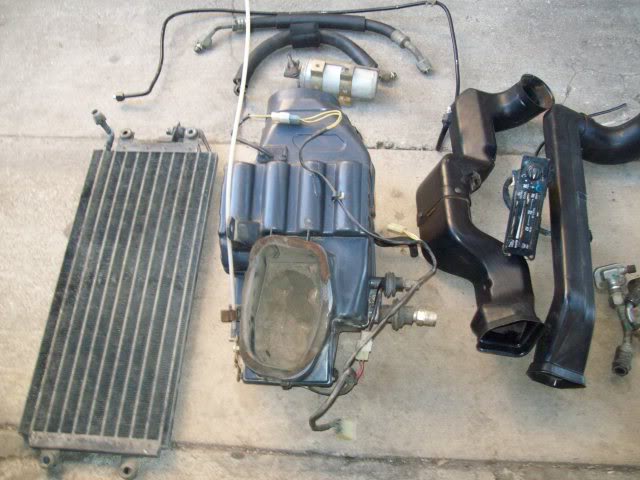

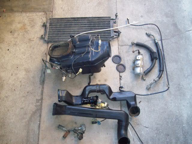

well after many junk yard searching i finally found a complete one(so i think)...i have a question to all who have gone down this road.i think a have an almost complete unit except for the compressor that i will purchase new..the question would be....what parts am i missing??any input,comments would much help.
some pics

Do you have the compressor mounting bracket? I don't see the center section of the AC ductwork in the picture (the part that the two ducts in the picture attach to - the middle dash vent also attaches to this piece). Do you have the VSV (vacuum switching valve) that runs the idle-up on the carburetor? Other than that it looks fairly complete as far as I can tell.

i have all the other pieces i think..now the VSV i dont have or have any idea of what it looks like!!...does any one have a pic of it?..i have the center piece that the other duct work attaches too,the mounting bracket i can get from a truck in a different JY.if any one has any picks of their ac units that dont mind posting it would be a lot of help.

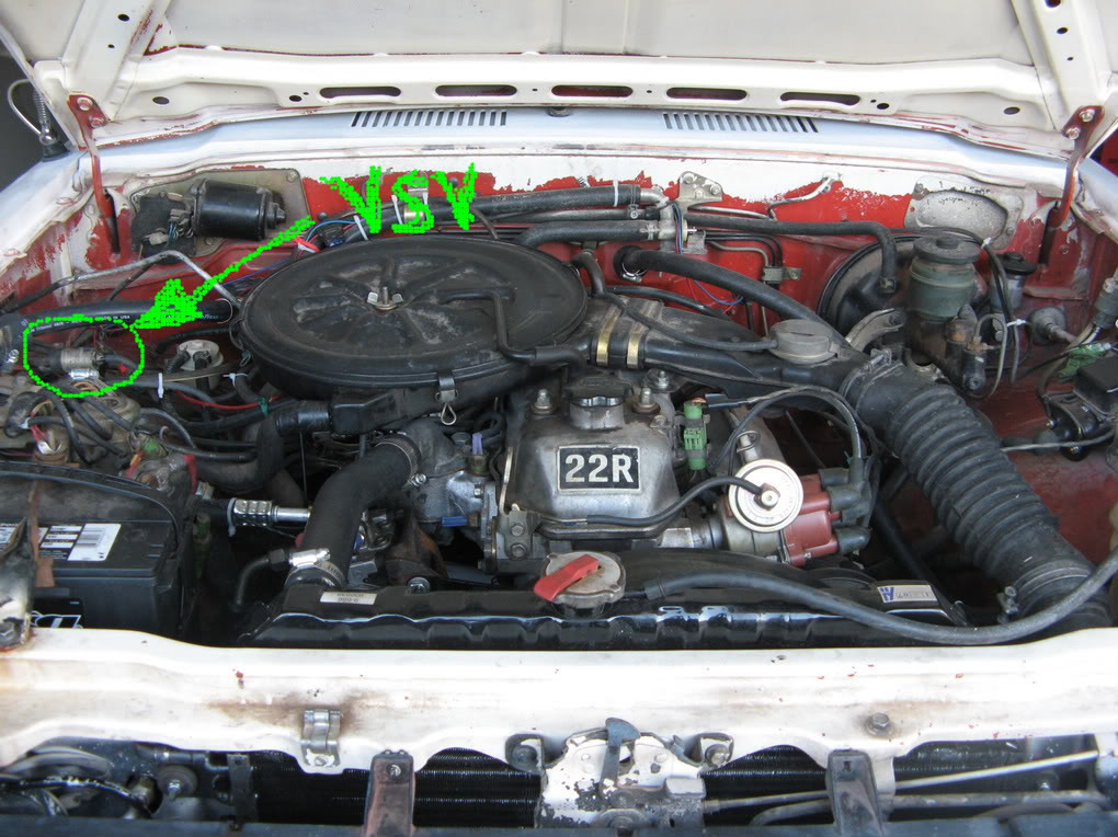

Here is a picture of my engine:

Sorry its not a very good picture. I circled a VSV, but I don't think its the actual one for the AC (don't think you can see that one in the pic) It is just a small cylindrical thing with two wires and two vacuum ports. When power is applied to the VSV (via the idle stabilizing amplifier) it allows vacuum to pass through. I ran a vacuum line from the VSV to the fast idle diaphragm on the carburetor. It increases the idle when the compressor kicks on so the truck doesn't stall. I can get a better picture of the actual VSV for the AC if you want.

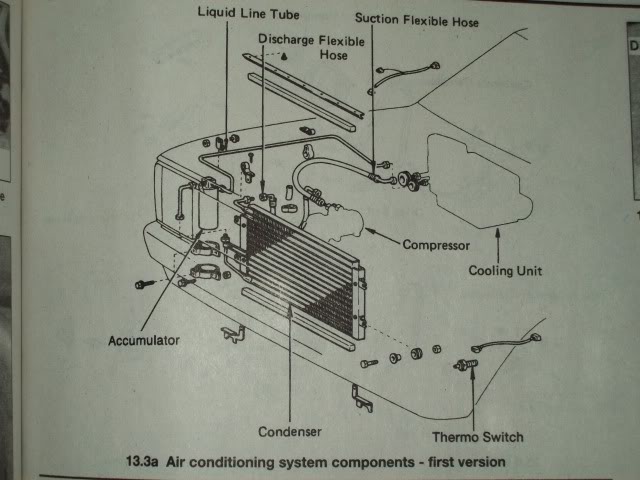

my Haynes does not list your VSV either

Not sure if all early Toyotas use a VSV, but I'll get a picture of the VSV tomorrow. I don't have any AC components on my driver's side wheel well. But after studying my FSM a little more I think that the Thermo switch is just the AC switch on the dash. The wiring diagrams in my FSM show a 'thermo control resistor' which is just the AC on/off switch on the dash. I just wired in a simple on/off toggle switch. Most of my AC system is from an 81 (I think) and everything matched up well with my 80 FSM.

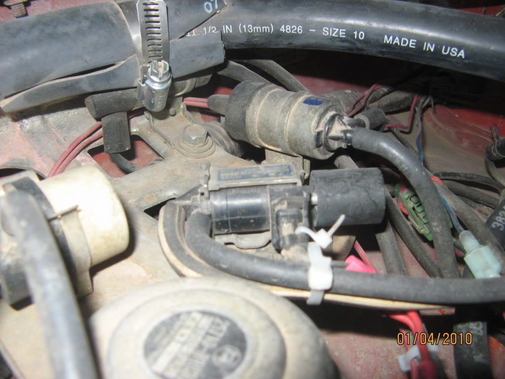

Here is a close-up of the VSV I used for the AC:
It's the one right in the middle that has the vacuum line with the white stripe attached to it.

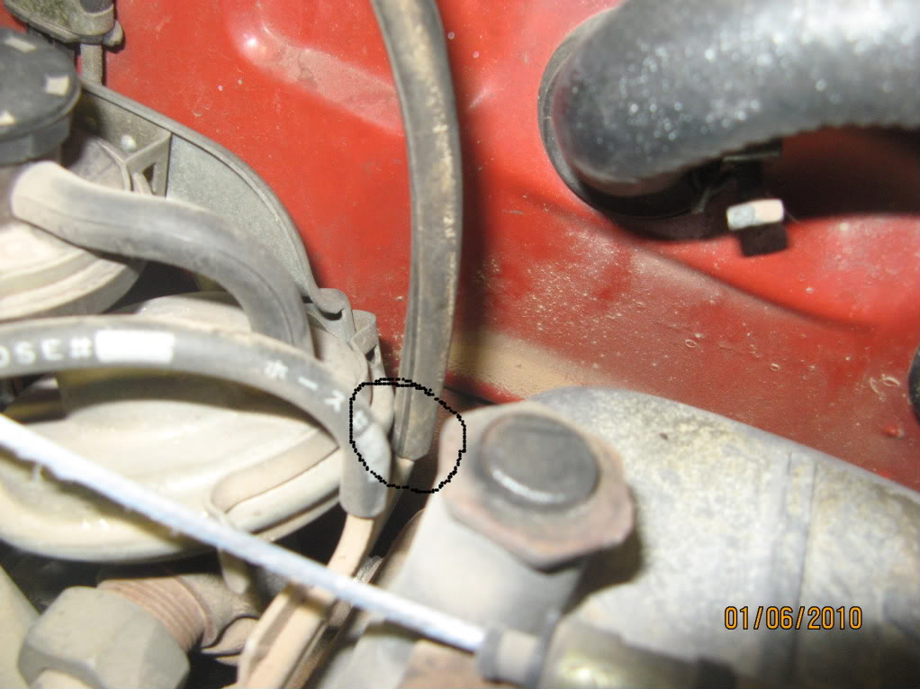

hey scottd... would you happen to have a pic of where the 2 hoses connect to carb?

Only one of the vacuum lines attaches to the carburetor.
It attaches to the fast-idle diaphragm:
The other line is just attached to a constant source of vacuum.

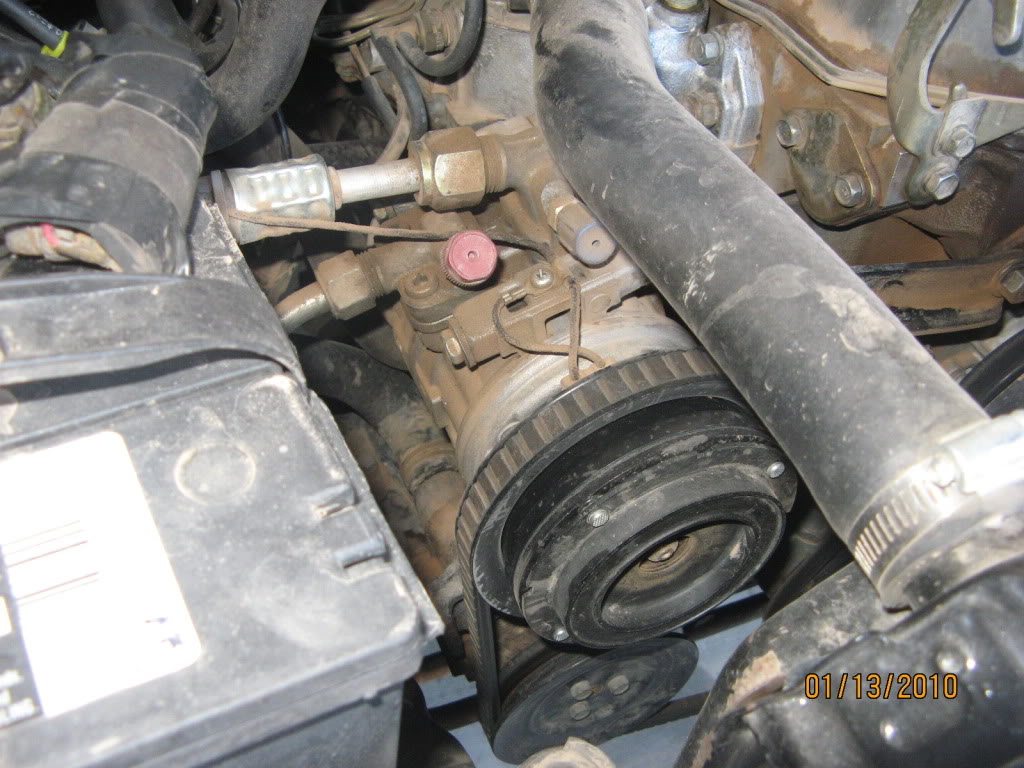

i need to see some pics of the compressor and smog pump..any one.my smog pump is right where the a/c compressor goes

My compressor sits directly above the smog pump:

thanks for the pic scott...now i only need the bracket
