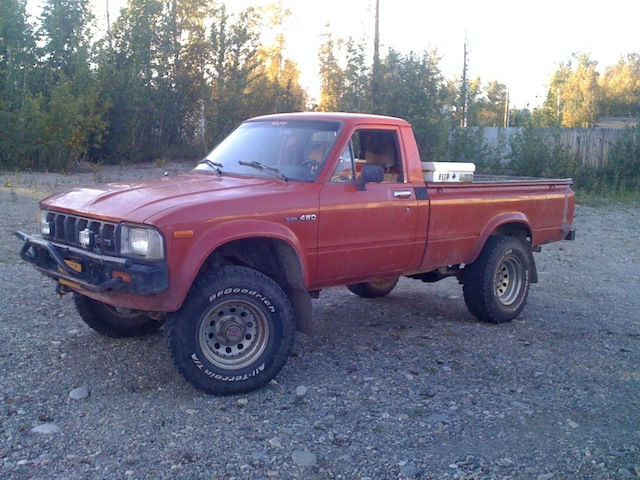

Just for kicks, here is a pic of it from last year when I got it.
