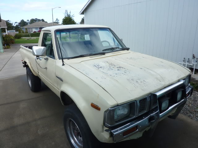

As i promised. not to bad for my first yota, although the antique eggshell white paint is the hardest to find in any hardware store anywhere for some reason . grrr

is "enterior" both interior and exterior?
nice truck!

haha, yeah thanks for the ensight. I have had no luck finding the paint to touch up the outside, and cannot even have a place order the kind i need, so im figuring on renting an electric sander, and repainting the truck. Only to find out when is the best time since afterall it seems to rain 4 days outta the week here.
