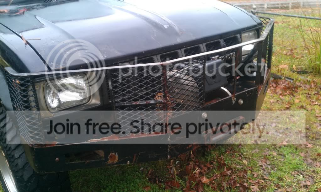

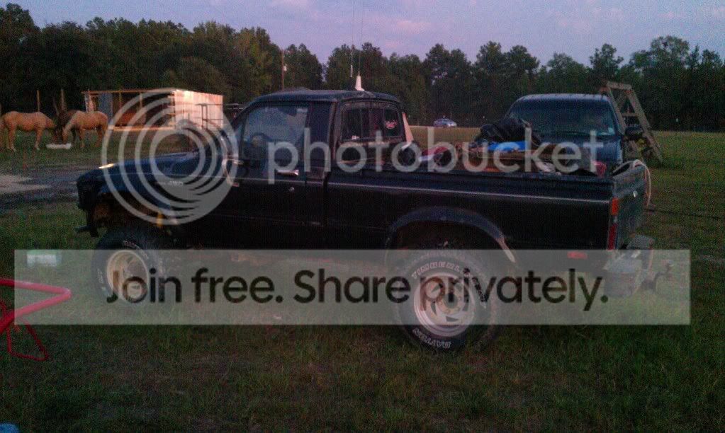

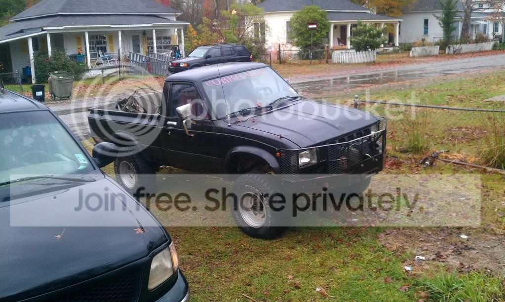

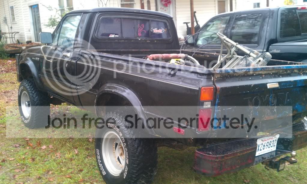

A few better pictures of my truck

moroza's Avatar
Joined: Mar 2008
Posts: 395
Maybe it's the vodka talking, but that sure looks like a shortbed to me. Looks good anyway!
Old Dec 18, 2011 | 05:22 PM
igotit's Avatar
Joined: Jul 2011
Posts: 349
From: houma louisiana
hmm...my 82 is a long bed,looks like you have a short bed.
but maybe its my budlight altering my perception.
i can fit my 500 honda with 26 inch itp 589's and have 10 inches to spare.
Old Dec 20, 2011 | 10:55 AM
Irey's Avatar
Joined: Dec 2011
Posts: 13
From: Elizabeth La
What is the length of a long bed? I will measure mine when I get home and repost.
Old Dec 20, 2011 | 12:30 PM
4x4YOTA's Avatar
Joined: Oct 2007
Posts: 1,308
From: colorado
long bed is 88.5
short bed is 74.5
