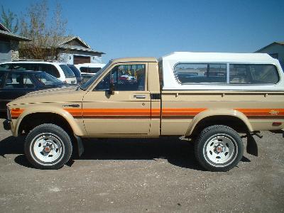

Here's a pic of it.

It seems a bit high, but they are getting scarce. The one that sold for $7K seemed like it had some rust along the seams of the bed, but looking at that picture, that truck looks like one of the nicest first gens out there.

From that one pic it's a pretty sweet looking truck, and I do love the old ones. Cool to see some others feel the same way and are willing to spend some money on them.
