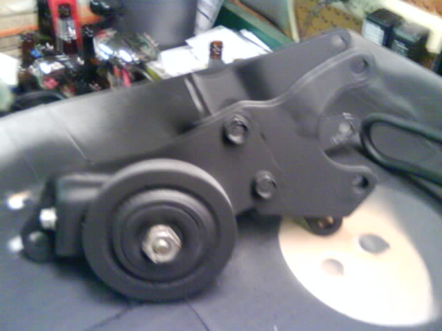

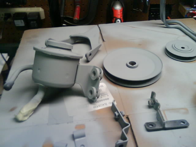

i just did it.it was realy easy found a rig with all the components all of it bolted right on.here are some pics of the parts you will need
pump and gear box
mounting brackets
steering shaft
pully that goes on the crank
resivor and cooler
my manual gear box was shorter than the power one
needed the steering shaft to go with it
my manual gear box was not threaded for the lines either no provisions for it
Attached Thumbnails 81 Pickup power steering-dsc00176.jpg   81 Pickup power steering-dsc00173.jpg   81 Pickup power steering-dsc00177.jpg

Steering shaft, eh? Crap. I didn't get the steering shaft...didn't get the pulley that goes on the crank, either, but I've heard of people getting away with putting the belt on at an angle, on the pulley that must be meant for AC? Not ideal...but it would work until I found that extra pulley. I wonder if I'll definitely need the steering shaft...looks like I should do some measuring.
Check the internet, check your local junkyards. Eventually something will come up.

well just be aware of the length of your gear box there are some slight variations on box lenght i have read on another tread on here that there is a difference in box lenght.some just dont have th provisoins for the fluid ports. i just put power steering on mine like 3 weeks ago and my power box was shorter and my shaft would not fit(some kind of girth problem) He He. luckily i took the shaft off the truck i robbed it from.
