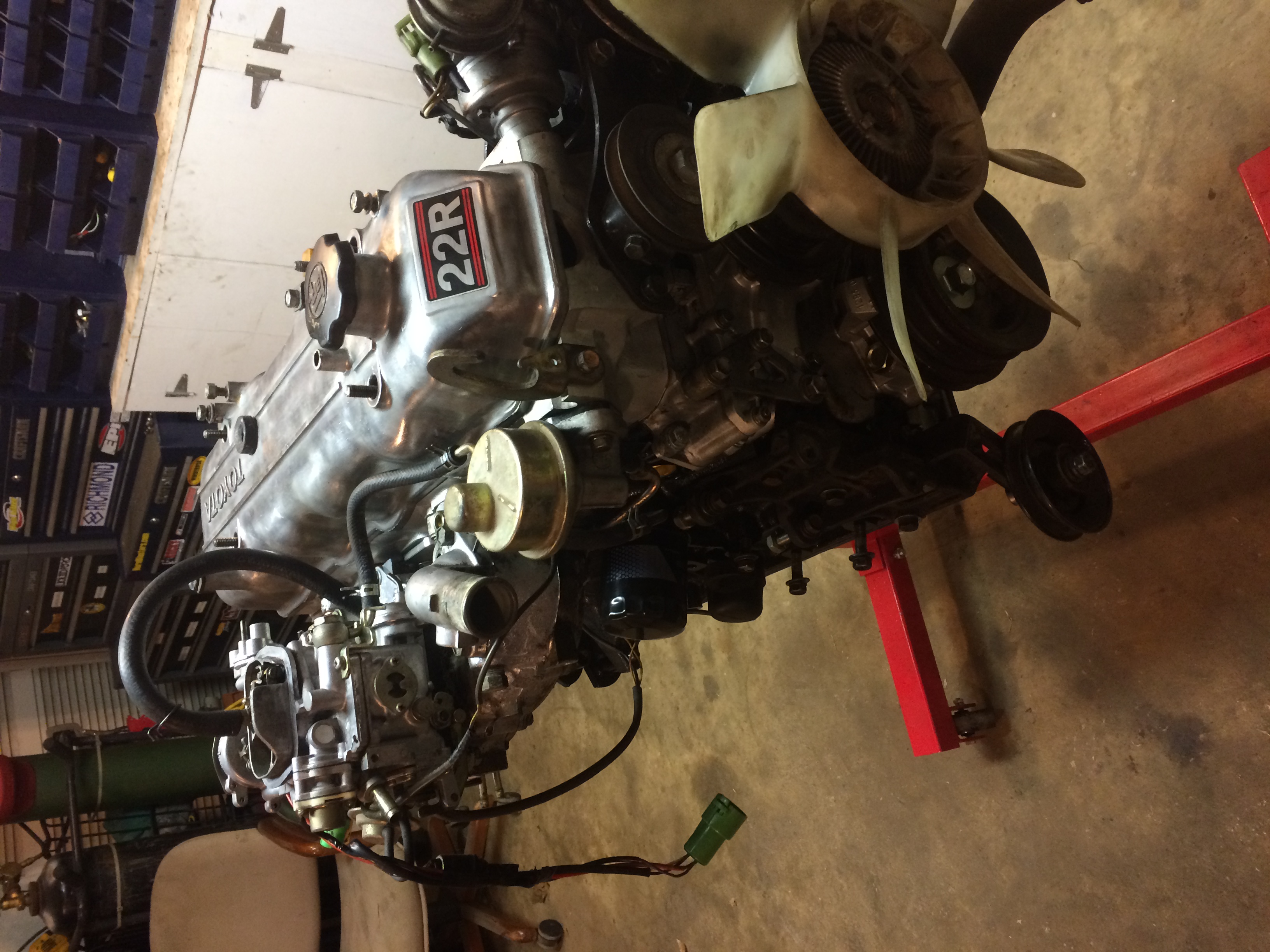

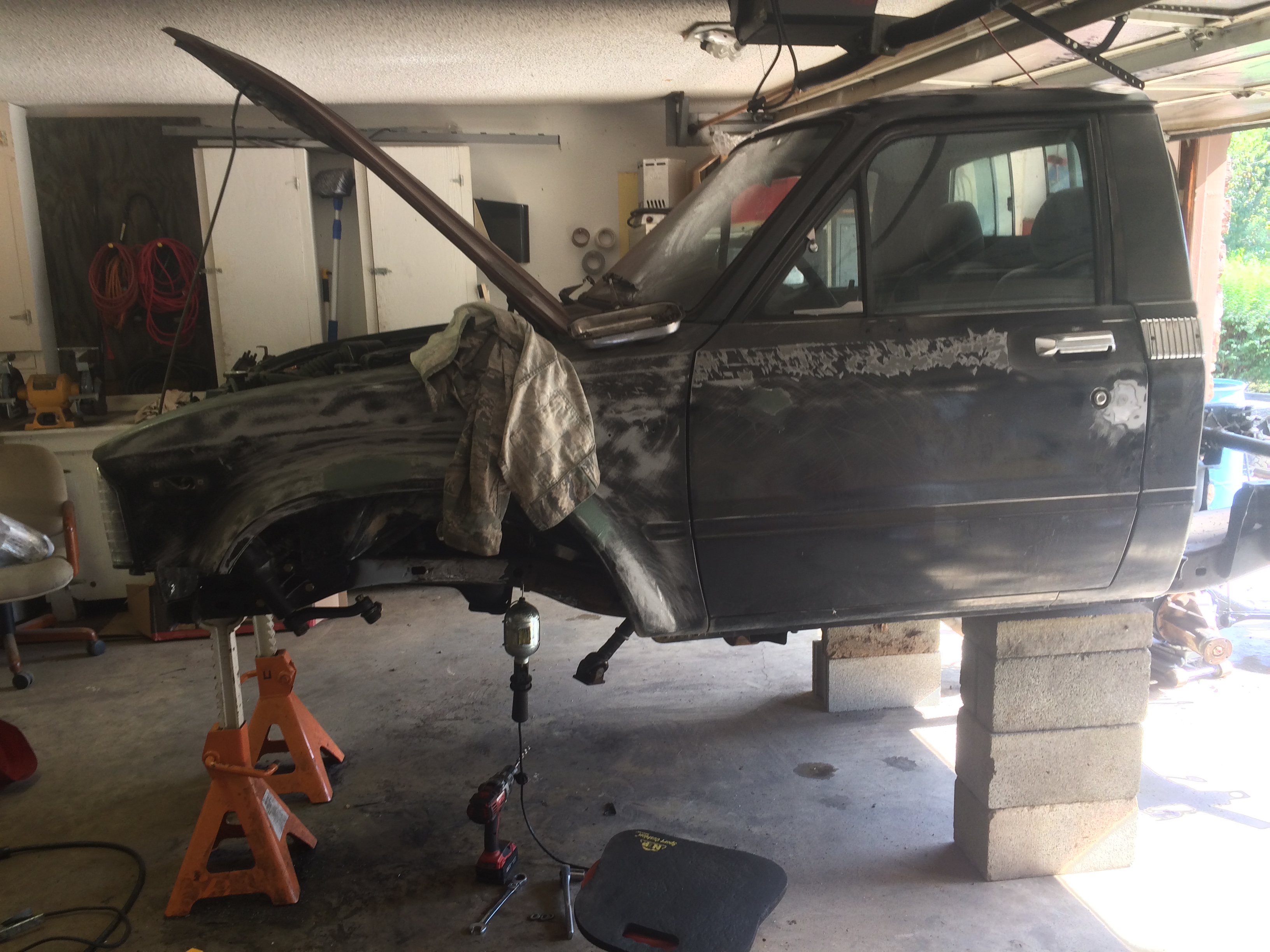

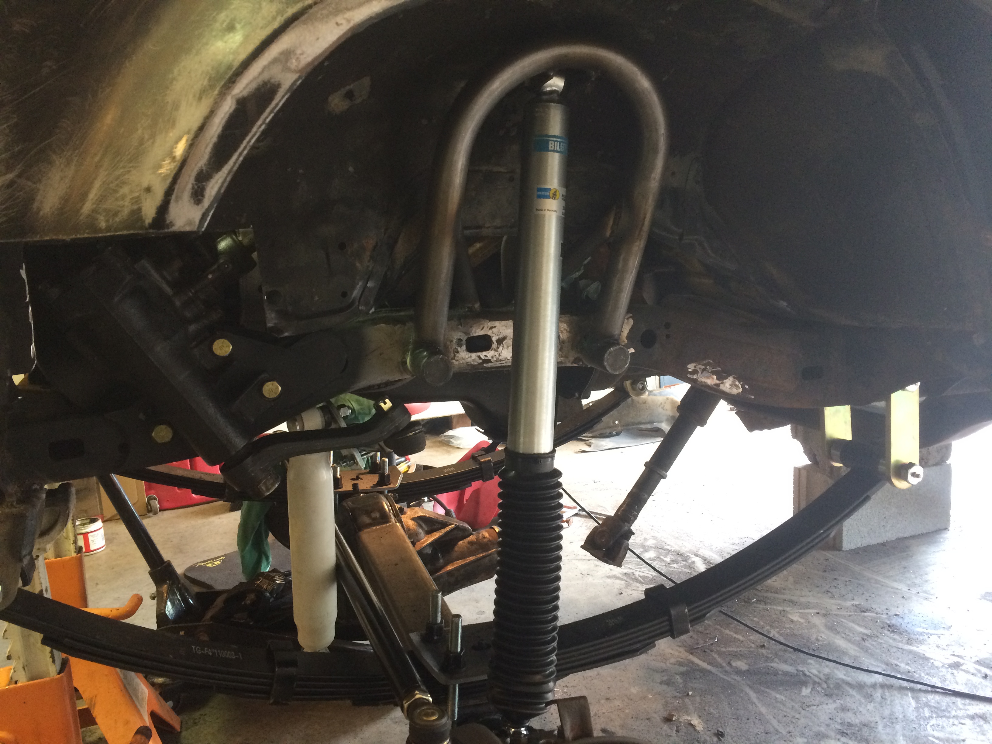

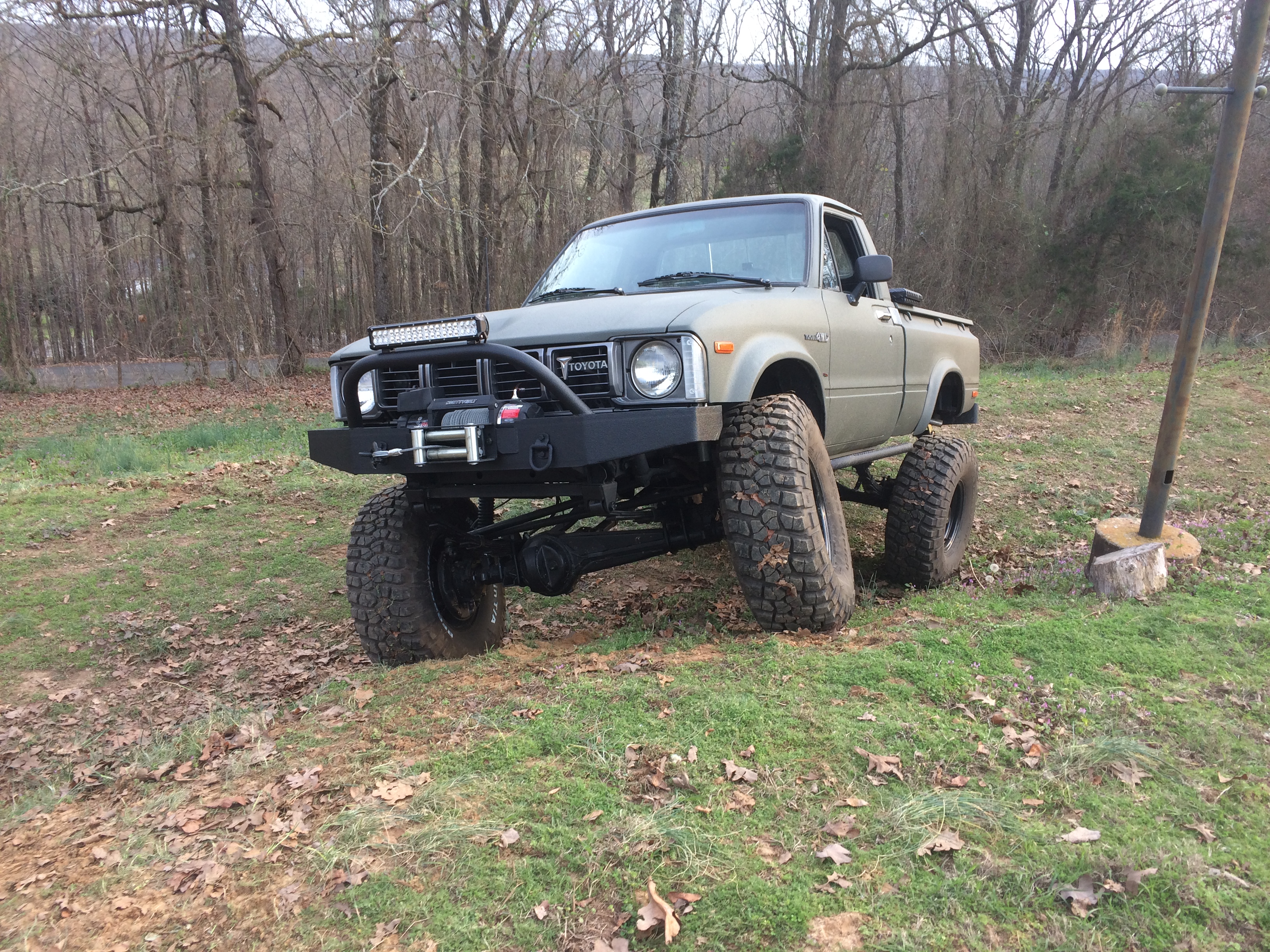

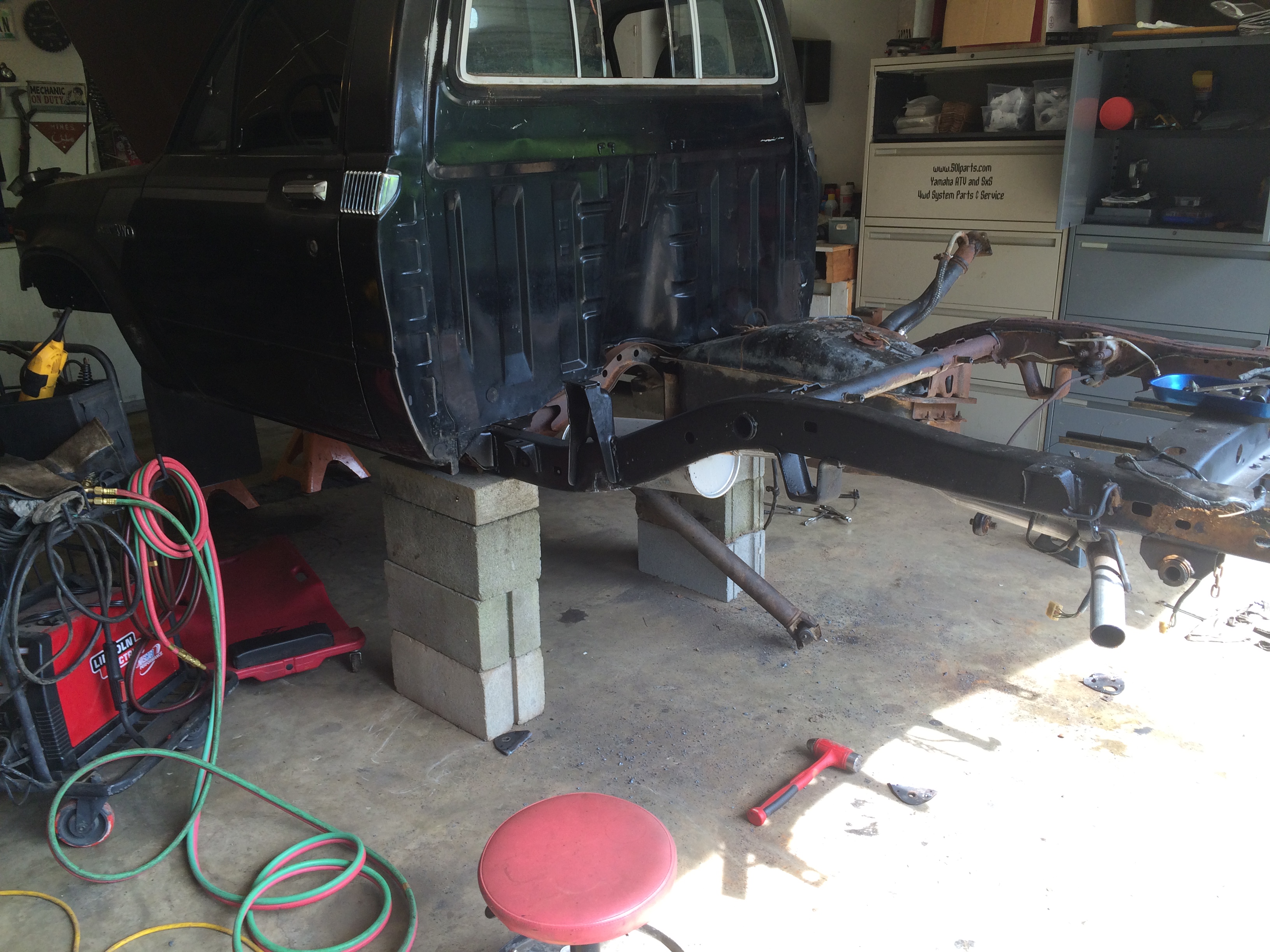

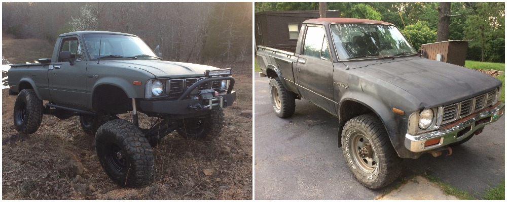

Bought this 81 last July to originally just make a beater truck. Found out the transmission was bad in it, and the motor had a bad rod bearing. Discouraged, I went back and forth on whether to sell the truck or not. Well I ended up just rebuilding it. Rebuilt the motor from the crank up, had the block bored .20 over, head redone, and all new internals. Found a G52 transmission for cheap and put it in along with dual transfer cases, and 4.7 gears. Went with Yukon Zip lockers and 5.29's in the front and rear ends. 4" lift springs and high steer. Went over the whole truck with raptor liner, OD green and fabbed up a front winch bumper. Threw in some Honda civic seats and fabbed up some diamond plate door panels. Just got it drivable last weekend, does pretty good on the streets and flexes like a champ. Thought I would share a few pictures from the build.

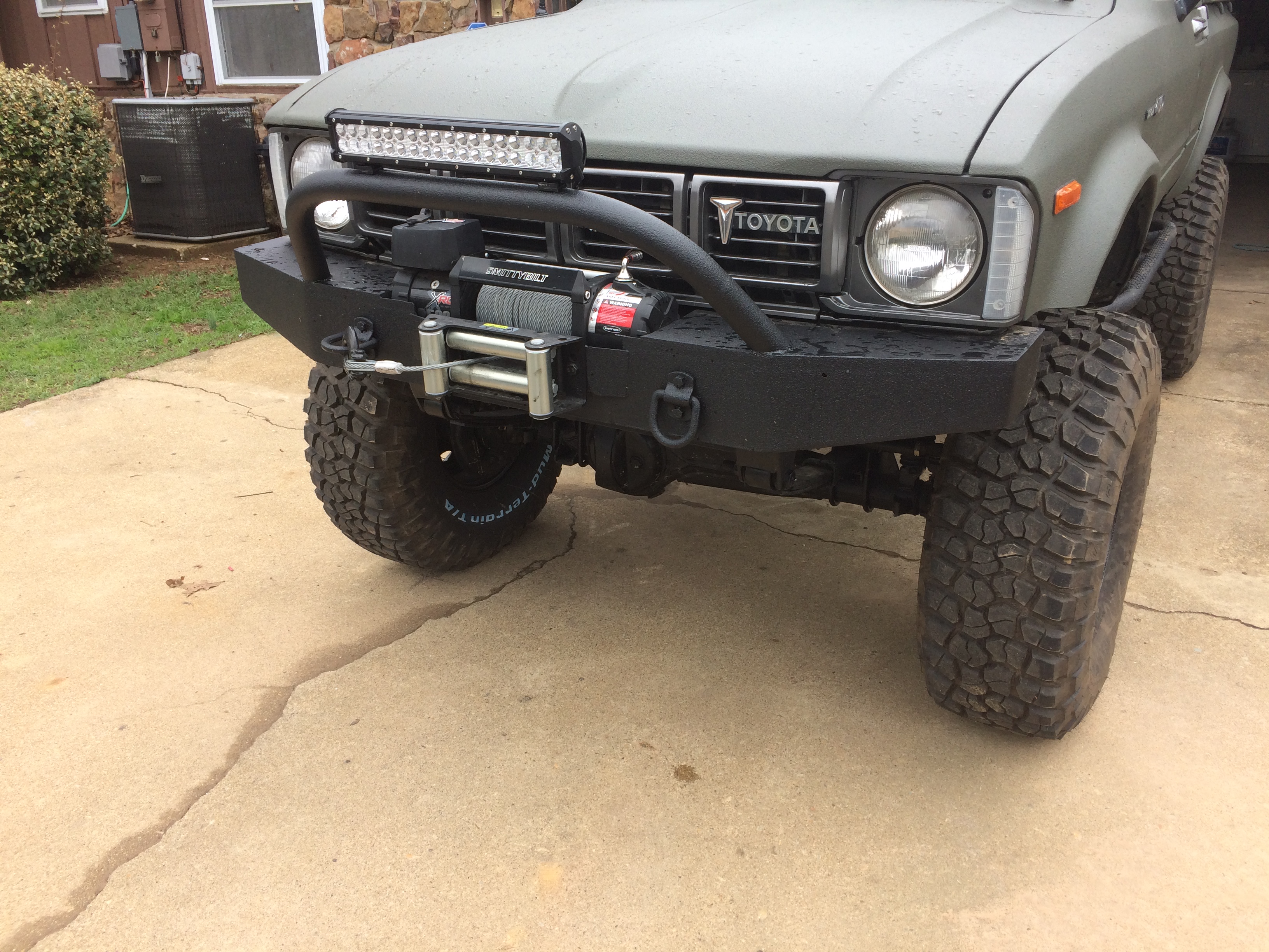

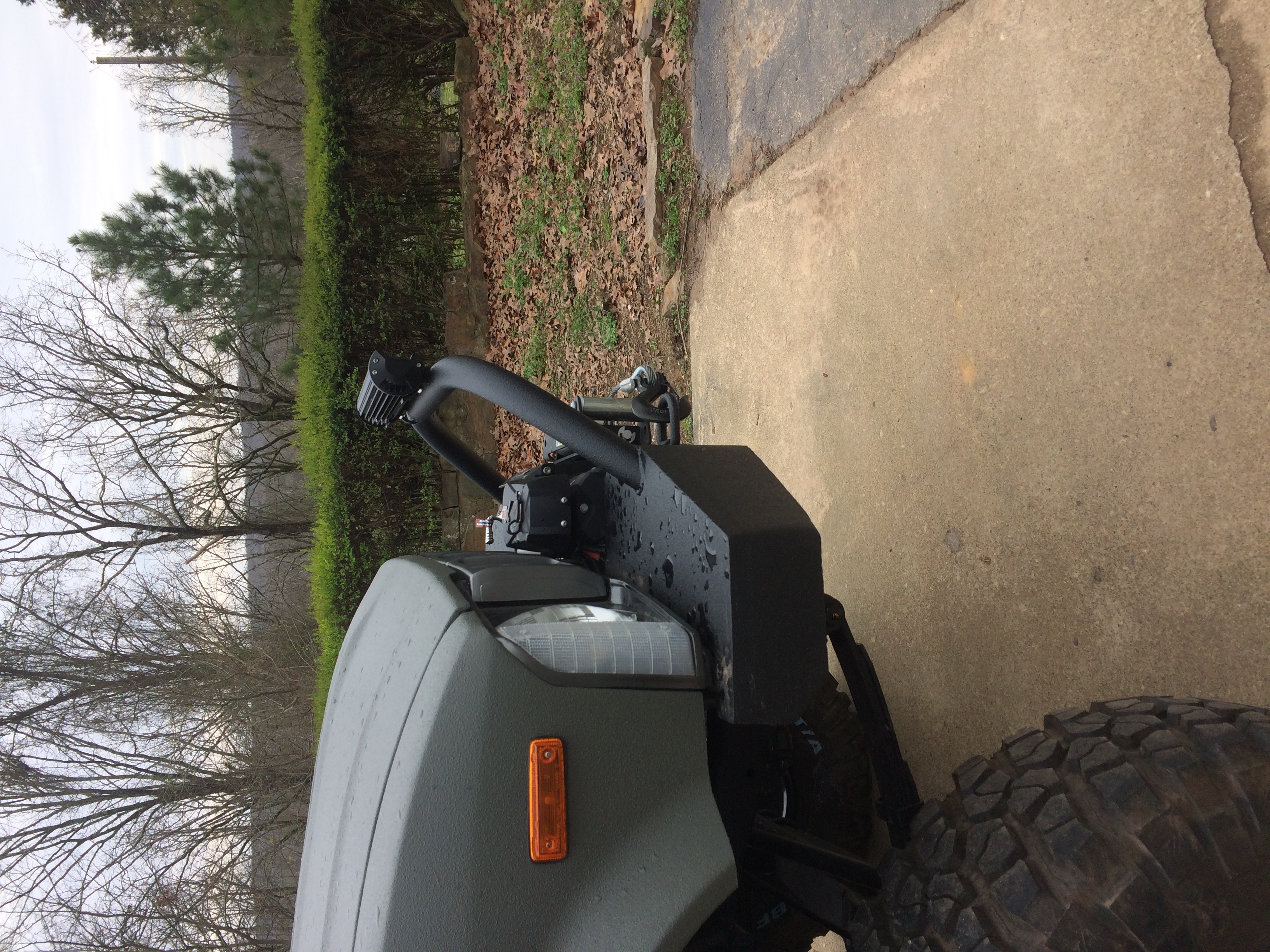

could you post some pics of your front bumper, including how it is mounted to the frame? I haven't had much luck finding aftermarket bumpers I'm willing to pay for for the first gen trucks...

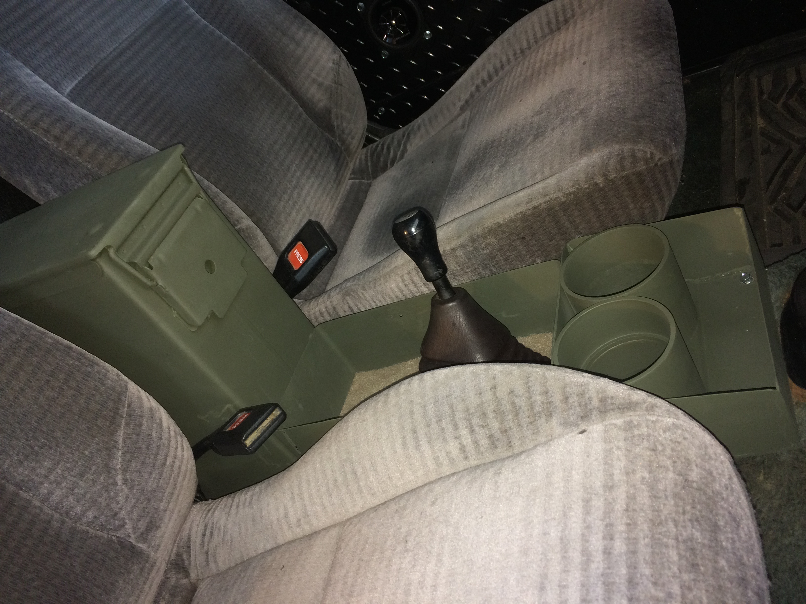

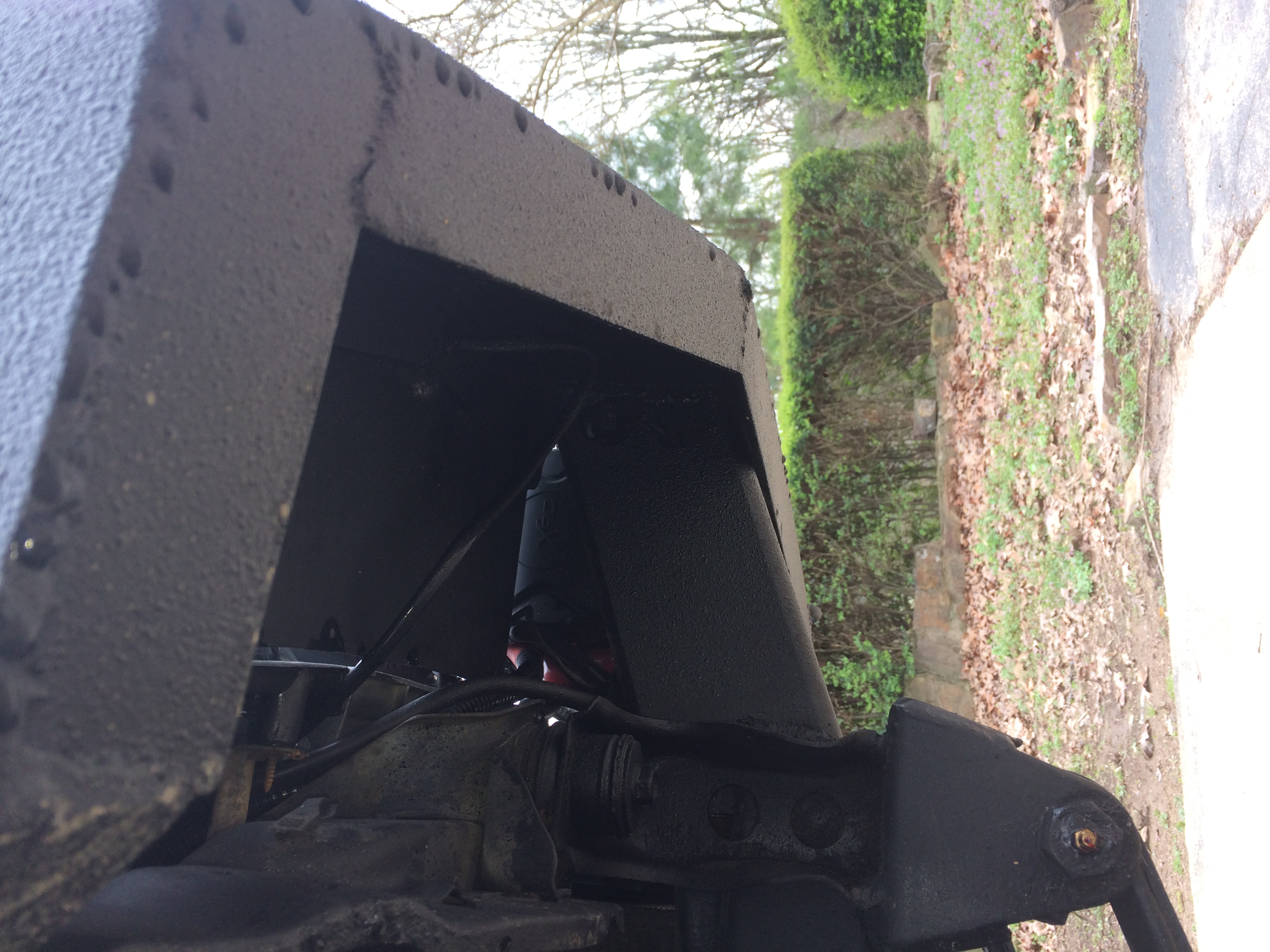

Thanks guys, here are some pictures of the bumper as requested. I welded a 2x4 piece of square tubing to the frame with drilled plates on the end of the tubes. The bumper is bolted to that with 4 grade 8 7/16" bolts. The bumper started as a 6' piece of 2x6 U-channel. I notched and bent it and capped it with 1/8" plate. Just made a center console today out of a few ammo cans I had laying around, I'm proud of it.

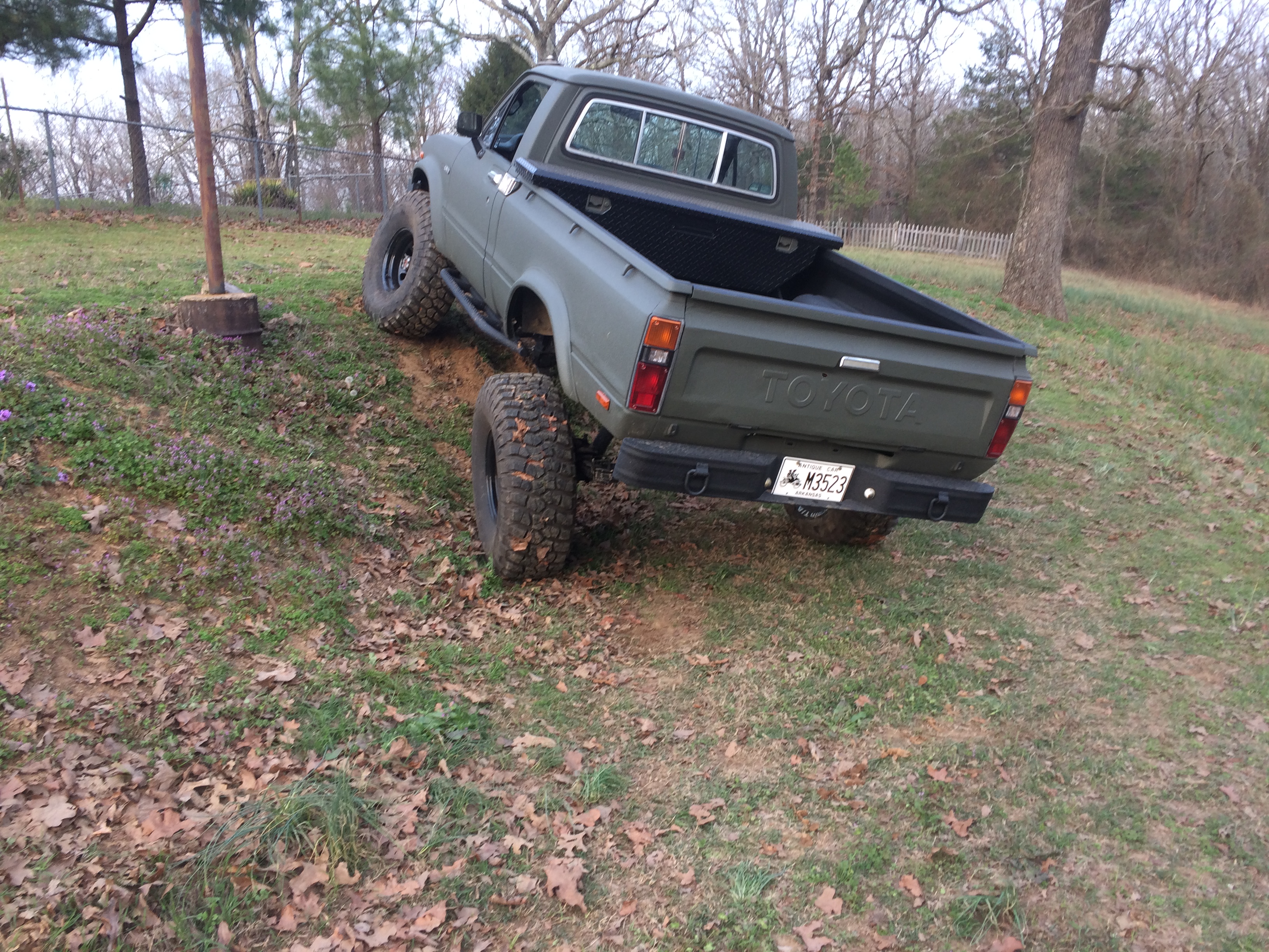

Thanks fellas, I got the trans back out, fixed the seal and got it going again. Since then, I've pulled all the carpets and put 2 gallons of black spray in scorpion liner in the floor. I'm not sure it was the best idea cause now I'm dealing with heat. Looking for solutions, if you have any ideas, I'm open. The transmission hump gets pretty warm. We were running back during the summer and it really heats up the cab just creeping trails. I've got to get something to at least go over the hump but really don't want to go back with carpet. Any thoughts? Here's a picture of her out on the trails.

MAN! That thing looks great! What brand of leaf springs did you use? my truck is lifted about the same with 35's, and rides like a log wagon, and doesn't really flex as well as yours off road, even though somewhere along the line, i think it got chevy 63" springs, since the frame bracket was cut off and welded further forward....

Thanks! I went with the trail gear springs 4"kit front and rear. Mine rides pretty good. I had to play with the rear shackles quite a bit to get the ride/flex right but I finally got them set right.
