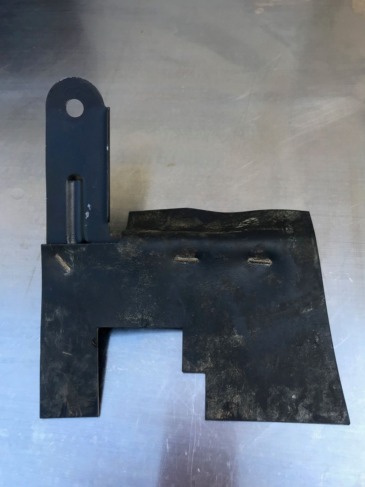

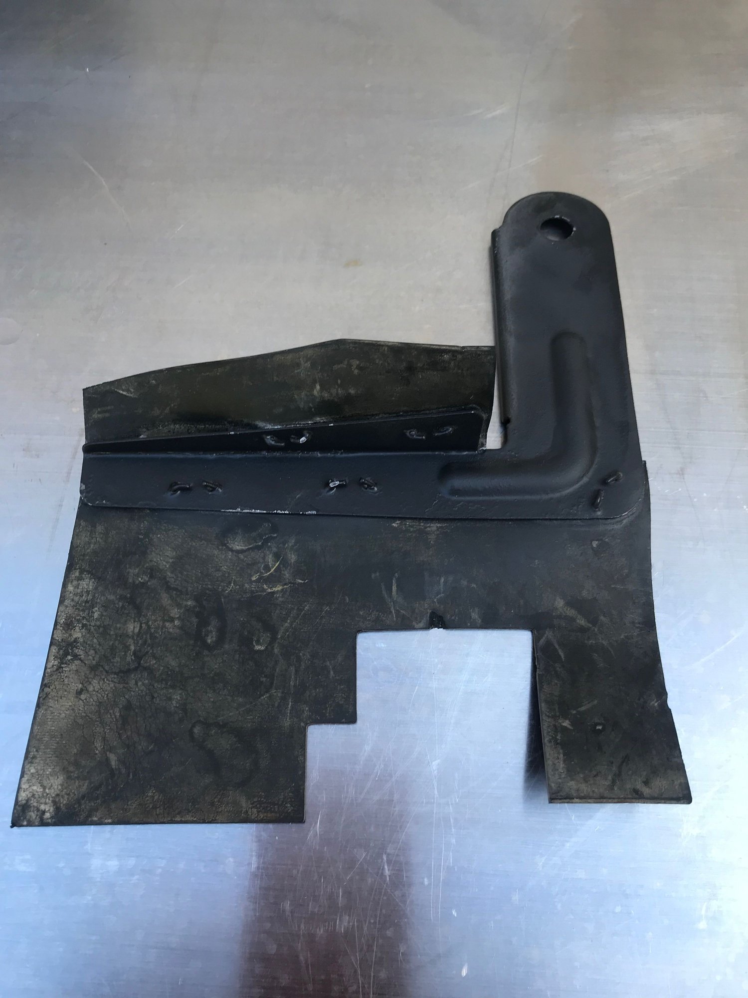

Took this rubber "shield" w/steel bracket off the truck 3 years ago - vaguely(?) recall it was attached to a radiator bolt on R side but I can't for the life of me figure out how it fits and for what purpose - Called a Toyota dealer parts guy who thought it might be part 53184A on L/Drvrs side near/behind headlight (see diagram) but I can't figure out where. 6.5" Long & 5.5" Wide. Any ideas? Thanks,

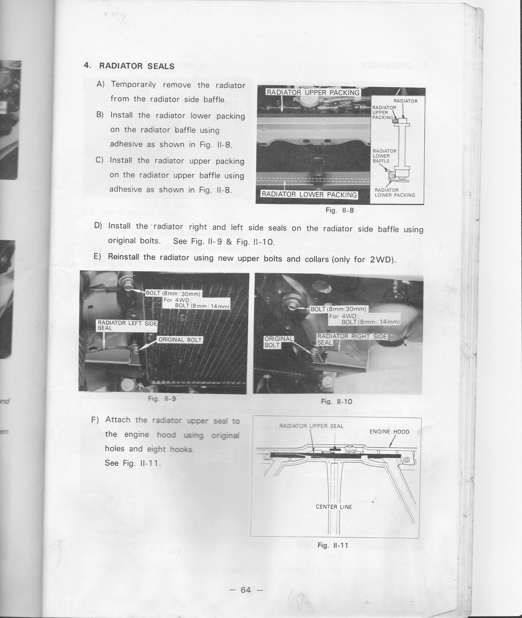

yeah , Its the shield down by the bottom bolt of the rad
there are 2 - 1 left and 1 right
see pic

Slacker, you are no Slacker. Thanks very much. Now I and 81 4x4 can avoid impending doom. Thanks!!
