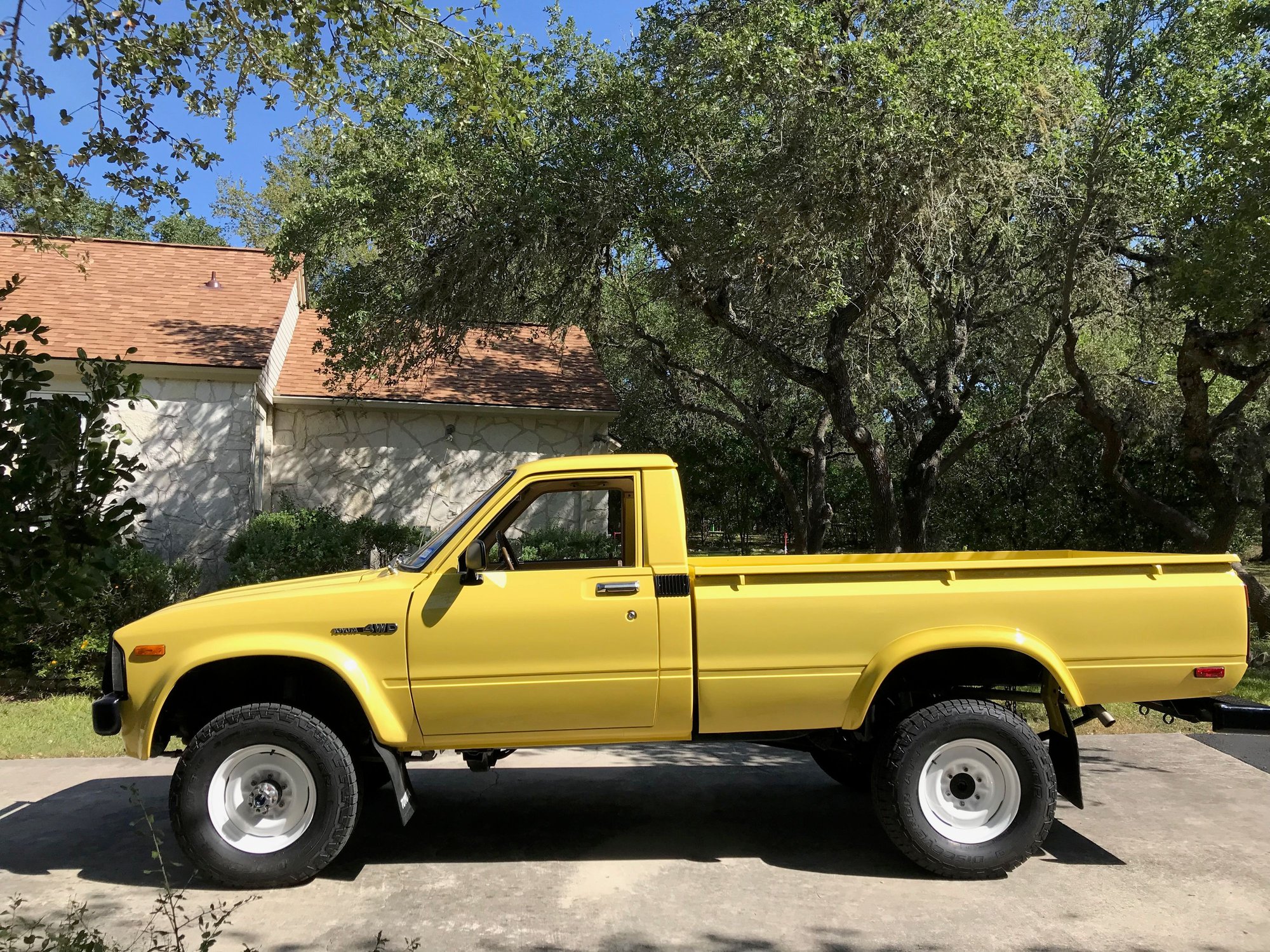

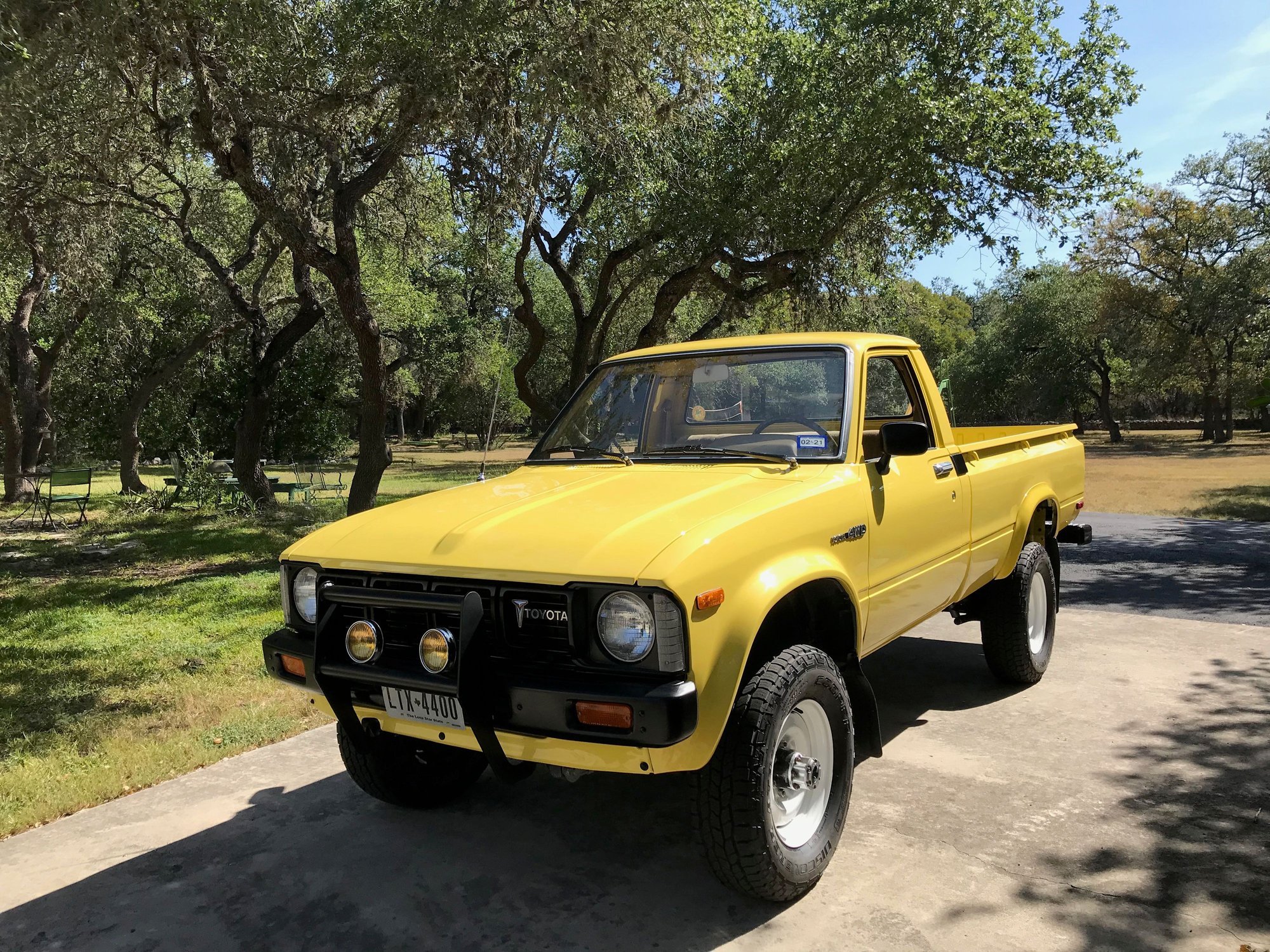

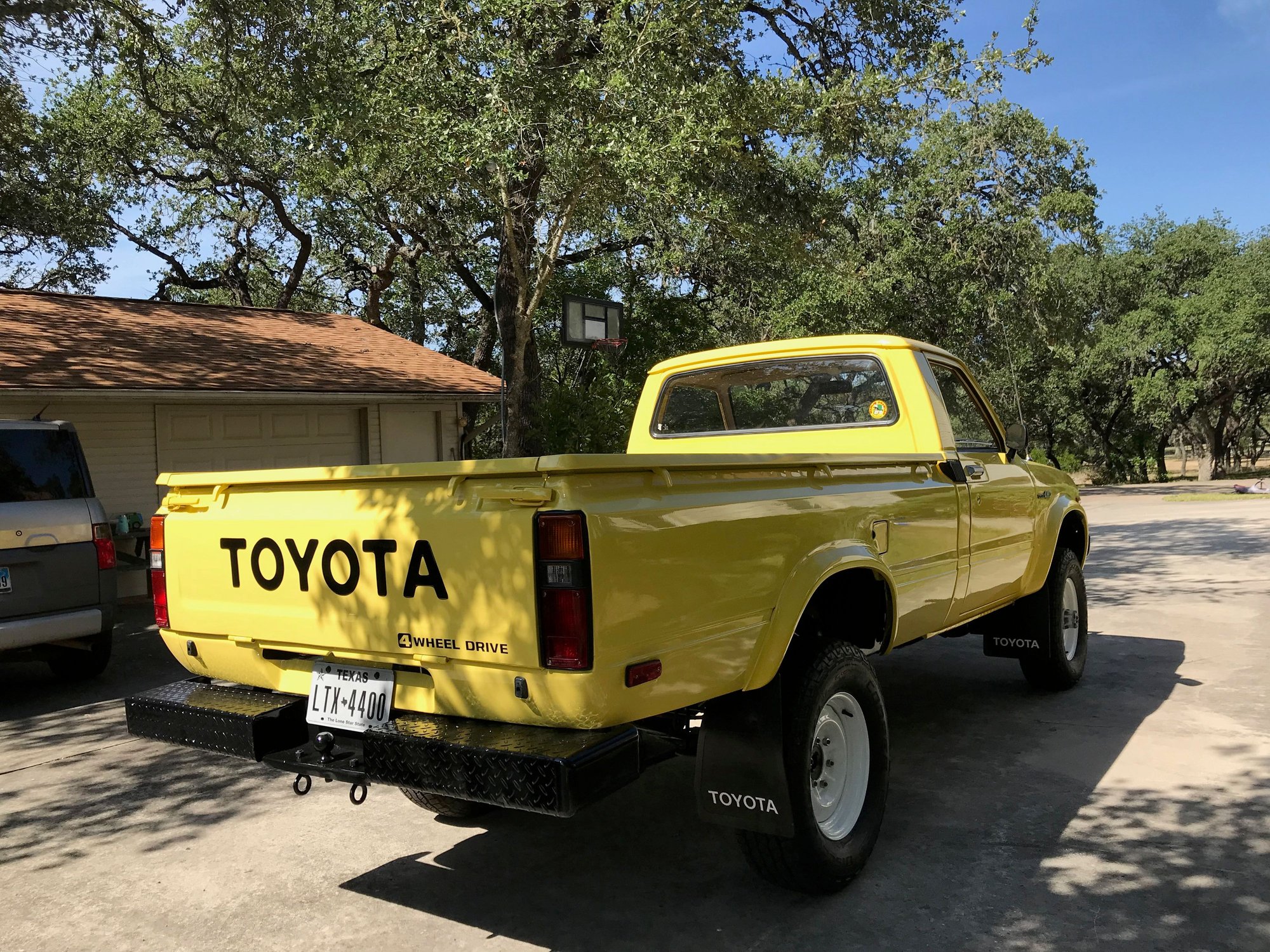

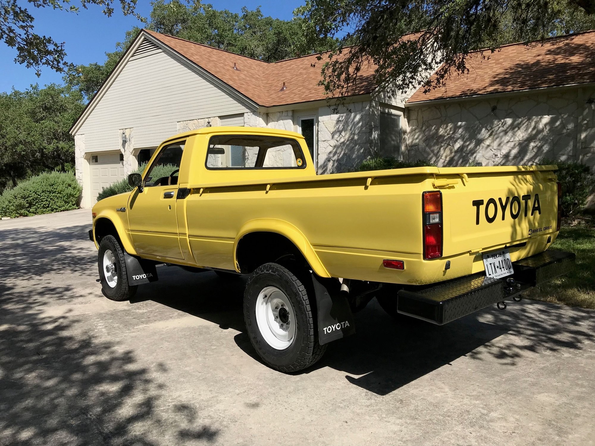

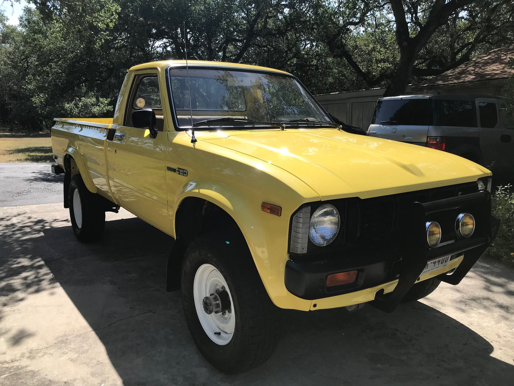

Purchased OK City Sep 2018 - Completed this am (spent about 12 mos + searching for and dealing w/ painters.) List of work:
1979 Toyota Long bed Restoration: From 7Sep2018
Engine Oil: Castrol 20w-50. 5.1 qts
Coolant: 8.9 qt
Transmission: 2 qts MTL
Transfer: 1.6 qt 75W-90
Differential: 75W-90
Front: 2qt
Rear: 2.1 qt
Steering/Chassis grease: NLGI No2
Brake Fluid: DOT-3
Replaced missing Fuel Door

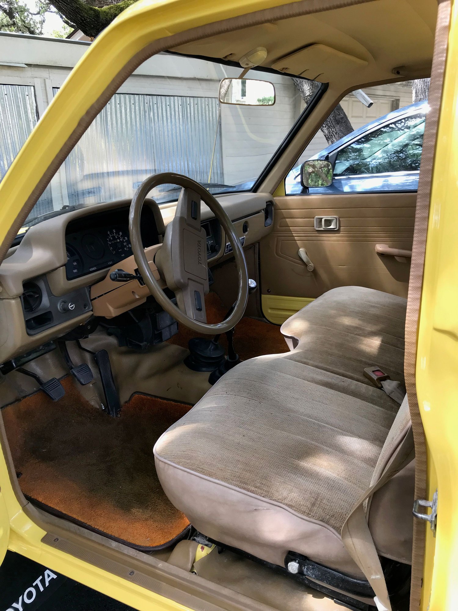

Abortive effort to recover dash - left dash cap on for now.
Clean/Paint Cab footwell side cardboard
Replaced all fluids - takes 87 octane NON-Ethanol.
Repaired/Installed Accelerator pad
New steel & cab mounts for Front 1/2 of Drvr & Passenger foot well. Art Lachance.

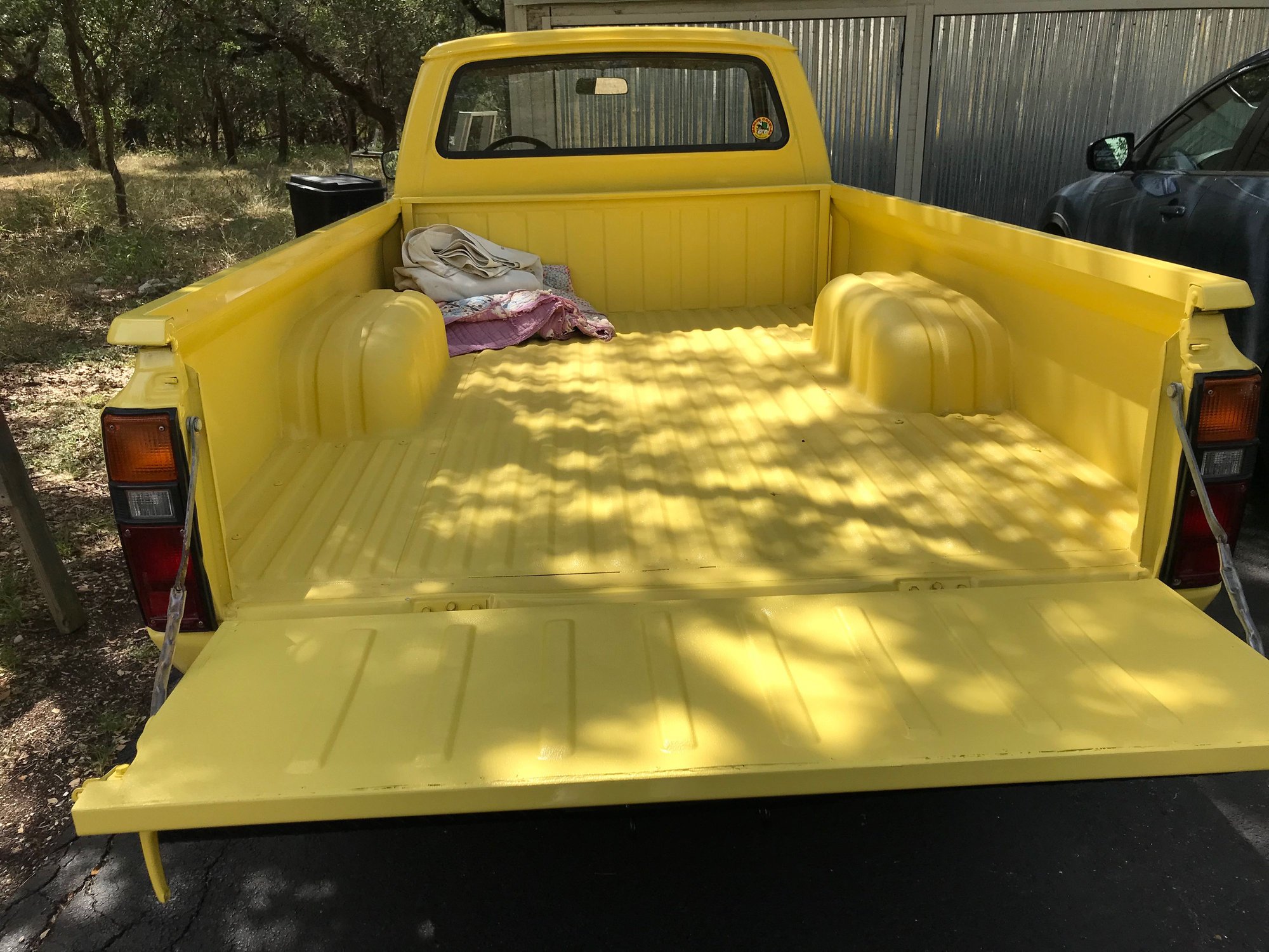

New Bed panel for R Rear Truck bed - 12-36”. Art L.
Repaired Horn with .22 shell over contact in Steering column.
Replaced 4 x Side Marker lights.
Replaced Slave & Master Cylinders.
Replaced worn L43 shifter bushings & shift shaft seal and boot.
New Antenna
Replaced Passenger Out Side Mirror
Repaired split Sun visors
Straightened out rear bumper (Drvrs side depressed 4”)
Clean/repair rubber cab mat. Replace cotton padding.
Lined cab floor with noise deadening tape.
Replaced Heater Valve & hoses
Restore/repair/paint both rear drum brakes/springs etc . Bleed brakes.
Repair/restore heater, new foam, replace resistor
Replace Front Windshield seal & trim.
Restore/paint windshield channel and pillars.
Restore & paint 5 wheels industrial grey
Restore/reseal Tailgate back.
Restore/replace Thermostat/seal
Replace Radiator/Hoses
Repair/paint Radiator frame front crossmember.
Restore/paint Fan shroud
Restore/paint Transmission Shield
Restore/paint Under Engine Shield
Replace Hood support grommet
Replace/paint Front L fender
Grease all grease points
Restore/Resurface/replace Clutch disc/bearings Me & David Kehl
Adjust Clutch - Art L.
Replace Fuel filter
Replace Grill Clips
Restore/Paint Transmission Support & Front & Rear Drive Shafts.
Restore/replace Muffler to Header flange/seal
Weld/Paint new Headlight supports. Art L.
Restore /paint front Radiator Support
Restore/Replace/Paint new Front valence.
Restore/Clean A/C Evaporator Unit/replace foam
Replace A/C Pressure Switch, Expansion valved, drier Me & David Kehl
Convert from R12 to R134A - Non-Op - Need new Amplifier?
Bodywork/paint for rust in lower L/R door frame.
Misc dent repair

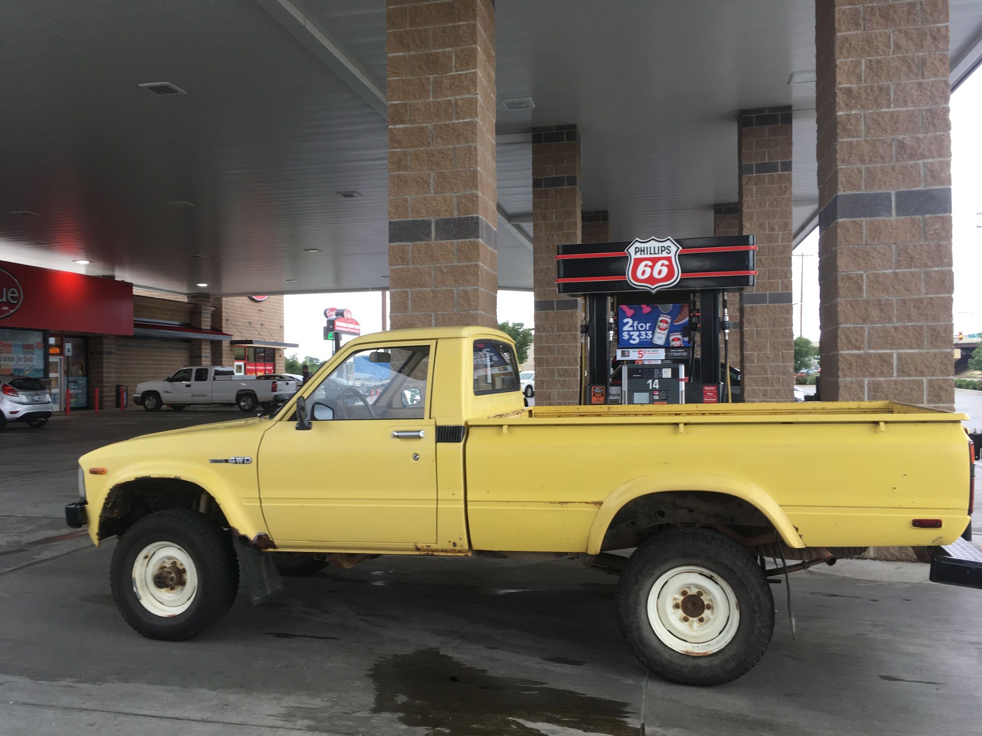

March 2020: Removed bed from frame – exploring resto options – (spent about 12 mos searching for painters – separate painters for Bed & Cab – used same Toyota Y541 ellow formula)
Replaced exhaust
New Cooper tires
Bed painted & Cab/wheels (stock white) painted separately
Sep 2021 put back together and inspected.
