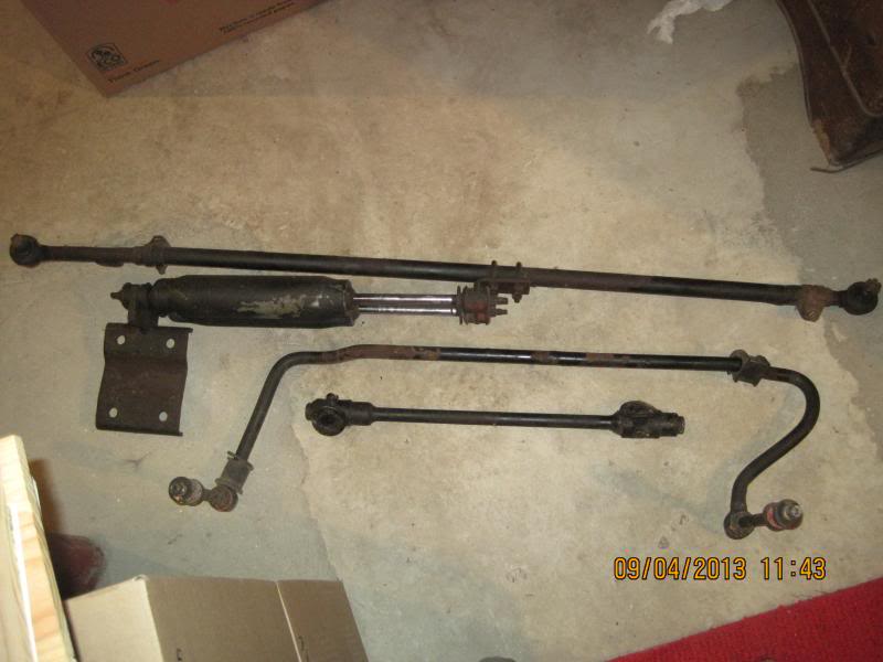

available 5" shackles, 18mm hardware available i believe
SFA parts as pictured available including rare dual stabilizer setup
