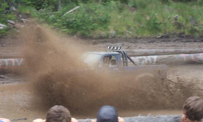

i need to replace or build a frame for my 82 yota 4x4, i need a cab as well, my truck is highly modified and i was wondering if a 2wd cab and front structural unibody piece were the same, i can deal with standerd auto cab differences no prob, also are the frames the same?? i think a 2wd has a smaller frame from the front of the cab back?? i hav no 2wd trucks near to compare to , if not i will probably build a frame from 2x4 steel tubing, thanks
Attached Thumbnails 2wd 4wd cab and frame compatibility??-splashing-boggs.jpg

Drink dispenser?
Old Dec 22, 2011 | 09:22 AM
muddy chevota's Avatar
Joined: Dec 2011
Posts: 43
yupppers
