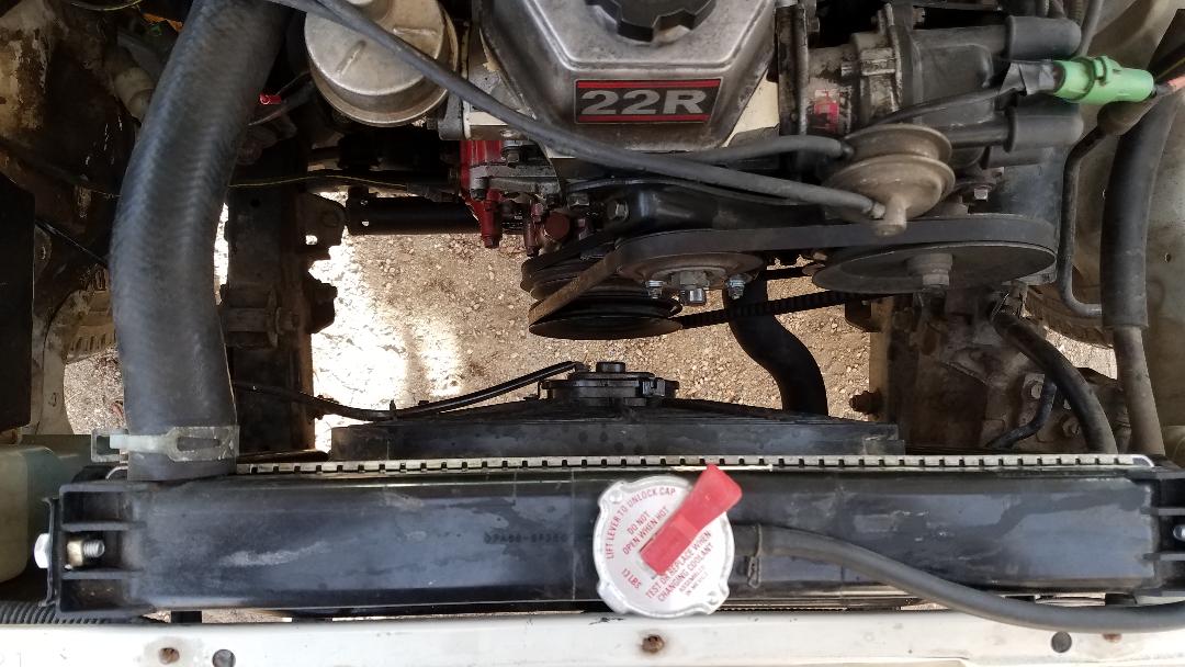

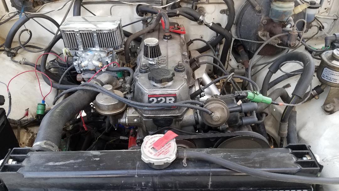

New Engine Overheat! PLEASE HELP!!!
1986 Toyota 22R Gen 3
I am having the same issue.
Overheats with any consistent RPMs when sitting still; cools a little when driving, but heats up whenever there is ANY load on it (uphill with no weight on it/not pulling anything).
The heat will continue to rise up to around 90% of the heat gauge. At that point, I pull over and vary the RPMs slowly and open the hood to let it cool, then limp it back home.
It also seems to be low on power, which makes no sense, since we have a built it to have more torque by replacing clutch and cam shaft.
There is also a small oil leak that SEAMS to be coming from the rear main seal to the
A friend rebuilt the engine from the ground up, stripped down to the engine core.
He was an SAE certified mechanic in the early 2000's and is meticulous to the point of ridiculousness.
Keep in mind, he trained to repair/build Subaru and Saab, but has since custom built several Honda, Ford, Chevy, and other vehicles. This is his first Toyota.
I, on the other hand, am NOT a mechanic, so I took notes as best as I could to understand what he did.
He took everything to the next level on this engine and spared no expense.
Additionally, he has more $ in the engine than I do, as I have promised him access to the vehicle at any time he wants, so there was no bilking for more cash going on.
Here's what was done.
- Tanked the core
- Machined all mated parts at machine shop
- Bored the old pistons out and did a custom port and polish
- Swapped cam shaft to RV cam from Toyota Shasta/Dolphin models for more torque
- New clutch - upgraded from 30 Lbs to 90 Lbs
- New pistons
- New valves
- New head gasket
- New head studs torqued to a max load of 90 ft/Lbs (studs were built for that torque level)
- New crank bearing
- New front/rear mains
- New header
- New water pump
- New fuel pump
- New heat sending unit
- New high velocity electric radiator fan (runs all of the time)
- New thermostat (OEM)
- New max flow water pump
- New radiator with 33% higher capacity than OEM
- New upper and lower radiator hoses
- New Weber 36/38 (not tuned yet)
- New fuel pump
- New EVERYTHING engine-related
- New fluids (coolant, oil)
I have had the timing checked as well.
I am at my wit's end and just want to get it FIXED!
Our next best guess is that the coolant flow is routed incorrectly.
If I understand correctly, here is how it is currently routed:
From the bottom of the radiator -> water pump -> through engine -> split some to heater core -> thermostat -> top of radiator
What should be my next move?
See pics. Did my best to follow the flow...
Attached Thumbnails 22r running hot as heck-engine-5.jpg   22r running hot as heck-engine-4.jpg   22r running hot as heck-engine-3.jpg   22r running hot as heck-engine-2.jpg   22r running hot as heck-engine-1.jpg

What is your timing set to? Did you replace or flush your heater core?
Old Mar 15, 2018 | 03:16 PM
bs_funkhouser's Avatar
Joined: Mar 2015
Posts: 6
OG Heater core, but it was flushed well.
why would a heater core overheat the entire engine?
In theory, I should be able to bypass it completely and keep the engine at optimal temp, correct?
I am at high altitude (6400 ft above sea level).
Timing is set at zero to get a baseline.
I didn't want to advance it until the heat issue is stabilized.
