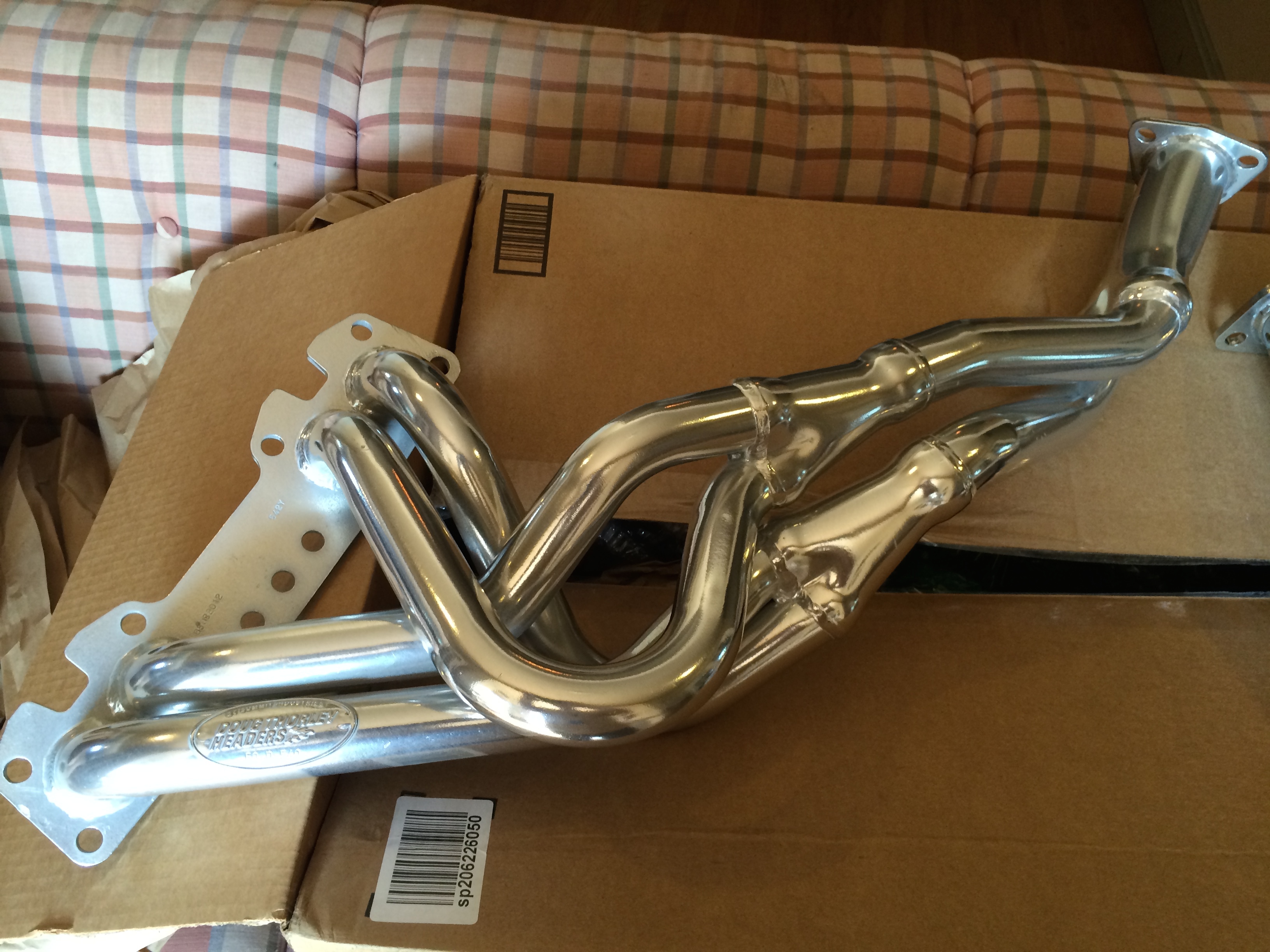

Got the parts today in the mail. What a glorious box it was to open! Can't wait to get started on this project.
I will be removing the stock manifold today and tomorrow, then installing the new Thorley, then driving it to the shop to have the exhaust system put on. =)
Had to pay full retail on the Thorley, but after 6 months of CL searching i figured this is as good as it gets. Bought the last one they had in stock too!
Any tips or things i should know before i start tearing in to the project?
