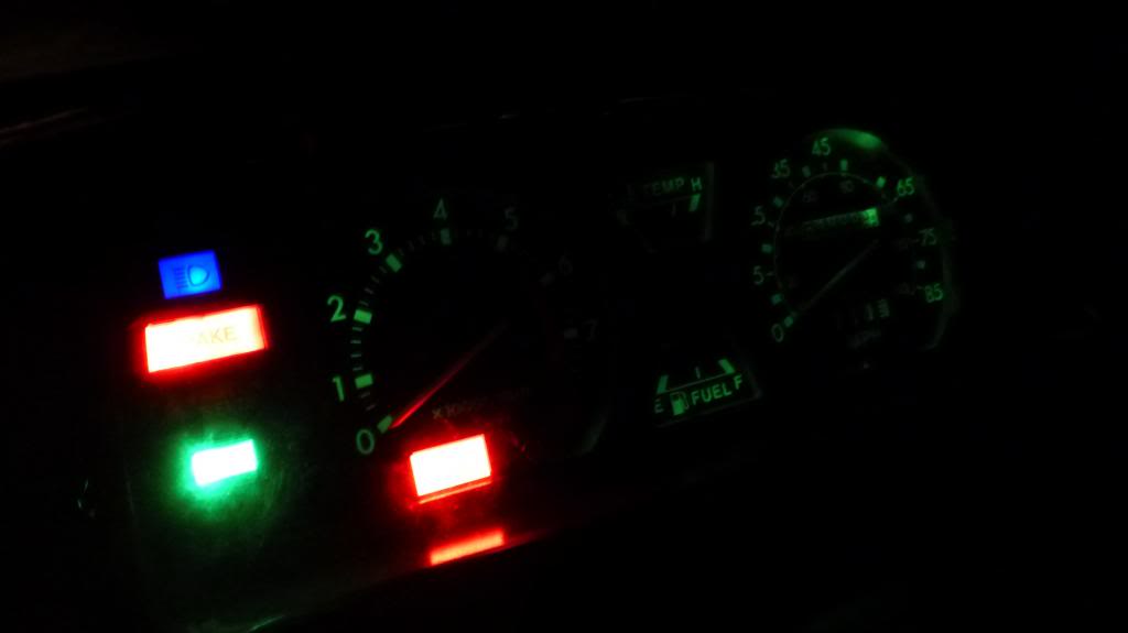

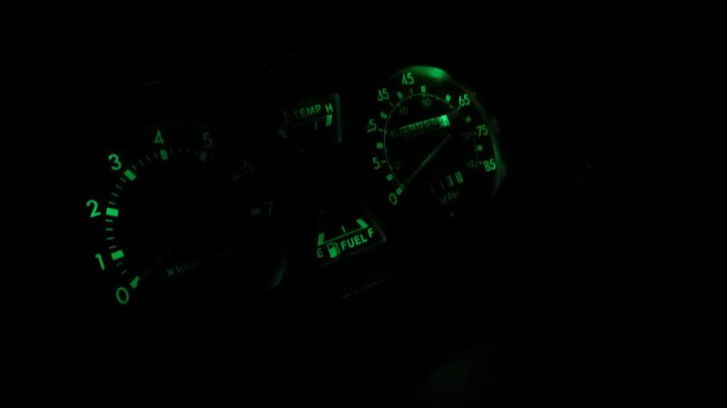

I've finally gotten around to pulling this little mod together as well. I decided to tear my whole cluster apart, paint the inside of it with metallic silver paint to up the reflectivity, and clean up some junky PO work (they put gun oil in the speedo, which gelled up and stopped it from working).
Anyway, thanks to DZ for introducing these little LEDs, they're pretty darn cool.
Just with instrument lighting:
I have to tinker with the right side of my revcounter, it's a little dim.
With the ignition flipped on:
I had my camera in night scenery mode, and these bulbs are overpoweringly bright to it. Additionally, the belt light timed out just as I took the picture.

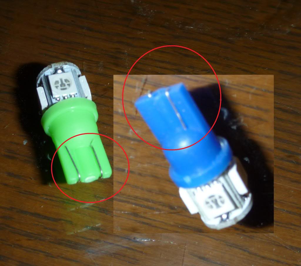

Finally, as a note for anyone pursuing this mod, see if you can find good pics of the LEDS before you buy, or purchase them knowing that some of the less expensive ones will only have a single contact per side:
The green one on the left has two contacts to a side. This means it can be plugged into any bucket anywhere.
The blue one on the right has one contact to a side, these have to be plugged in properly to positive and negative. I had a devil of a time getting all these right.
This should not be a dealbreaker, it just takes a little more effort to install them, but don't be discouraged if they don't light up right away!
