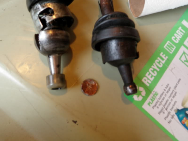

I made a tool like yours at work and pushed and twisted it off easily. Now I'm going to look for that white bushing I ordered from marlin that didn't fit my '83 2wd and see if that fits after cleaning it. My shifter looks like the one on the left in the picture of 2 shifters.

Funny thing is both shifters are out of L52's. The pic is from my build thread. The shifter on the right was missing the cap on the end. The smashed penny was the genius previous owners idea to fix it...pulled it out of an 83 on Craigslist. .

Ugh, smashed penny repairs kind of sicken me. Anyway; I can't find the damned bushing I bought, so I guess I'll be buying both again while I'm at it, and be making my own inner boot from bicycle inner tube as suggested on these forums, since I can't seem to find a factory replacement on marlin's website.
