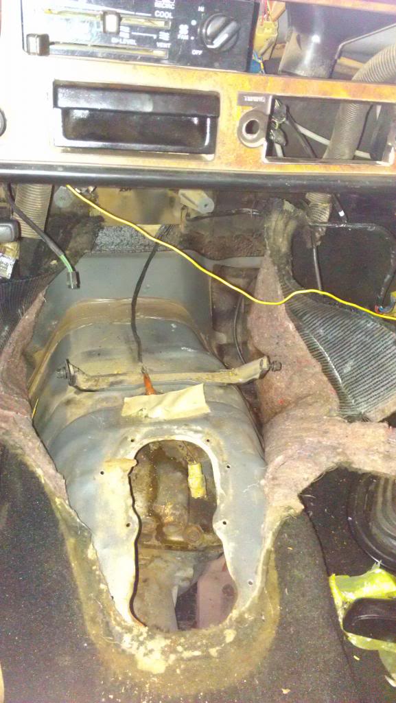

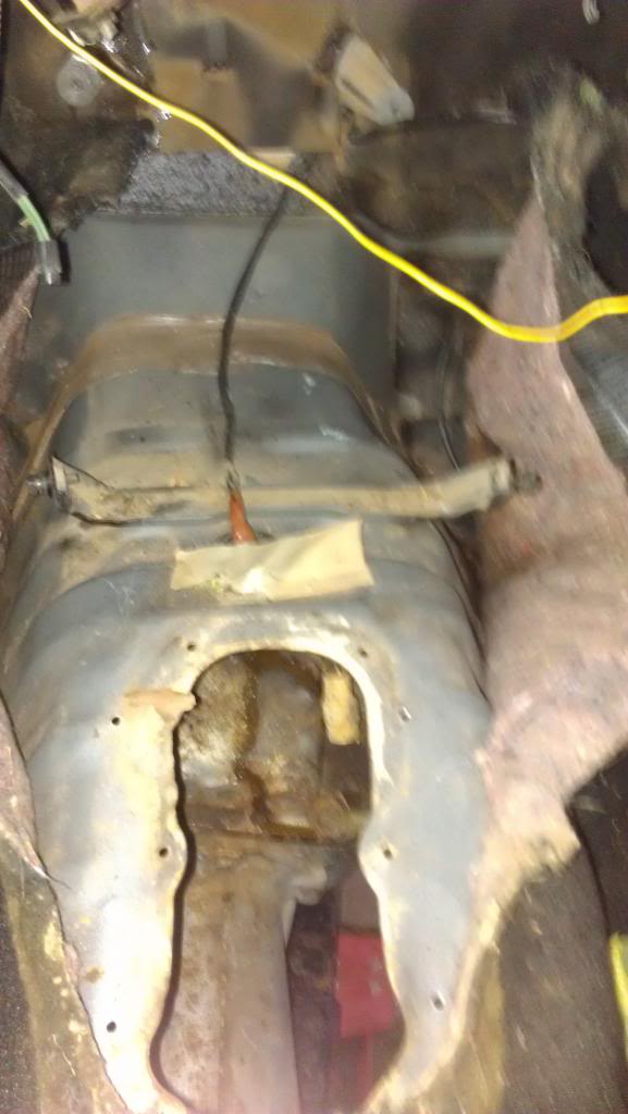

Today, we didnt get the tranny mounted just yet but we got pretty far. We got the heater box out and cut the shifter hole longer. As we jacked the tranny up, the transfer case hit the tunnel, so we had to cut a small square out. Next we'll have to cut one identical for the trans to come up some more. after we have that mounted we'll weld sheet metal over them to cover it up.

I'm back at college again this week, so more updates and pictures this weekend. Still waiting on the fuel pump to come in as well.

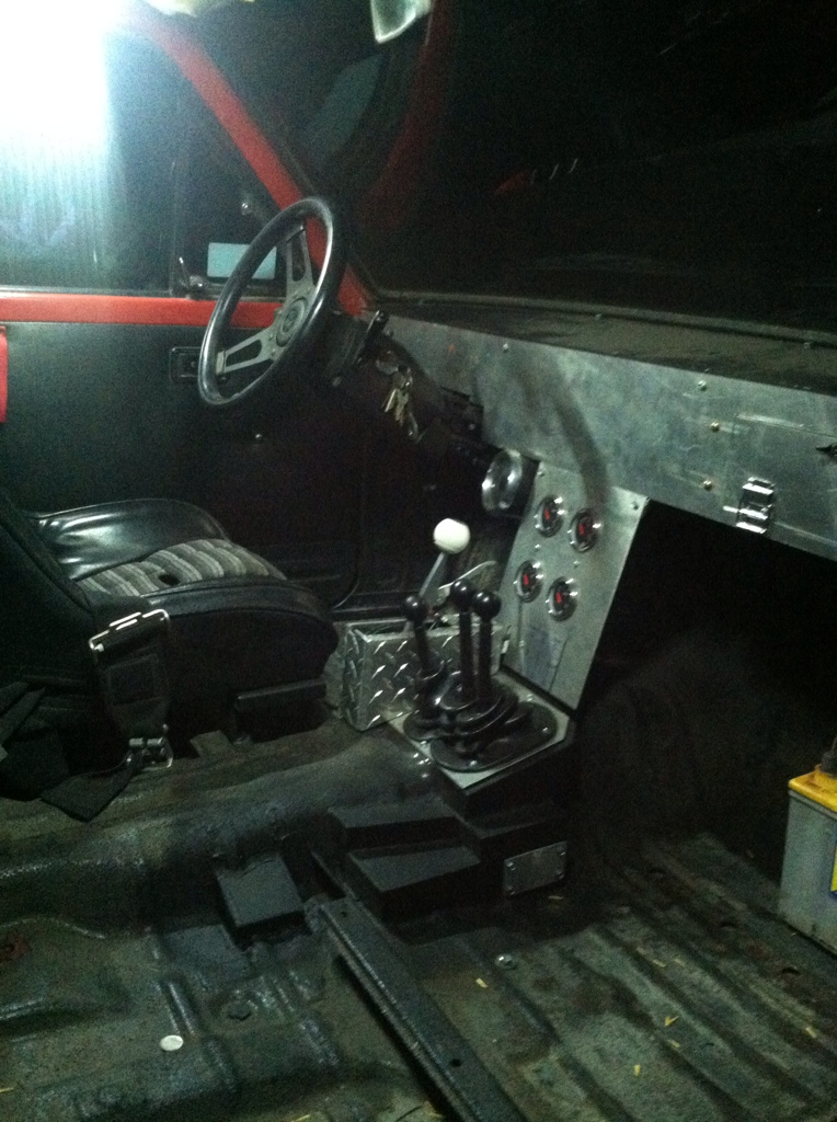

cstone94 I had to cut almost the exact same hole in my floor to clear the tcase right along the seat mount. Just boxed over it too.
Lovin that interior dude. I think I'll need to cut some more because the transmission + transfer case that were on the old crossmember from the chevy had 2 rubber mounts on between the member and the tranny. When we had it mounted we found out we had the crossmember 180 degrees the wrong way, and I also saw that we would need those 2 rubber mounts in order for the front yoke to clear the crossmember. Yay for cutting?

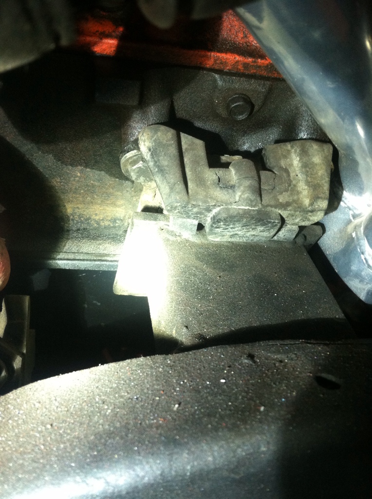

Here are mine I'm using. They been in the truck for about 5 years. Although I think I might go solid.
Here are my brothers. His has a solid mount off the engine to a rubber bushing at the frame.
