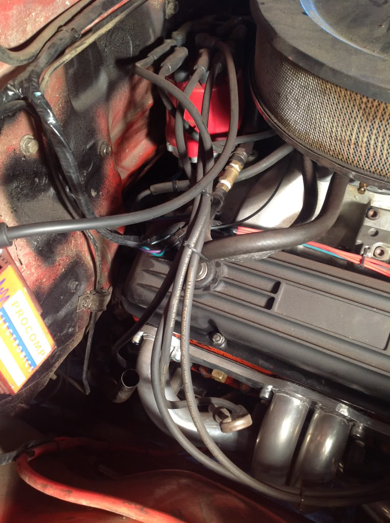

Hey Travis, do you have those engine bay pictures?
Old Jan 19, 2013 | 09:50 AM
  #34
travis_h's Avatar
Joined: Nov 2010
Posts: 301
From: matawa,wa

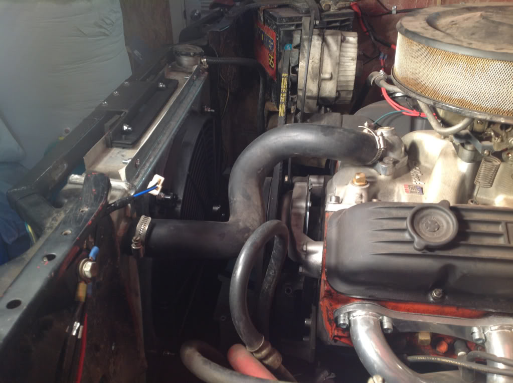

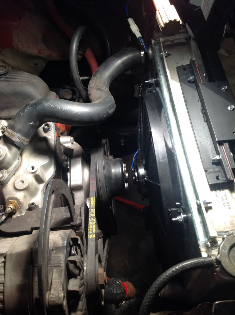

Ya I'll go take some today and post up for ya. And specific pics?
Old Jan 19, 2013 | 11:17 AM
  #35
travis_h's Avatar
Joined: Nov 2010
Posts: 301
From: matawa,wa

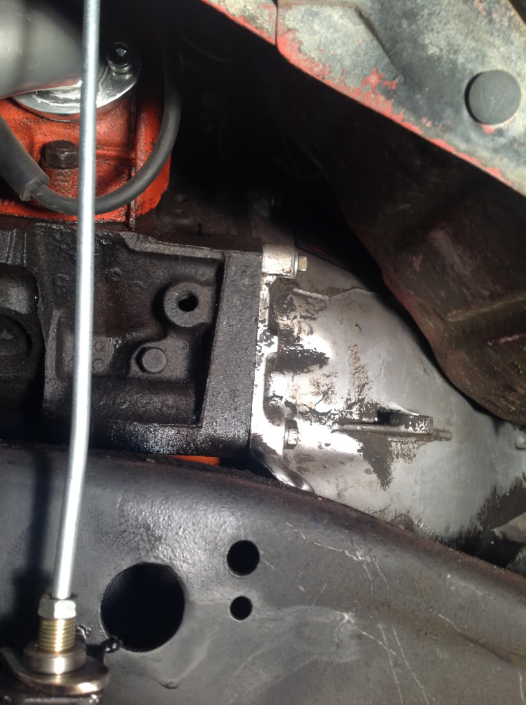

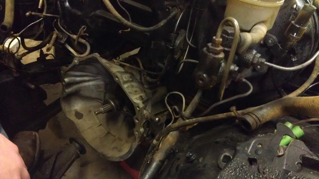

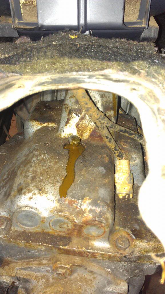

We're having some major fitment issues. The transmission is positioned where the crossmember holes line up.
How important is that box in front of the shifter hole?
Old Jan 19, 2013 | 09:51 PM
  #37
travis_h's Avatar
Joined: Nov 2010
Posts: 301
From: matawa,wa

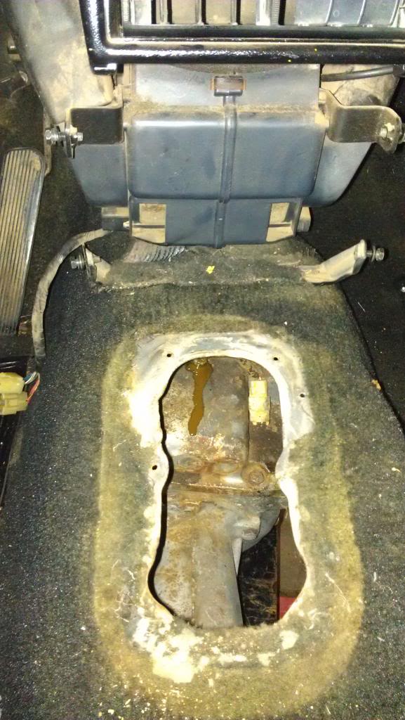

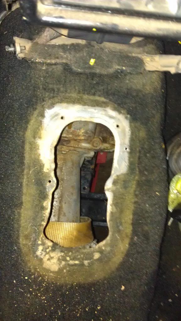

What tranny you running? My brother in law has a 4 speed sm465 in his yota with a 350 and the people who built it had to cut the floor way forward, cut the bottom of the dash and bent his shifter way back. We're gonna do a th350 swap later. It's parked in my driveway so I can post some pics of how his stuff is done too if you need.
Old Jan 20, 2013 | 06:20 AM
  #38
cstone94's Avatar
Joined: Jan 2013
Posts: 41
From: Martinsville, VA
I'm running the same trans. Please post some pics.
Old Jan 20, 2013 | 07:21 AM
  #39
travis_h's Avatar
Joined: Nov 2010
Posts: 301
From: matawa,wa
Between the two trucks i can get more pics of anything that i have here. The one in my driveway he bought as is and it has some good parts, but a lot of it is not finished or they just did a crappy job on it. He is in the process of getting the parts gathered up so we can start a total tear down and rebuild.
Here are a few pics of the inside how they did the shifter. It comes out under the dash, but the truck is a 94 so the dash is gonna be a little different.
I didn't get much pics from below because it sounded like you had the crossmember lined up. His has a different crossmember made of plate and angle. It needs to be redone when we go to th350. Also they just welded his crossmember right to the frame. Here is one of the crossmember.
