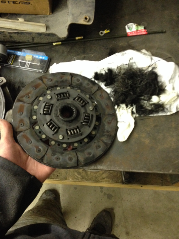

Put in a brand new autozone clutch and after one day of just crawling small hills it's completely worn down to metal. Could something be causing this, or is it just the cheap ass autozone clutch?

You resurfaced your flywheel correct?
do you ride the clutch?

Did you change the pressure plate?

Yes brand new pressure plate. And all bearings. I put back in a aisin clutch which I basically brand new so I'll see how it goes

[QUOTE=dropzone;52151253]You resurfaced your flywheel correct?
had mine turned once and they only machined the clutch surface and never did the mounting surface to match. clutch slipped and over heated everything ruined the fly wheel

My last clutch survived 3 transmissions and 6 years of assorted wheeling...

Didn't resurface the flywheel because it looked practically brand new. But sometimes you have to ride the clutch when climbing. Pulled everything off and had the new clutch in 4 hours later. Took it mudding tonight and everything seems to be fine so far

You will be so much happier with ur aisin clutch stop buying autozone parts. Instead buy used parts or toyota parts. When autozone says lifetime warranty that means u will be replacing it so much cause they will just give u one somebody else brought in and sell it to you as a new one.im glad u finally made a good choice.

if you fried your clutch in one outing .
I think you need to look at going double cases.
Even the Aisin clutch will be fried in no time.
Fly wheels are so cheap When a new clutch goes in a new fly wheel also gets installed.
I need to put a clutch in once for the life of the vehicle unless a clueless driver uses the truck then a new clutch is needed.

I also wondered if my 33" tires are to much for the truck on stock gears? Could that be eating the clutch up?
If your slipping your clutch all the time it will

That will help make it worse !!!
Ideal is being able to never ride the clutch put it in low low and first gear and just crawl along over pretty much anything.
