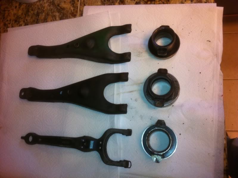

Originally Posted by 81Toy4x4
everyone i have talked to said it doesnt look like an l52 fork...
Top two shift forks were both pulled from L-52 equipped 1st Gen 4x4 trucks
bottom one is a L43 shift fork
a little more info on clutch forks from Big Mike of Marlin Crawler
Originally Posted by BigMike
Yes. All 1981 - 1995 clutch forks are interchangeable.
The main thing to note is that after 1980 Toyota ended adjustable clutches across the board in Hilux pickups as well as Land Cruisers. 1979-1980 L43 I believe had a return spring on the cast iron clutch fork which was only needed for the adjustability feature (today we can only adjust the placement of the pedal, but back in the day you used to be able to adjust where the clutch engagement point was along the clutch pedal stroke at the plunger for the clutch master cylinder independent of the clutch pedal's location). Starting in 1981 when Toyota released the 22R, they did away with this added adjustability and switched over to a stamped steel fork design that is still used today.
BigMike
Originally Posted by msane99
here is wht it is supposed to look like
the picture I attached is spot on correct.
you posted a picture of an L-43 side shifter - different fork, cylinder
