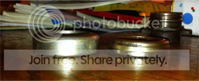

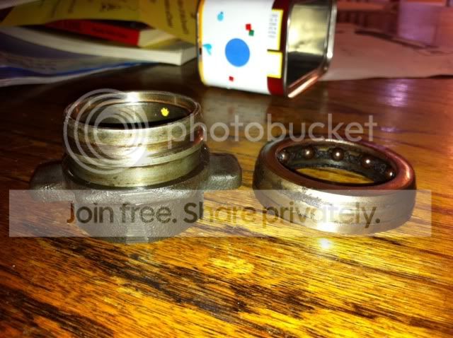

The bearing cup I just pulled from mine looks like the one you're saying is from an L50, except mine's an L45 (4 speed). Mine also had some other kind of throwout on it, there was a bearing race near the top of what looked like some kind of sleeve pressed onto the whole thing. Not sure what that thing is.
On the left you see the "new" bearing (for an '83, probably L50/52?) On the right the old bearing (I had already taken it off the spindle, so you can see the BBs)
Here is the bearing separated from the cup, with what I think is a sleeve still pressed on.
And finally the 2 bearings side-by-side

Yes. All 1981 - 1995 clutch forks are interchangeable.
The main thing to note is that after 1980 Toyota ended adjustable clutches across the board in Hilux pickups as well as Land Cruisers. 1979-1980 L43 I believe had a return spring on the cast iron clutch fork which was only needed for the adjustability feature (today we can only adjust the placement of the pedal, but back in the day you used to be able to adjust where the clutch engagement point was along the clutch pedal stroke at the plunger for the clutch master cylinder independent of the clutch pedal's location). Starting in 1981 when Toyota released the 22R, they did away with this added adjustability and switched over to a stamped steel fork design that is still used today.
As for the 1981-98 bearing cup, which Toyota calls a bearing hub, they are still being manufactured by Toyota and are available here: http://www.marlincrawler.com/clutch/...release-collar
