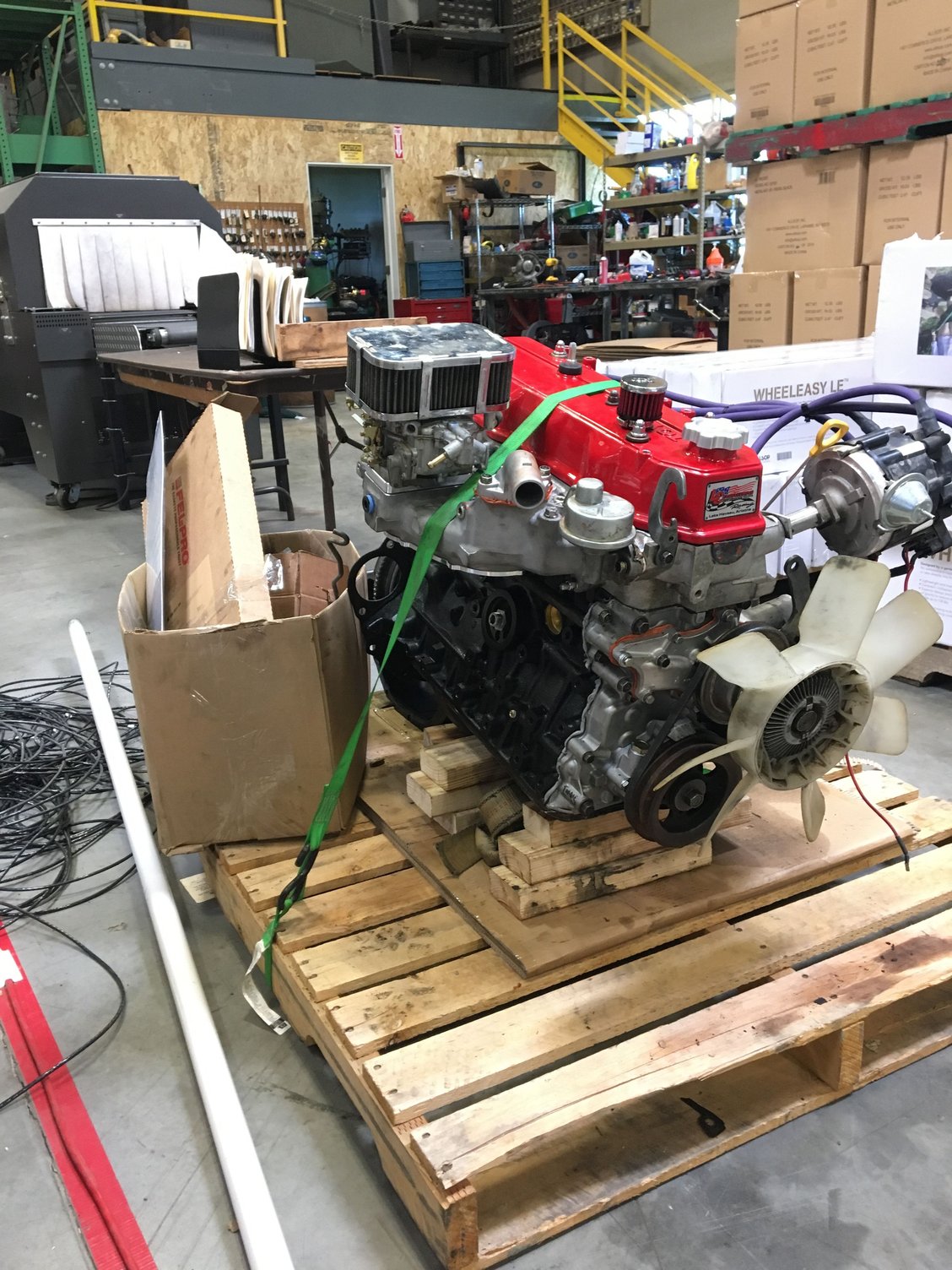

Update on the Build (or re-rebuild if you will):
I may have gotten super distracted when I stumbled upon a 96 Cummins 12 valve for an obscenely low price and got caught up in building that up but alas I refocused on the holiness that is the yota am about done on my 22R...finally. Had a real fun time learning all the tiny differences between the 20r and 22r such as differently tapped motor mount bracket holes, different alternator bracket mounts, different oil pump drive splines ect. But had a few happy surprises as well (the aftermarket Pace Setter Headers I bought are compatable with both the 20r and 22r). I also learned an important lesson -- If you buy a metric poop ton of new parts all at once -- organize them and put them all in the same place, for the last two months I have been just discovering new parts in various places (for instance a new slave cylinder and pre-
bent hydraulic line in the insulated tools drawer of my tool chest) and having the "oh yeah I forgot about that, probably should install it" moment.
I have the engine entirely built, just need to weld up a mount for my alternator bracket that I can bolt to my block, drill out my one of my motor mount brackets to fit the proper sized bolt for my block, and slap in a new pilot bearing and im set to throw the clutch on and put bolt the tranny up before stabbing all the goods back into the truck. After that its just a few hydraulic lines (funny story I forgot to unbolt the slave cylinder when pulling the engine/tranny this most recent time and destroyed the line via a 10000 pound forklift, ironically enough it too was a yota) and some good old electrical and its off to the races. If there are any 22r whispers in the N. Colorado/SE Wyoming area that like working for beer Im sure I will need plenty of help getting the "Stumble Bee" dialed in over the next few months.

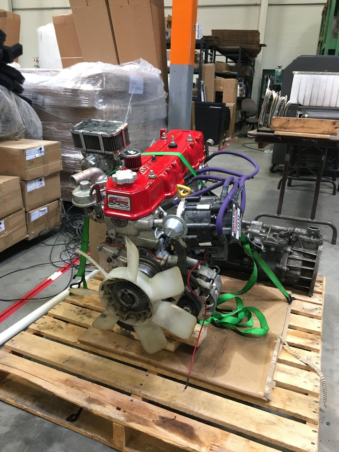

Old Jun 25, 2019 | 08:58 AM
WyomingDan93's Avatar
Joined: Feb 2017
Posts: 6
From: Laramie, WY
More pics

So I finally poked the engine tranny combo back in today to mixed success. The engine slid right onto the motor mounts no issues, however I am having a hell of a time getting the Transmission to spline with the Transfer case. The case seems to be tilted at a 15-20 degree angle facing up and i cannot for the life of me get the transmission to mate with it. I tried ratchet straps, jacking the engine up the force the transmission end down, 6 ton floor jacks, pallet jacks, forklifts...you name it I tried it today. Is it worth just pulling the engine/tranny and dropping the rear driveshaft pulling the transfer case and assembling them outside the vehicle and re-installing as one unit? Also has anyone ever mated a late 22R ('91 I think) with an early series transmission (82-83 5 speed 4x4 L52 I believe?) The way the engine was sitting on the motor mounts it almost looks like I am going to be a couple inches short. Id like to not have to take a plasma cutter to wallow out the motor mount holes to accept shorter block but at this point it is what it is. Thanks!
Old Sep 4, 2019 | 06:34 AM
Joined: Feb 2017
Posts: 6
From: Laramie, WY
After playing the worlds heaviest accordion and doing some redneck yoga poses I finally slid those suckers together after a 3.5 hour battle. My original suspicion that the motor mount holes wouldnt perfectly line up was realized and it looks like ill be torching those out today. Just gotta slap the radiator back in, refill fluids, hook electrical back up and put the starter in and I should be all set for carb tuning and timing.
