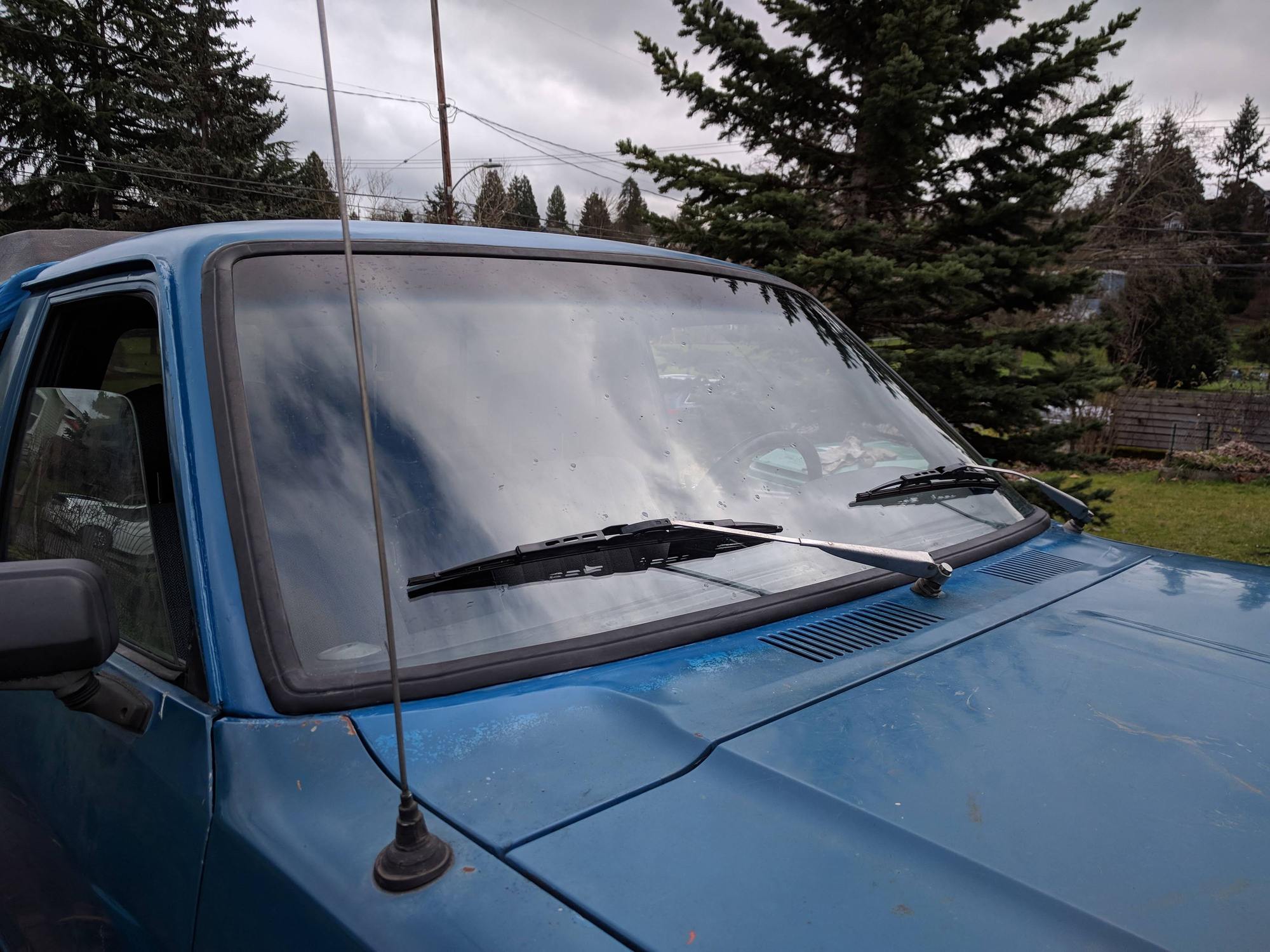

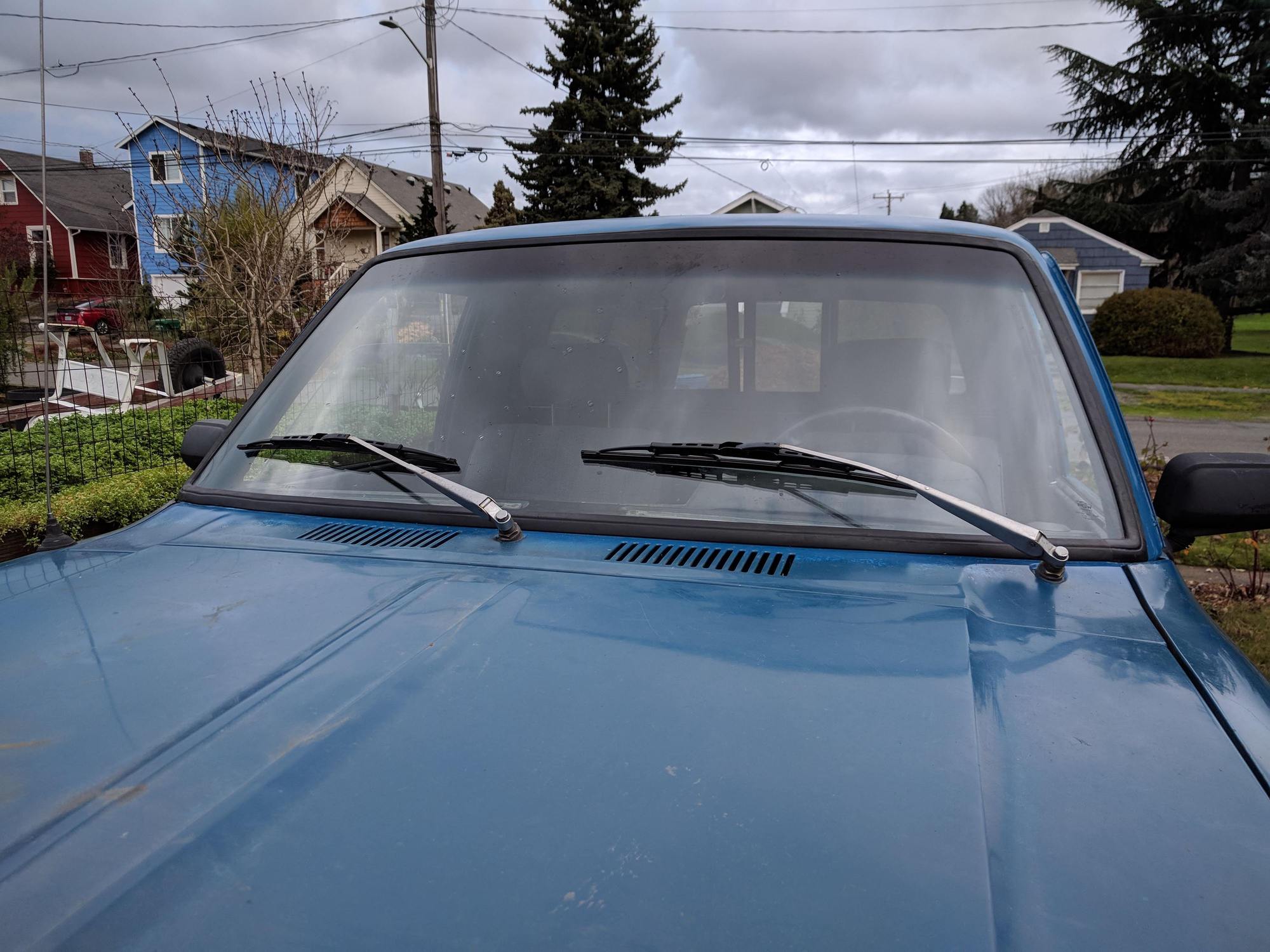

All wrapped up. Got the glass in place. It took a few tries (I'm not telling how many ) for my wife and I to get everything just right. Ultimately the solution was to use a modified rope-in install. I could not get it to work using a single piece of rope. The force of pulling the rope out caused the windshield to shift, even slightly, so when I got around to the final side it was no longer lined up in the opening. I tried starting at each side with the same results. The solution was to use four pieces of rope, each starting in the middle of the side. Pull a few inches on top, then bottom, right, left, repeat until each side was done. Then I did the opposite corners. It worked great, the glass stayed exactly where I wanted.

I had a couple of small leaks along the pillars and/or top corners. So I decided to try and pump some liquid butyl under the edges of the gasket as per the fsm. I used CRL1716 Windshield and Repair Butyl Sealant and the pump that attaches to the can. I read quite a bit about it and that is what a lot of people use for these type of rubber gasket installs. This stuff is insanely difficult to work with. I had to heat it up to about 150F in a pot of water. Apply a couple of feet, repeat the heating process and repeat until I made it around the windshield. It is very thick and does not flow well.
It sat overnight and today in the rain the leaks are numerous and far worse than before. So I am at a crossroads. I could try and pump some more butyl in there. Or cut my losses, pull the glass and start over. I am resigned to starting over, I just don't want to repeat my mistakes.
Thoughts? Anyone have advice or experience?

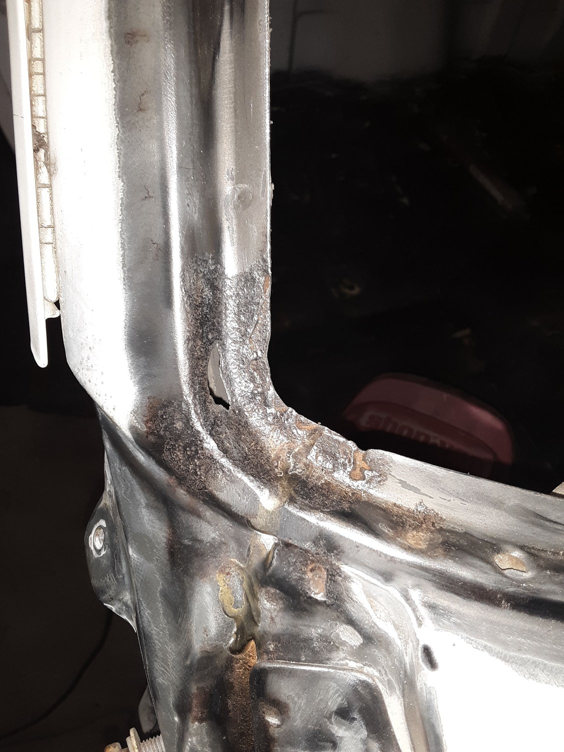

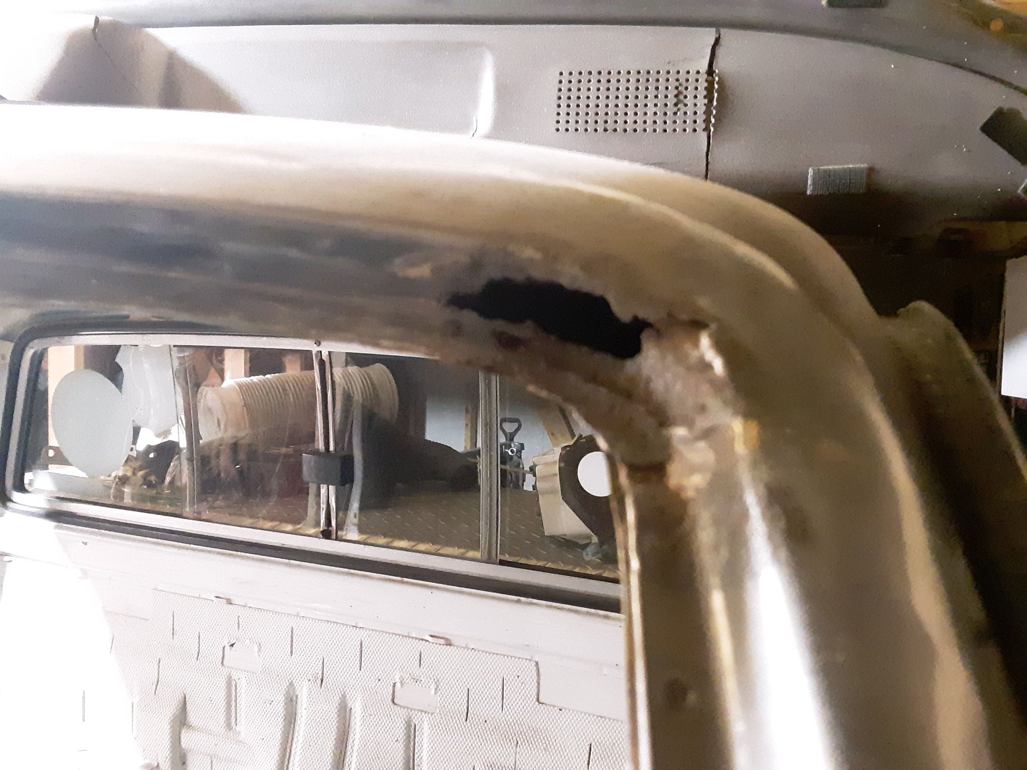

These were the only two spots I found when I pulled the window on Thursday night. I had to do a few patches on the floor last night, not sure what I'm going to do about these yet. I don't have any experience making patches for corners, but I got a small sheet of 22ga to give it a shot.

How did you make your corners cascade? I was thinking about folding a section of sheet to match the angle of one of the straight frame sections, then cut relief wedges out of one side to make the corner. It will make more welding for me but I think it might work.
Listed in the tools above is a metal shrinker/stretcher from harbor freight. This lets you create these curves by shrinking the inside of the corner and stretching the outside. So the outside of a corner becomes thiner than the starting guage and the inside of a corner becomes thicker.
Correct. I used the HF shrinker stretcher tool. I cut a strip then bent it into a L and worked it on the shrinker stretcher until I got the shape I needed. I watched some YouTube videos and gave it a shot. There is a learning curve. I threw out quite a few pieces before I got the hang of it. Some of the tight corners I did in a couple of sections.
Mine was rotted out in those same spots. Yours definitely looks repairable. Unfortunately those were the most difficult spots to make patches.

I ended up making each section multiple pieces, but its all patched up now. Haven't done the bondo yet though.
