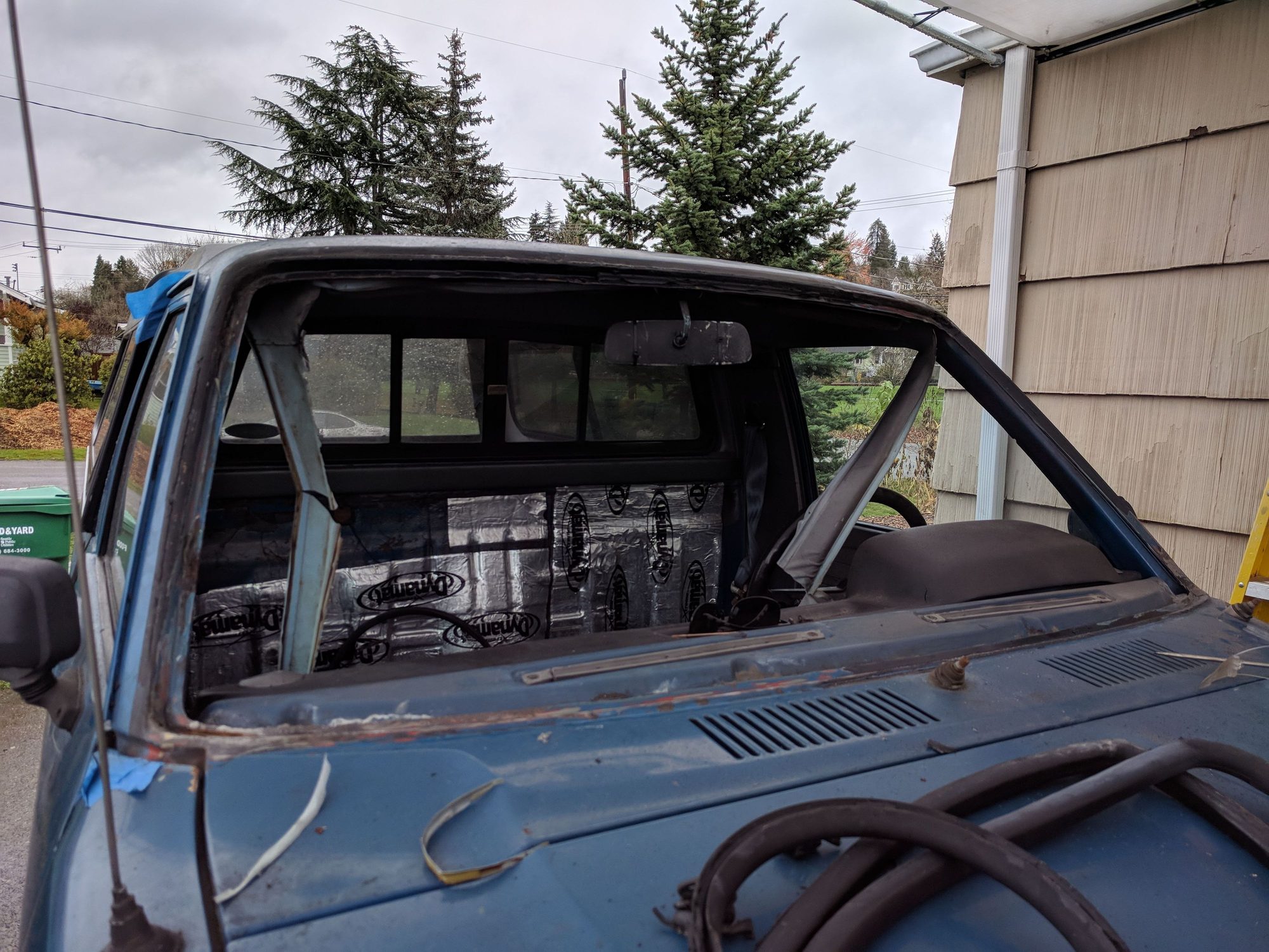

I thought I would start a thread detailing my adventure repairing my leaking windshield. This is my first time, so I'll have many questions and please comment if you see something wrong!
The project began as a gutter reseal job, then turned to the floor pan holes, then to the cowl rust and finally onto windshield removal and rust repair. Talk about project creep.

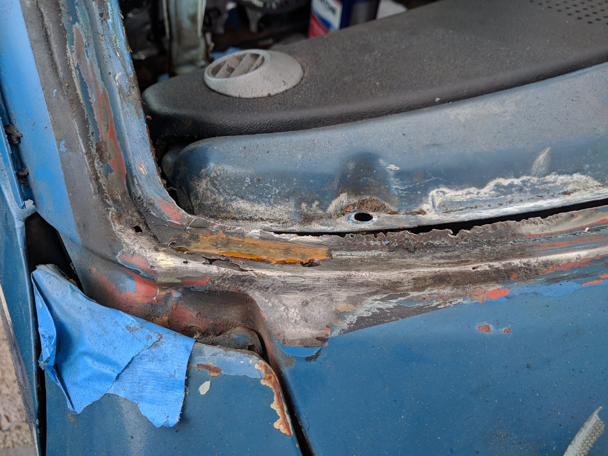

The existing windshield was FW397 with a rubber gasket. No trim. It had been replaced sometime in the past. I removed the windshield glass and hope to reuse it. There are no chips or scratches. There was some plumbers putty type stuffed in various locations and the gasket was siliconed to the glass. There was pretty heavy pitting in places that had been primed over, some holes had been welded shut. There were several new holes and areas of active rust, particularly near the bottom passenger corner.
Here is my plan:
-Wire wheel and clean the channel
-Replace the worst sections with new 20ga steel
-Fill and sand pitted areas with All Metal Body Filler
-Epoxy prime the channel
-Reinstall glass with new rubber gasket
Ready to remove

Diver's side lower corner

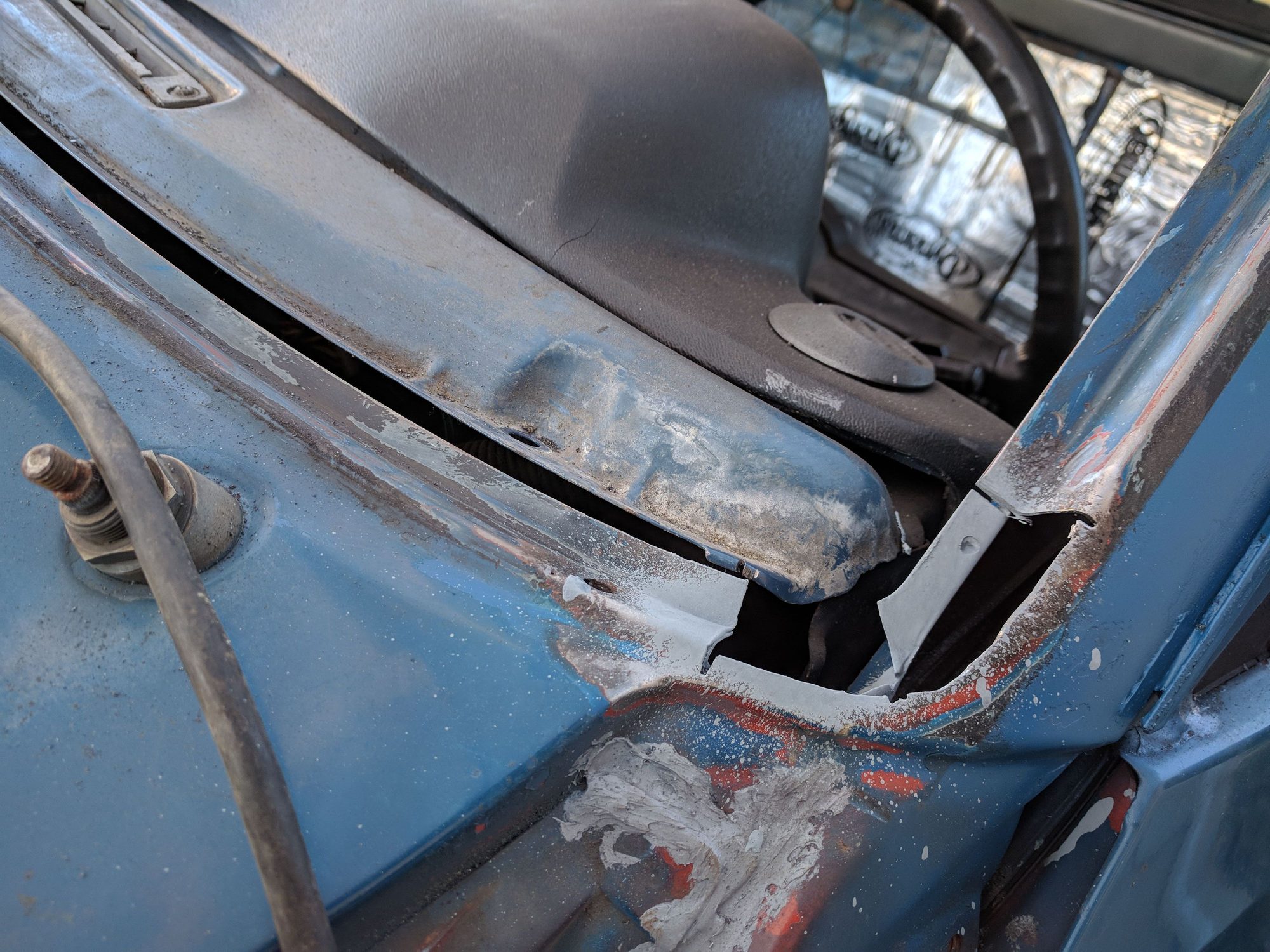

Passenger side lower corner

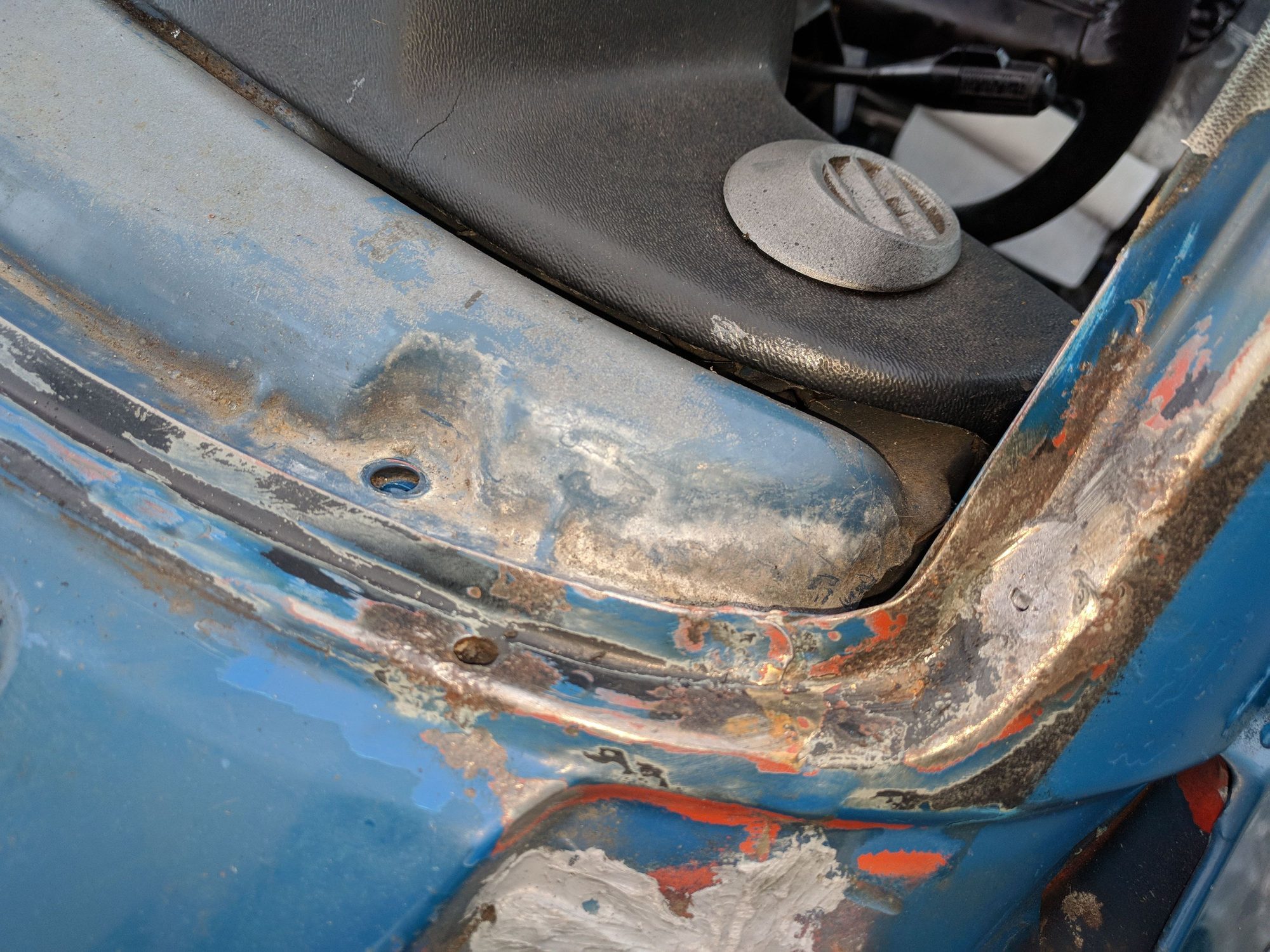

Patch in progress
Patch complete

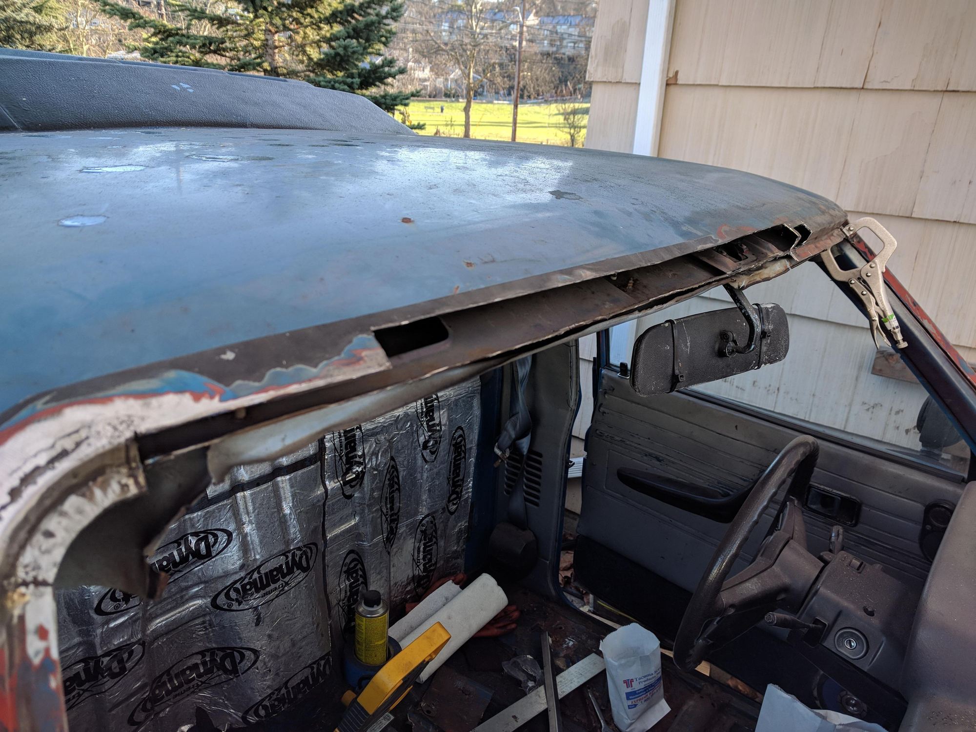

Making some progress. Finished up the new metal parts. Ended up replacing three corners, some of the bottom at the passenger and the entire top and about an inch of the roof. It went all right, the geometry on the roof is a little off, hoping some all metal filler will smooth it out enough for the gasket. Time will tell...

Made some more progress. Got some all metal filler in place. Things are starting to smooth out.
