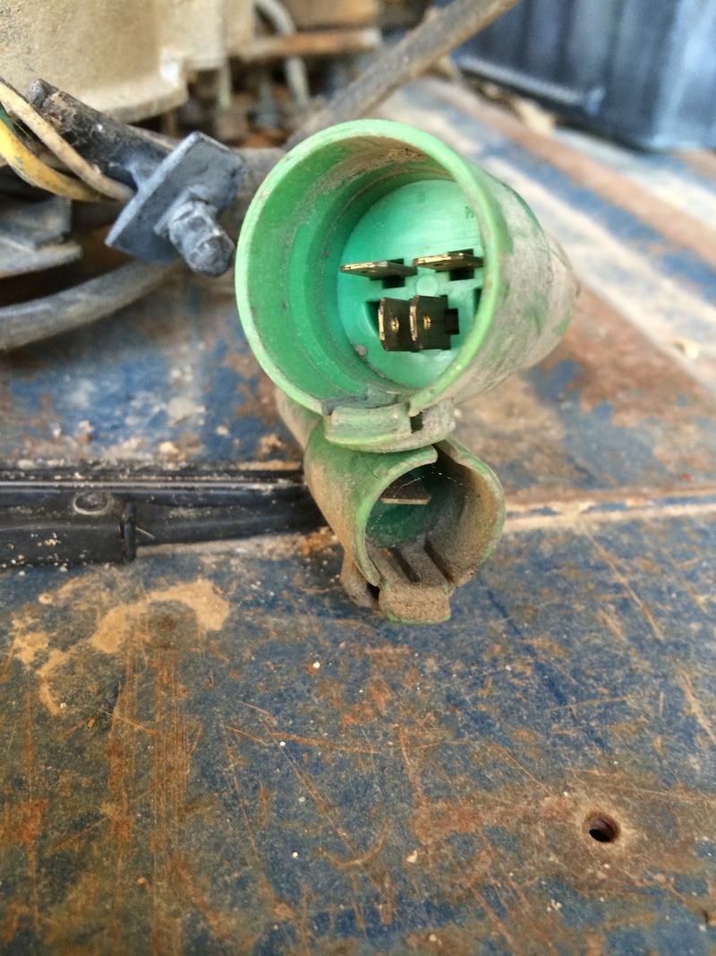

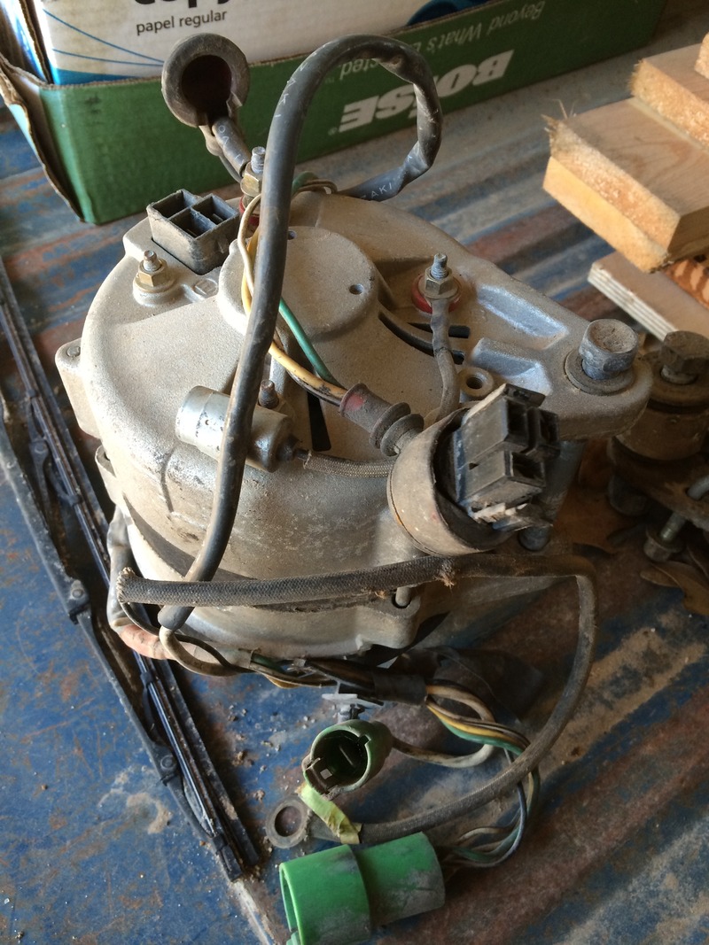

Maybe these pics will help you
Size:  254.9 KBName:  4354C090-8EF8-4A63-88E4-C93337F37190_zpspgfmbps3.jpg
