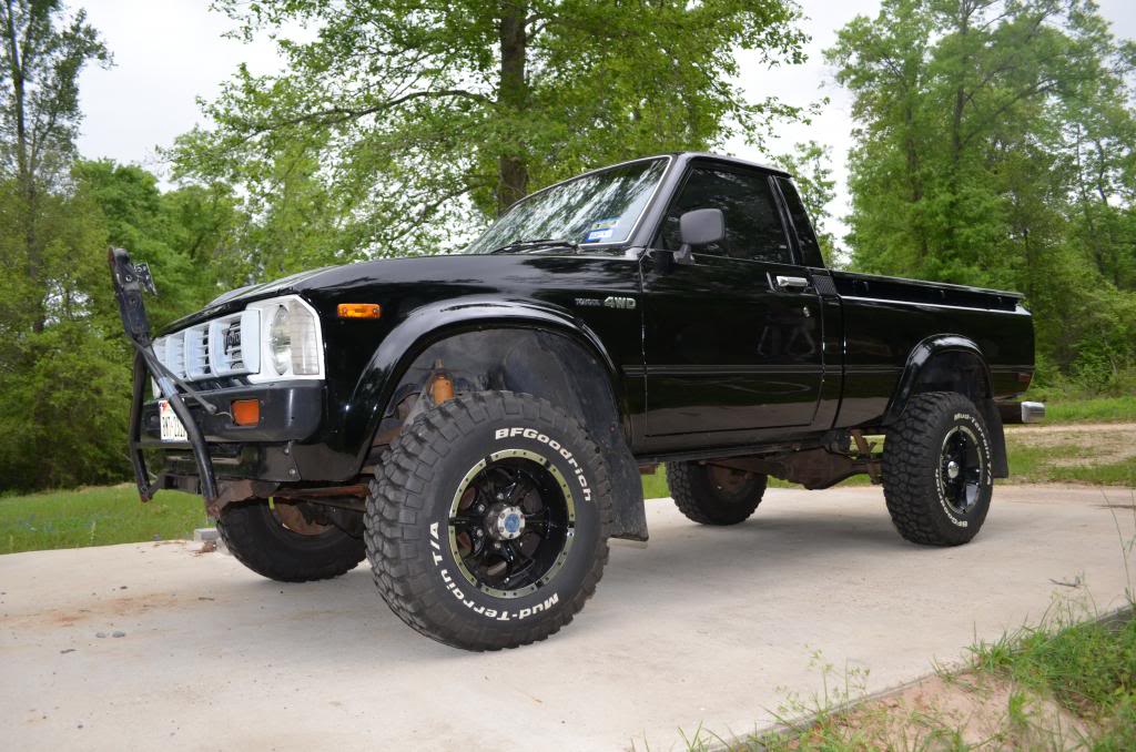

Well first off let me say that this is a great site. Lots of nice trucks and lots of info. I've got a 79 Toyota in really nice condition but I'm kind of at a crossroads with it. I bought it for a secondary vehicle so that I don't have to drive my dually all the time. At times parking it can be a real pain!
I've always been into the 4x4 scene but this is my first Toyota. I love the truck but at times it really just doesn't have enough power. It seems to like to run around 60 mph. 70 is really pushing it, especially with the a/c on. And with the new speed limits at 75 seems like I'm spending a lot of time on the shoulder of the road letting cars go by. Some friends of mine tried talking me into a v8 conversion and I gave it a lot of thought and looked around on a lot of forums but people really seem to like original toyotas. So I hate to go modding mine all up. I know the choice is up to me but I guess I'm looking for some advice.
Is there mild mods that will help the 20r have more power? Should I look to sell it and get something to better suit me?
It's not a off roader. I mainly use it to run around town and such. I tried pulling my 17 ft aluminum boat once but that didn't work out so well. Anything much bigger that a lawn mower and the truck just has a hard time.
Anyhoo, any thoughts or comments would be great.
The truck is stock with the exception of the tires and wheels.

If you can't cruise at 70 then there is a problem. Is the truck a 5spd?
I'm not sure how much more power the 22re has over the 20r but my larger heavier 85 xtra cab on 35's can cruise at 70 all day long and still has some power to spare.
It kinda sounds like you need a rebuild or new engine.

if you put larger than stock tires on that beautiful truck it could be part of the problem. numerically larger geared third members could help.
check your factory plate on the firewall for the gear code and look into getting new-used third members.
as stated, what's the mileage? it might need a refresh.
good luck and I wouldn't do anything drastic to that truck. and i'd keep all the original parts in a box when you mod anything.

I have to agree with PHILDELFINO, most of your problem is gearing. When you install larger tires you have to compensate for the change with lower gears to keep the engine torque / power curve close to where it was before the change. The 20R has the best head of all the 20 /22 R series motors.
As far as motor swaps, I would not do it. I thought about that change also looking at putting a V8 motor in mine. I decided on a LC Engineering stage 5 pro-stroker along with some of my own engine mods (I do not like people passing me at times) and I have plenty of power plus reliability.

I would recommend regearing it as well; however, your increase in tire size isn't truly all that drastic. The stock tire size on those truck was in the neighborhood of 28.5x9 or so. You're really not pushing much larger rubber with 30x9.5. The 4 speed tranny does pull down your top end a little bit, but it should still handle 60mph easily and 70mph at a mid range RPM.
I had a similar problem with my 83 when I bought it, but it was much worse - my truck wouldn't go much faster than 50mph in 4th gear and wouldn't even pull 5th gear at all. It had some heavy 33" tires on it, but that wasn't the problem. At some point the previous owner decided that he knew how to work on a carb and adjust the timing. My timing was retarded about 5 degrees and every adjustment on the carb was completely off! I was getting about 5-8 MPG and no power before I adjusted everything and got 17-19 MPG and even chirped some big ole 33" tires after I adjusted everything. Then later got a weber and desmogged for even better results. Now I'm rebuilding and restoring everything.
What I'm getting at with that rant is try the little "free" stuff first - Timing (there can be a lot of power loss with poor timing), carb adjustments/cleaning, ground connections, compression, etc. Then go to the more costly/involved modifications like installing a weber or new gears. There is no reason that the infant motor you have shouldn't be able to pull on the high end unless your rings are burned up and you have no compression.

You're truck probably has 4:37's in the diff's, without an overdrive you're probably pushing 2500 rpm at around 60-65mph. I wouldn't expect the truck to wanna cruise at 75 mph. If anything the 30 x 9.5 tires are helping you at top end speeds.
