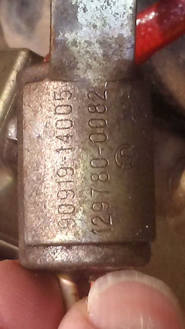

Here are some of the 1977 Chinook ignition wiring photos.
Old Oct 9, 2020 | 07:42 AM
  #53
slv's Avatar
slv
Joined: Aug 2020
Posts: 9
The labels for the pictures did not go thru. First is taking apart the coil assembly. 2 is the condenser that sits next to the coil 3 and 4 the fuel pump relay 5 what I am calling the igniter sitting on top of the coil bracket. You can also see the blue separator for the 12 V camper system. It is a Dodge part. and the last one shows the difference in size of the distributor wire connection to the coil the original Nippondenso on the left and the NGK on the right. The wire boot would not go on. Plus it does not say for use with an external resistor. It is not the one that is shown on their website for that number. The U12XBlue Streak from Standard Brand is a very tight fit. I had to pull the connector end out of the cap to insure it was connected properly. .And a side note to proper fitting I bought a new rotor for the distributor at Advanced Auto which was same exact
Duralast that I have made in Mexico and it did not fit! It was too tall and so tight I was really careful pulling it back off again...I certainly appreciate all the input i have received. I have more photos to post.. I have to send them to my daughter to post and i will do that later today, 4 hour time difference between us. So I have spark with the new coil. The points which I did have replaced once look brand new. There was a little bit of dirt in the grease at the rubbing bar but slid a cardboard business card thru and it cleaned up. I need feeler gauges tho to be exact. I am going to go back thru with my testing. Make sure I have my settings right for what I am testing. I have a little experience in car repair replaced a starter and power steering pump in a jeep. Did the breakdown to replace a timing chain in a Courier to cut repair cost. .But none in electrical. My one advantage is that I realize when something is not right and get it taken care of so I am not broken down on the road. Learned thanks to Walmart auto centers how to change my own oil when one of their attendants didn't put on a new filter. Which was a good thing because now my cars last til 300K miles. I have all the orignal maintenance manuals for this 77 Chinook so if anyone needs me to look something up I can. I had to take time out to get online and search for another vehicle. 4x4 for under $7K within 75 miles of Denver. Pickings are pretty slim right now. Base Toyota pickups especially. To be continued. Gotta get back under the hood again and get down to specifics.

I see this post is 15 months old. I have a 77 Celica that needs a resistor. has 2 eyelets that will have to be soldered. I just ordered the resistor from Mouser and it doesn't look like the one pictured in the post.. Mine that arrived today looks like this: I will try to post a pic. This one has HS10 1R5 F printed on it. It is 10W 1.5 OHM. The pic in the original post is threaded with a nut and lock washer . Is this the correct one? Thanks for your input.

The resistor you received will work just fine and is the correct one. It is obviously an aluminum-cased power resistor rated at 10 watts, which was the original wattage spec. Original Ohm spec was 1.4 but a 1.5 Ohm resistor will not cause you any issues.
The type/style of termination (terminals) really doesn't matter, as long as you can securely install the resistor into the circuit with good contact. In fact the "eyelet" style of resistor you are showing in your pic will make soldering it to the existing wires easier.
For clarity and for anyone else reading this, the original picture I posted of the Ohmite HS10 1R5 F resistor is a catalog "stock" picture from Mouser's product listing here: https://www.mouser.com/ProductDetail...WgobfMBw%3D%3D
If you look at the specs for the part, it does specify that it does indeed have "solder lugs" on it.
