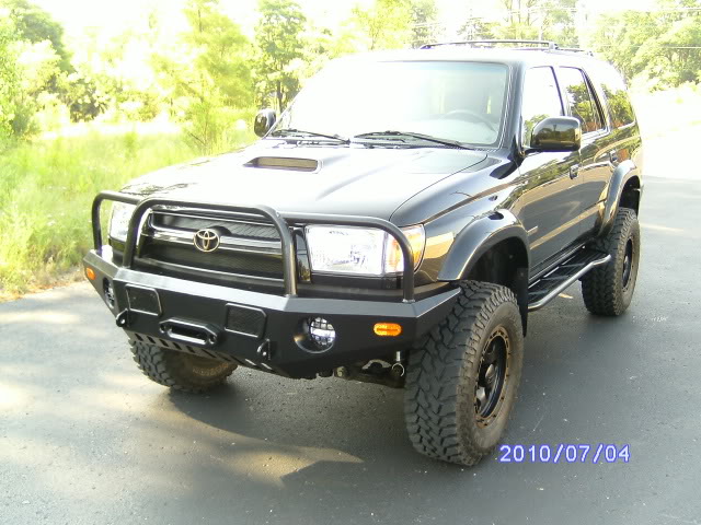

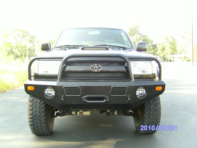

Build your own Bandit Bumper (3rd gen 4Runner)
I am selling custom front and rear bumper plans based on the bumpers I built for my third gen 4Runner. The front bumper mounts and winch plate are 1/4” thick steel. The front bumper mounts directly to the 4Runner frame, using a total of 14 bolts. The frame rail ends will need to be cut off, similar to mounting an ARB bumper. These bumpers are designed to fit all standard (non integrated solenoid) 8-10K winches. I will provide you with all necessary information in order to build your own bumper. This includes:
- Detailed component and assembly drawings
- CAD files
- Materials list
- Step by step build instructions with pictures
Your front bumper design can be customized in the following ways at no extra cost:
- Body lift height (Eliminate that ugly gap between the bumper and body)
- Flare width (Match your bumper width to your flares)
- Hoop Design (Standard, PreRunner, Center only, none, etc)
- Material Thickness (Keep it light, or go heavy duty)
- Fog/driving light openings (round PIAA, square Rigid Dually, none, etc)
- Turn signal openings (round, oblong, none, etc)
Front bumper pics:

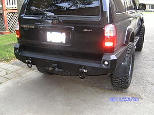

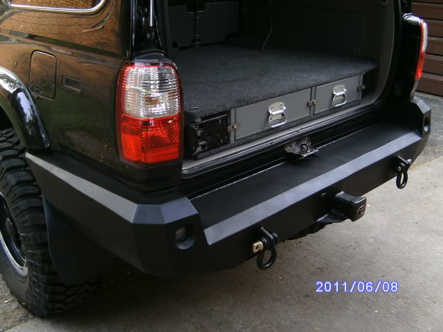

I am also selling the rear bumper design, as many of my customers have been asking for this for quite a while. The rear bumper also uses 1/4” thick mounting features, and uses 8 bolts in which to mount it. It also has an integrated 2” receiver. Customization for body lifts and flare widths are also included.
Rear bumper pics:

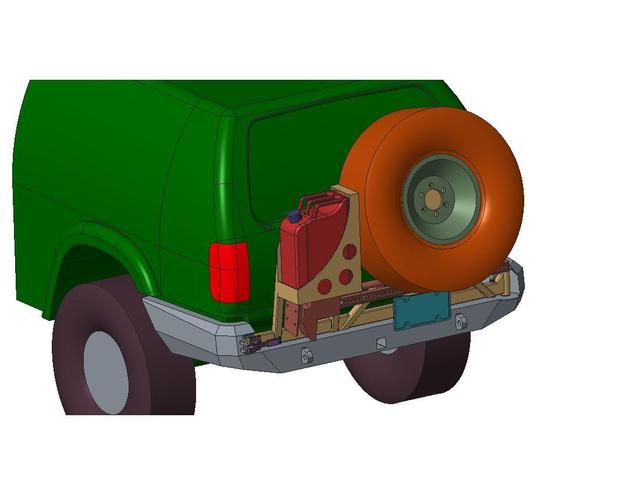

I also have several swing-out tire carrier options for the rear bumper. I have both single swing-arm designs and dual swing-arm designs. Options include ladder, 5-gallon jerry cans, Rotopax cans, Hi-Lift jack mounts, or custom items.
Single swing-arm pics:
Dual swing-arm pics:

Sorry this isn't about the bumper, but I love that storage tray in the back! Any good write ups on how to make one or where to buy? Thanks and sorry for the n00b question!
Thanks. Here is a thread I created after finishing the cargo box:
https://www.yotatech.com/forums/f2/b...go-box-183022/
Here's a thread with a bunch of different designs:
http://www.toyota-4runner.org/3rd-ge...ox-thread.html

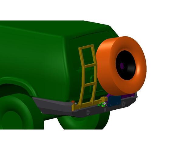

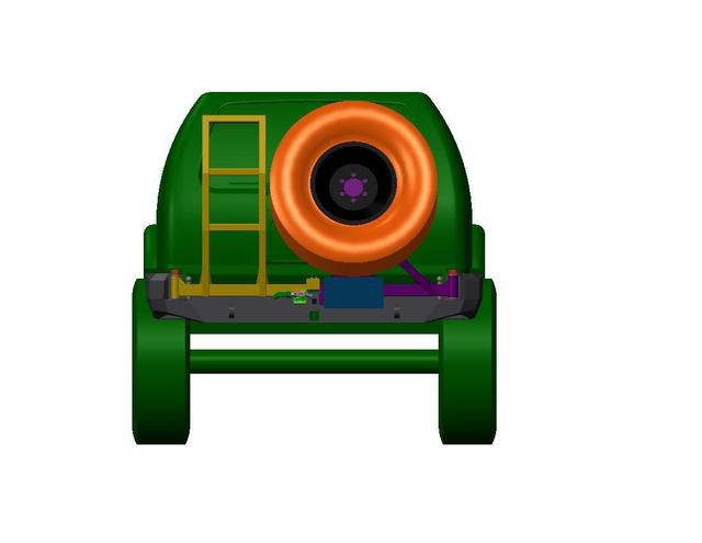

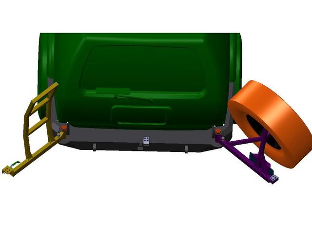

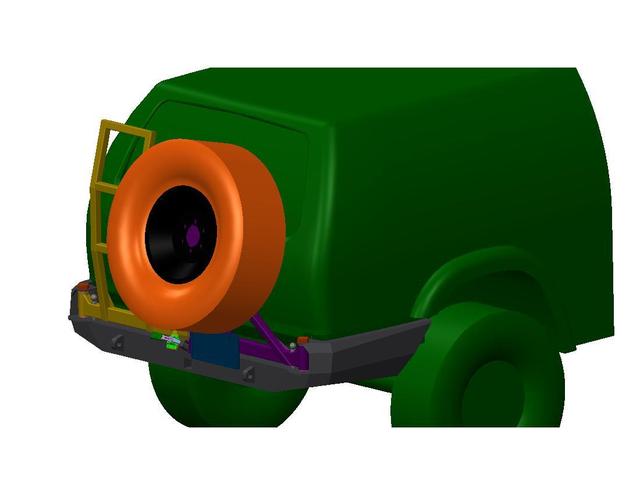

Dual Swing-Out Design Pics:
Back View:

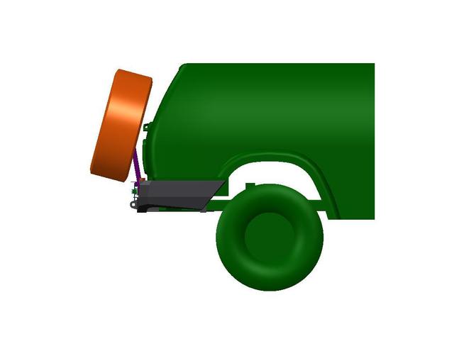

Side View:

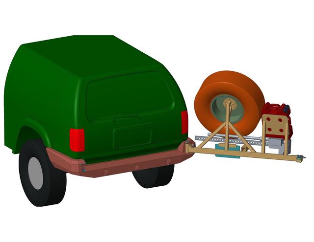

Open:

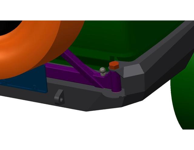

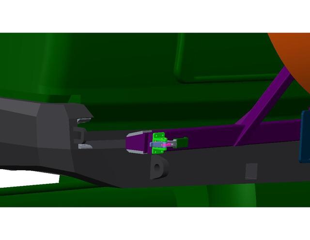

Hinge:

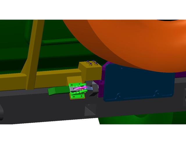

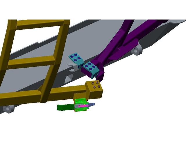

Latch:
Sliding Blocks:
I have a ladder on the driver side, but it can be replaced with jerry can holders, etc.
Features:
- The swing-out arms (2.5 x 1.5 x .1875 thick wall rectangular tubing) both open 135 degrees.
- I used plastic blocks to provide a ramp lead-in when closing the arms.
- The plastic blocks also eliminate any metal to metal sliding contact (should be smooth and quiet).
- The hinges are 1.25 inch diameter grade 8 bolts with 2 bronze bushings each in double sheer. (larger than aftermarket versions)
- The swing arms are located up above the bumper as opposed to behind it, offering more protection of the arms, hinges and latch.
- Location for license plate mounting.
- 35 inch spare tire.
- I tried to hide as much hardware (bolts, nuts, etc) as I could for aesthetics.
- The latch is a compression latch, like what is used on some aftermarket swing-outs.
- The latch is set at an angle to clamp both arms in two directions (both down and back).
All aftermarket versions have the latch clamping the swing arm either straight downward, or straight back against the bumper. But this allows a degree of freedom of movement. My design clamps in both directions. Think of it as clamping or wedging the arms tightly into a corner, where there is no movement allowed in any direction. I believe this will eliminate any vibration issues also.
The downside of the dual swing-outs is that I had to add features to clamp the arms up against in the center of the bumper. With the plastic sliding blocks, this got a little bulky in the latching area. I'm currently working on a single swing arm design based on this design also. I think the single arm design will end up much cleaner looking.

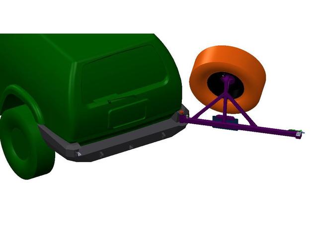

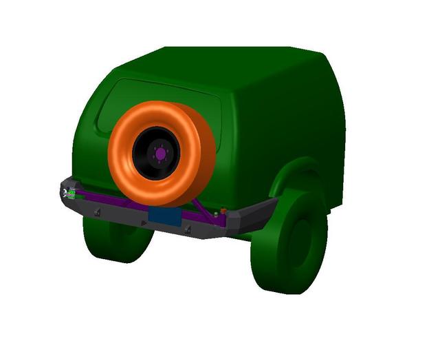

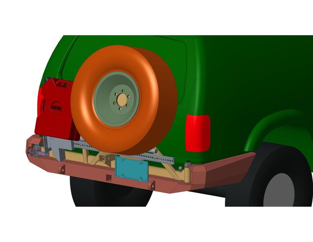

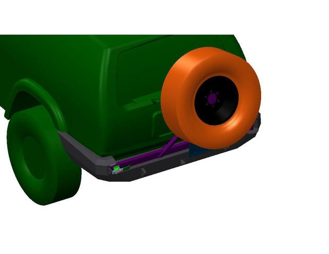

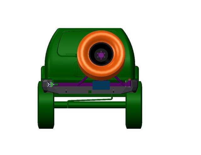

Here are a few pics of the single swing-out design:
