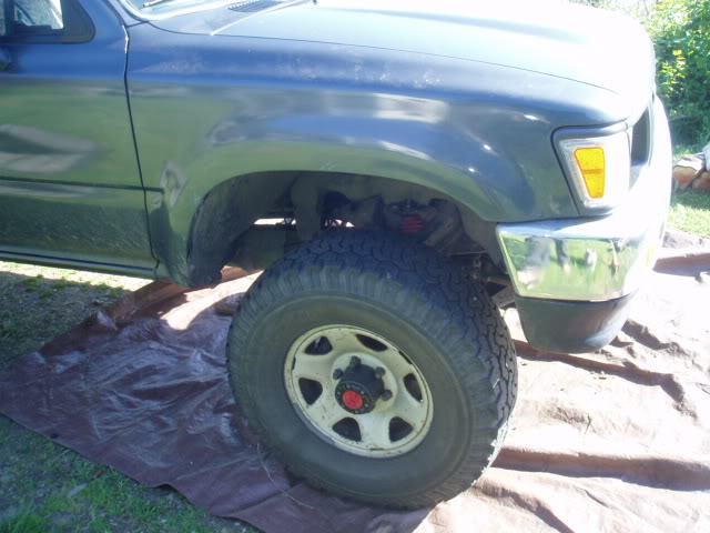

Here are some pictures of the lift.
this is the stock height

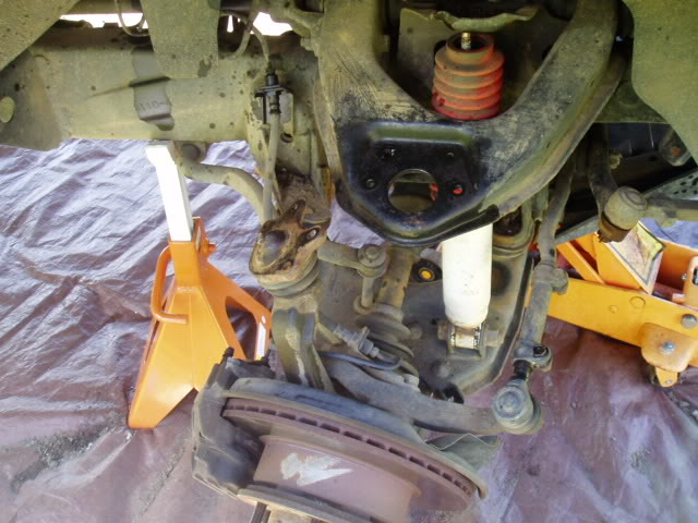

BJ off and ready for the 2" spacer

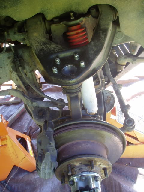

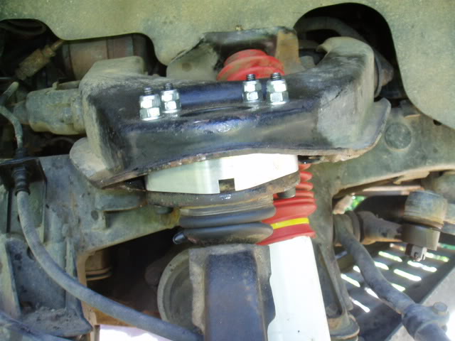

Toytec spacer in and torqued down to spec.

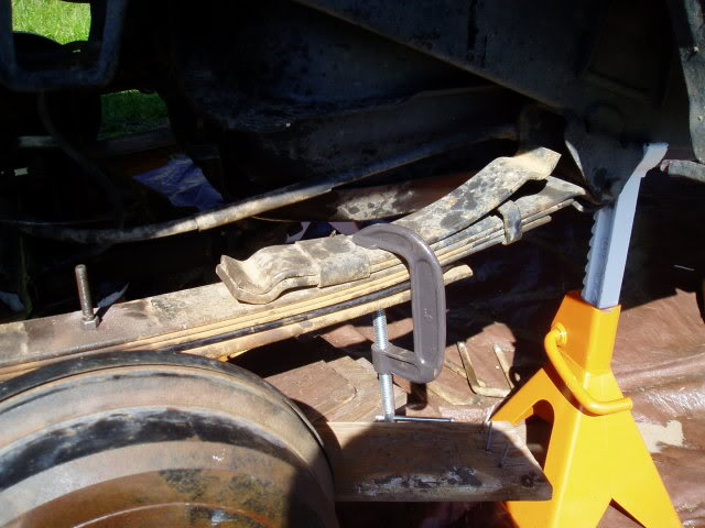

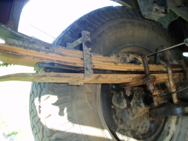

Rear leafs with the 2" add a leaf

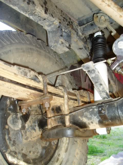

Rear leaf in with new Pro Comp shock.
after install

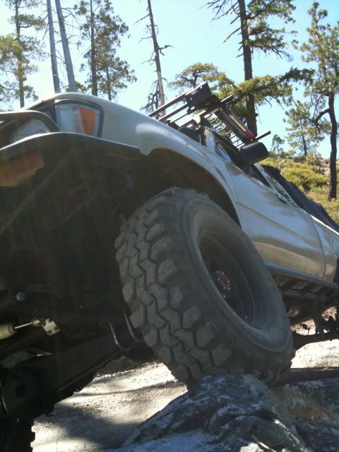

and as she sits today (in the process of a SOLID AXLE SWAP)

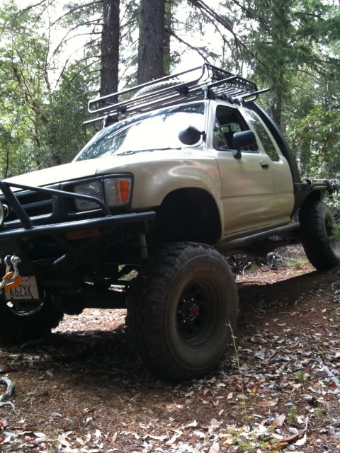

I suppose I better post an update pic..
IFS and Toytec lift ship has sailed.
as of a few days ago..

Toyospearo -
What color of paint did you use to change the color of your rig? I'm thinking of repainting mine to a "desert" color like yours. Kind of a muted gray or beige color. I think it looks very nice. Of course, I'll be doing a rattle-can paint job though...
